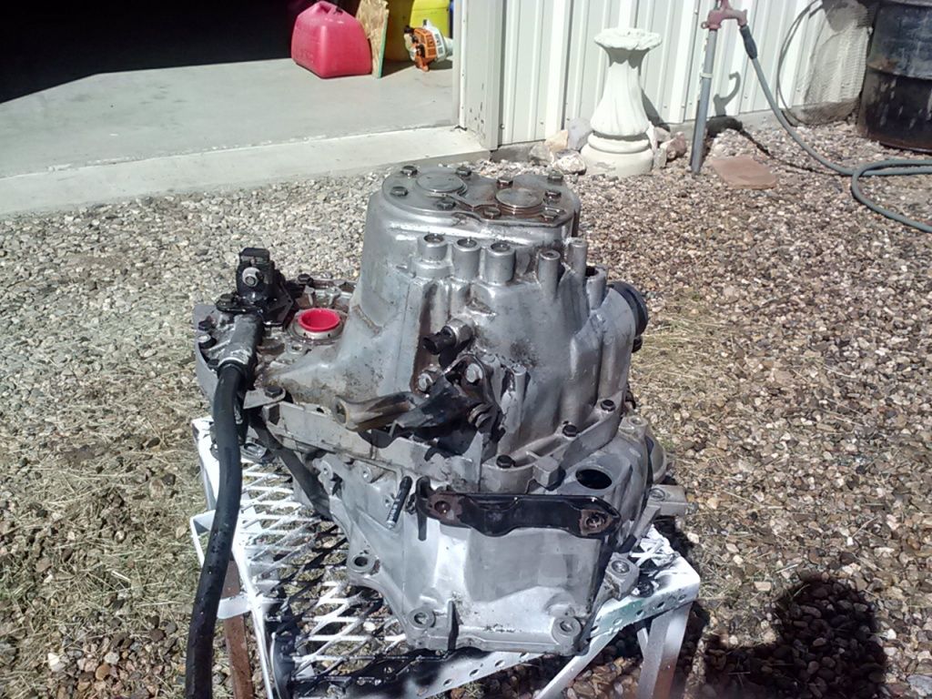

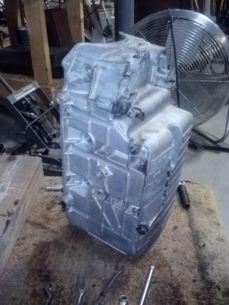

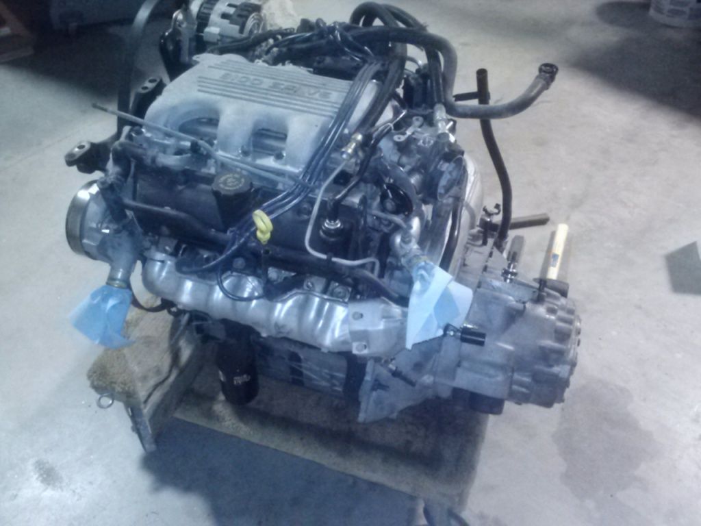

Spent a good chunk of time getting the trans cleaned up too. It was a lot of work, and im pretty sure, that it had never had a bath in its life. I hit it the first time with Greased Lightning and let it soak, then hit it with the power washer. Then, hit it more with degreaser and power washing. Prolly spent a good 2hrs on it, if not a little longer.
This is after 2 hours of scrubbing and washing
Then, after another hour or so, this is where i stopped. Still needs some work, and its looking like Purple Power is my next weapon of choice. Its way stronger and works better i think.
Compared to it being solid black when it got it, i would say its really starting to look like a transmission. Also got the inspection cover cleaned too, it was solid brown. Yuck!
And before anyone asks, that dipstick tube is the one i saved from my 94 GASE that had a Quad OHC in it. Not 100% sure its gonna be a direct bolt in, but it originally came from a 92 GTZ Quad, and it worked great on the OHC motor, just hoping i can make it work on this setup. I dont like running a funnel all the way to the bottom on these trans to add/check fluid.

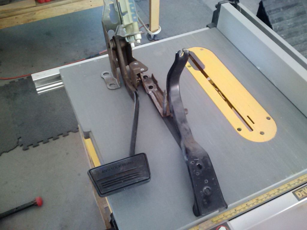

The donor pedals had surface rust all over the mounting bracket, so had to clean them up and paint them up, didnt want rusty parts under my dash.

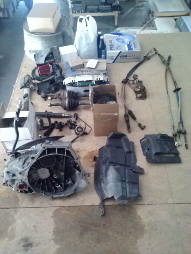

An overall again of everything of whats waiting to go in. Cant wait to get it installed

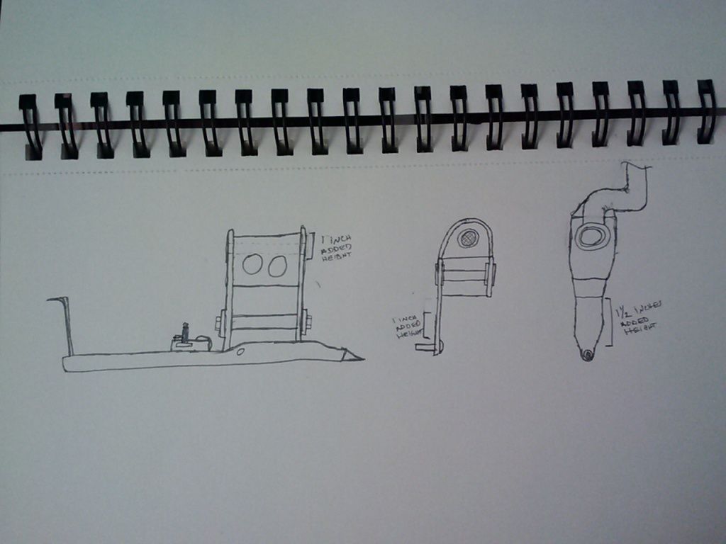

And, here i go again designing stuff for the car...

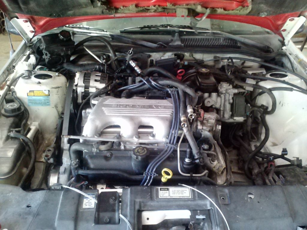

And so it begins. Stay tuned, its time to set a record...

I was atempting to set a record and get the old out and put the new in in the same day. It turned out, i was a little expectant of the over-achiever in me. I got the old setup out, but did not make it far enough to get it all back in with the new setup. I will have pics up tomorrow.

Okay, to get everyone caught up on whats been going on, heres the pics of where im up to. From Monday.

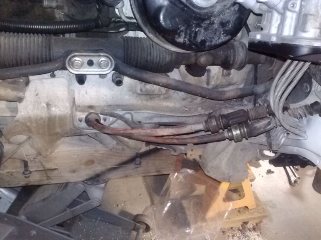

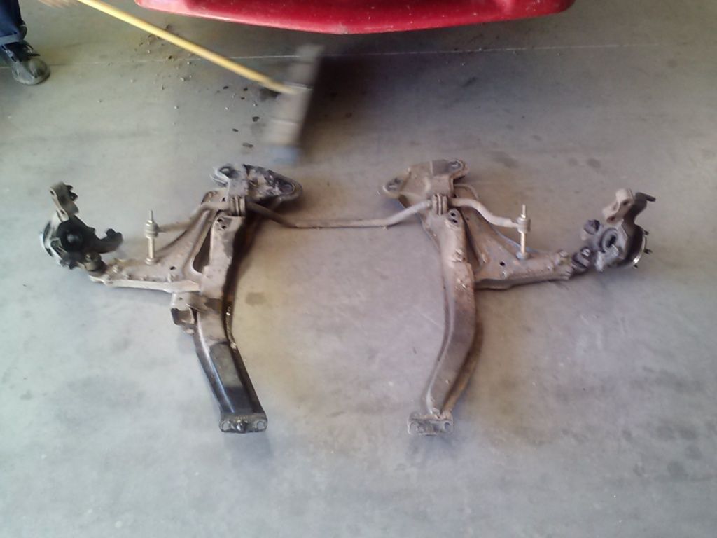

Cradle out and making room for the drop out.
Detached and sitting on the ATV jack i pulled it out with.
Lifted the car under the firewall and pulled everthing out the passenger wheel well. ONly took me about 3 hours to get it all out.

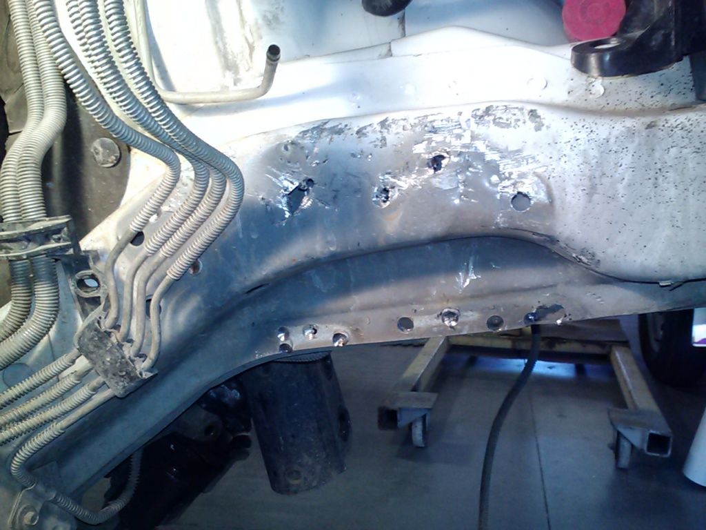

The torque strut mounting hole redrilled and cleaned up

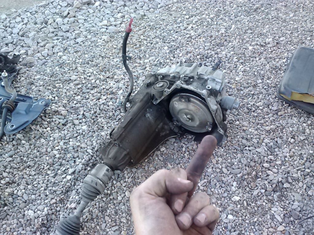

Next, separated the engine and trans and dumped that bitch outside lol

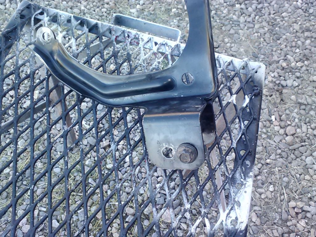

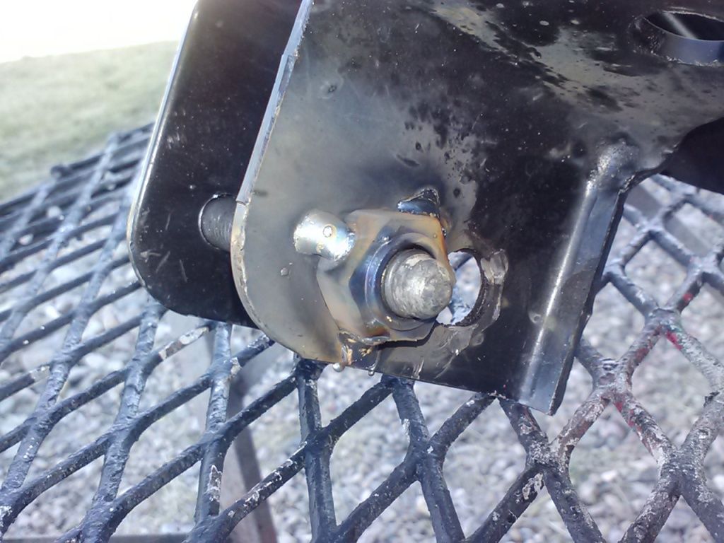

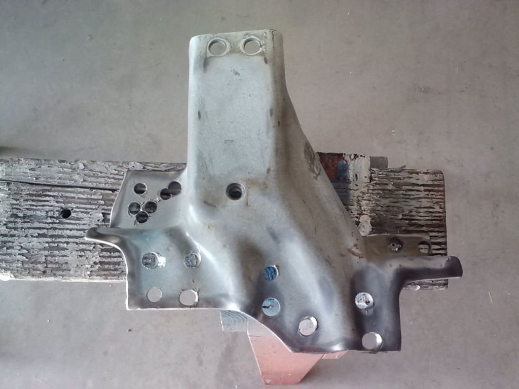

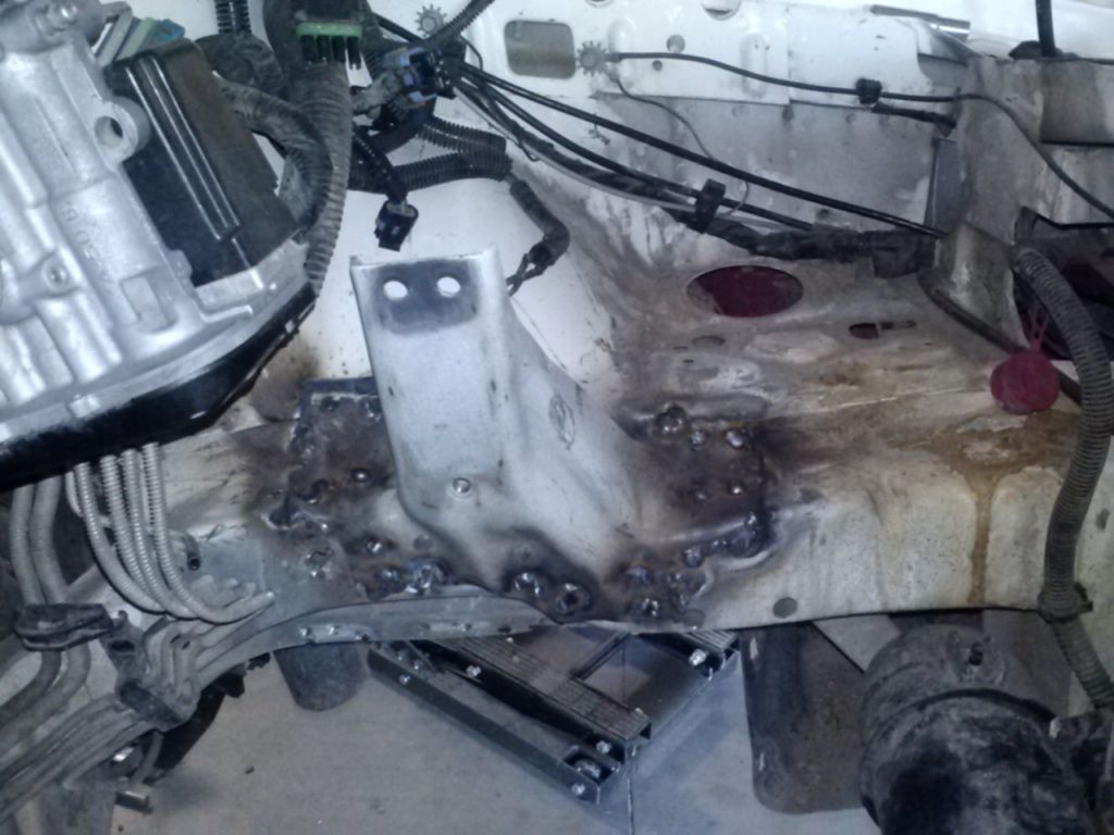

Next, went on and got the donor trans frame mount measured, marked and installed. Welds are not pretty, but they wont go anywhere.
Cleaned it off after i was done welding and painted it before the surface rust started.
Still not super happy with some of the welds, but eh, you wont even see much of it, if any of them. I called it quits there for Monday and came back Tuesday night and did some more work.

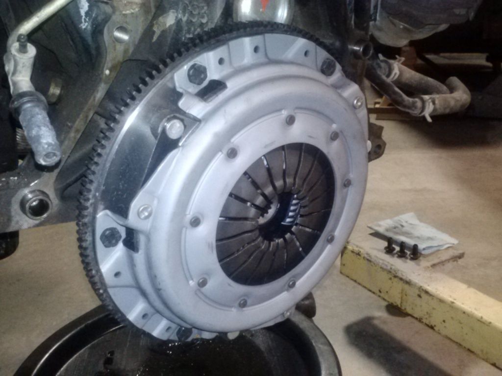

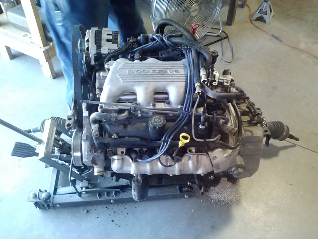

Had a short night and took the next night off to get some rest, was back at it again last night. Had to order some new pressure plate bolts which i got from GM, but atleast they are new.

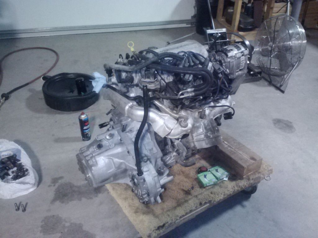

I went to town on the oil pan right after switching the bolts out on the pressure plate, getting it cleaned up as it was solid black, yuck! Didnt clean it 100%, but its WAY better looking now!

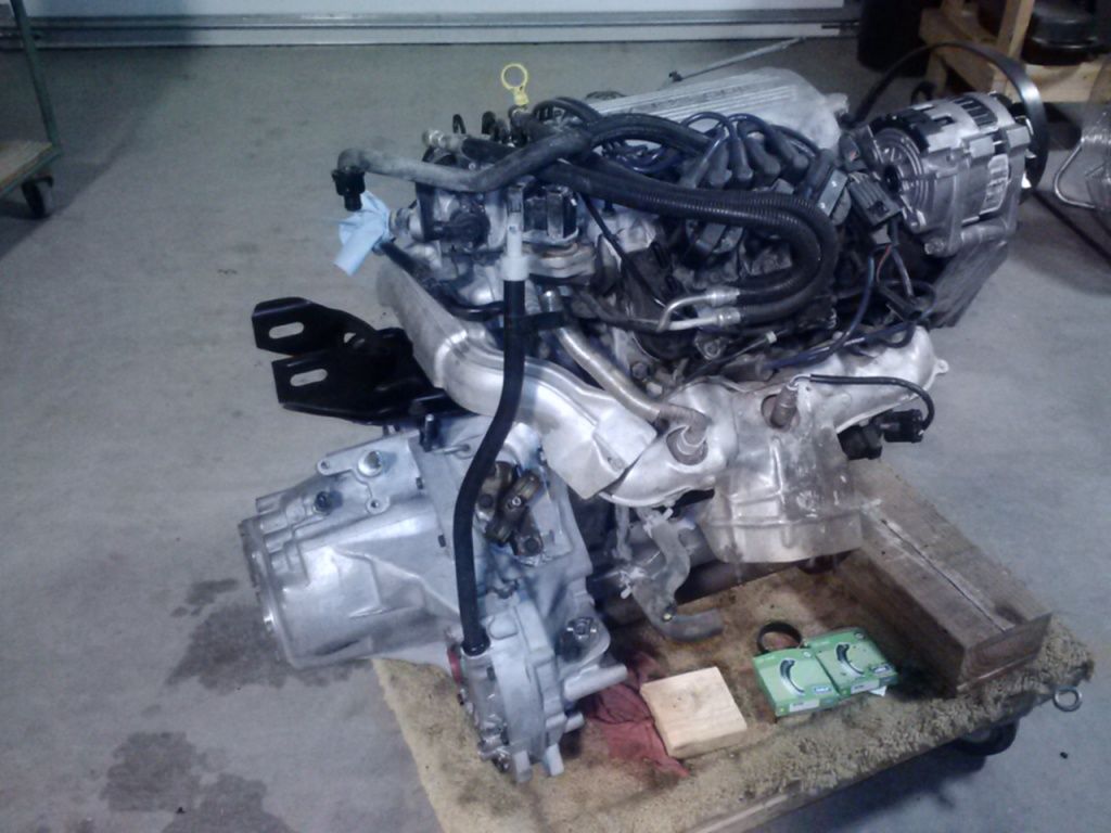

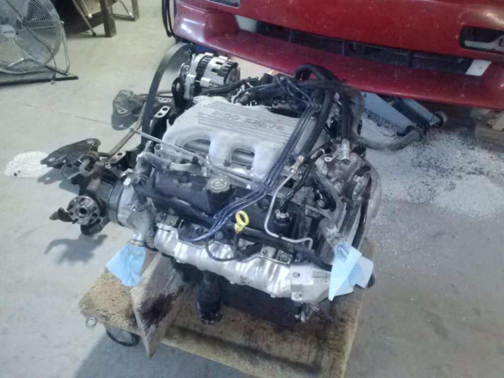

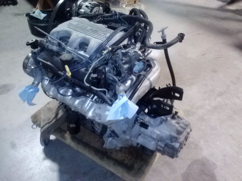

Went on from there and proceeded to let the trans meet the motor for the first time. Match made in heaven

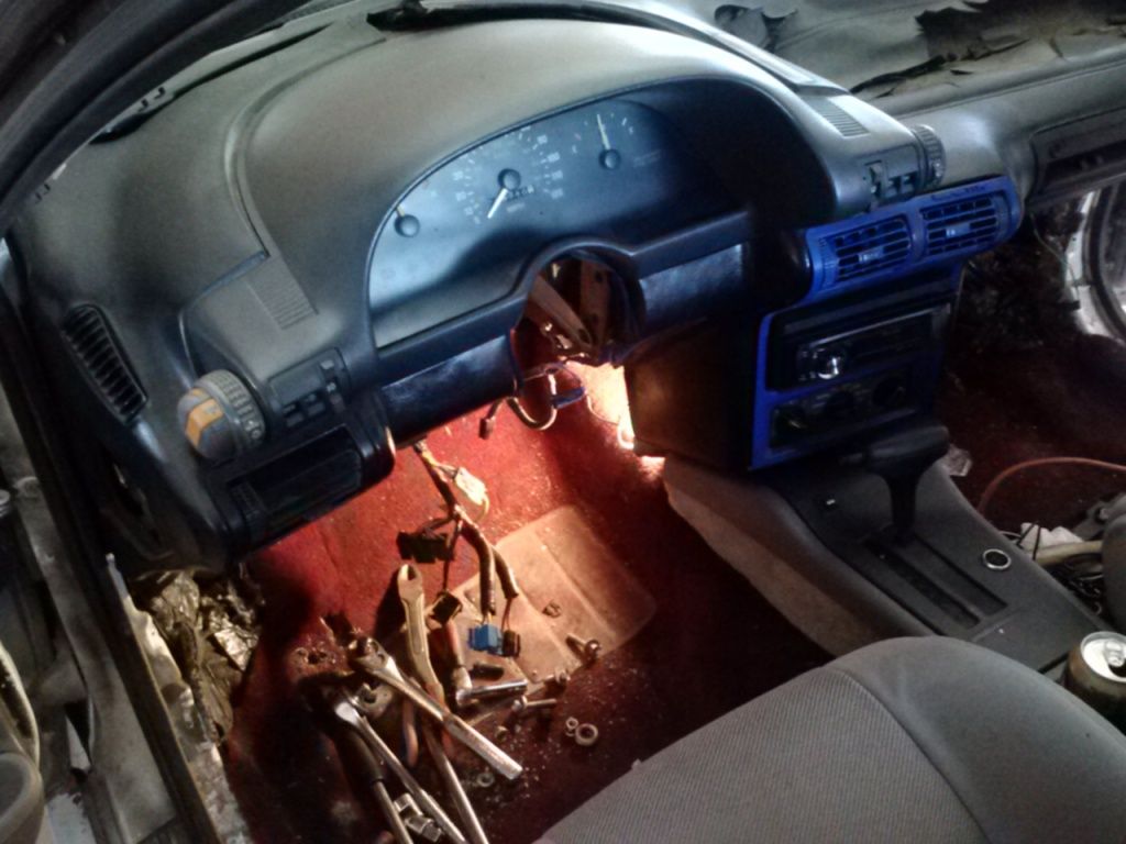

After all that, i started bouncing around as i was getting more and more tired, but wanted to make as much progress as i could.

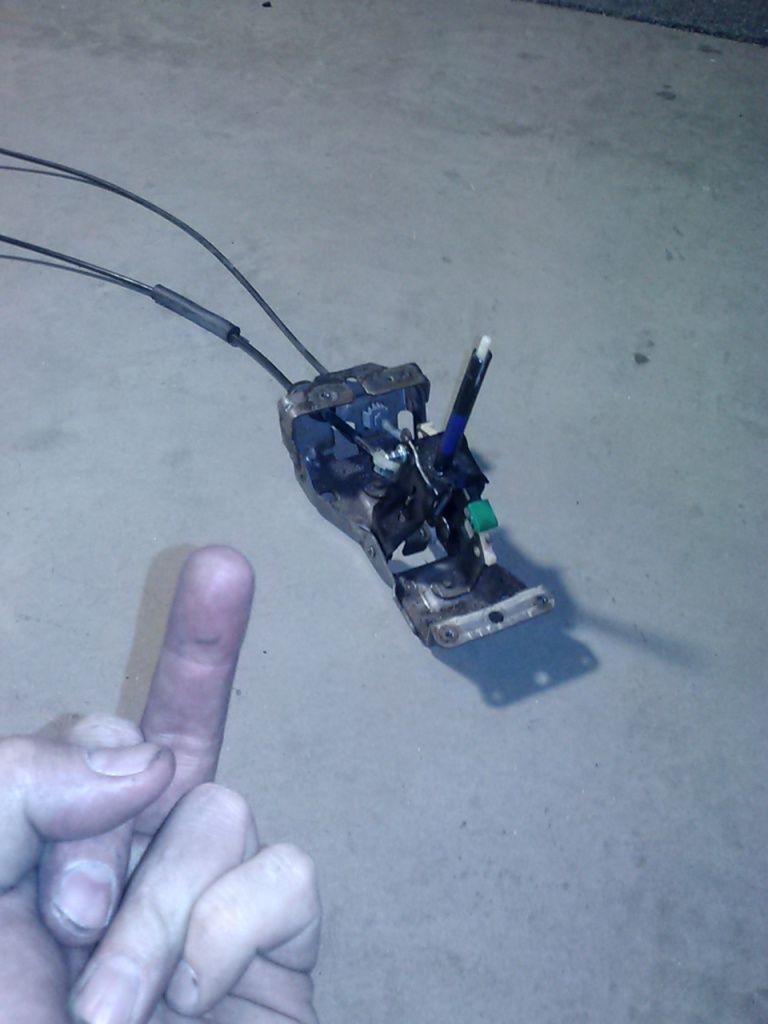

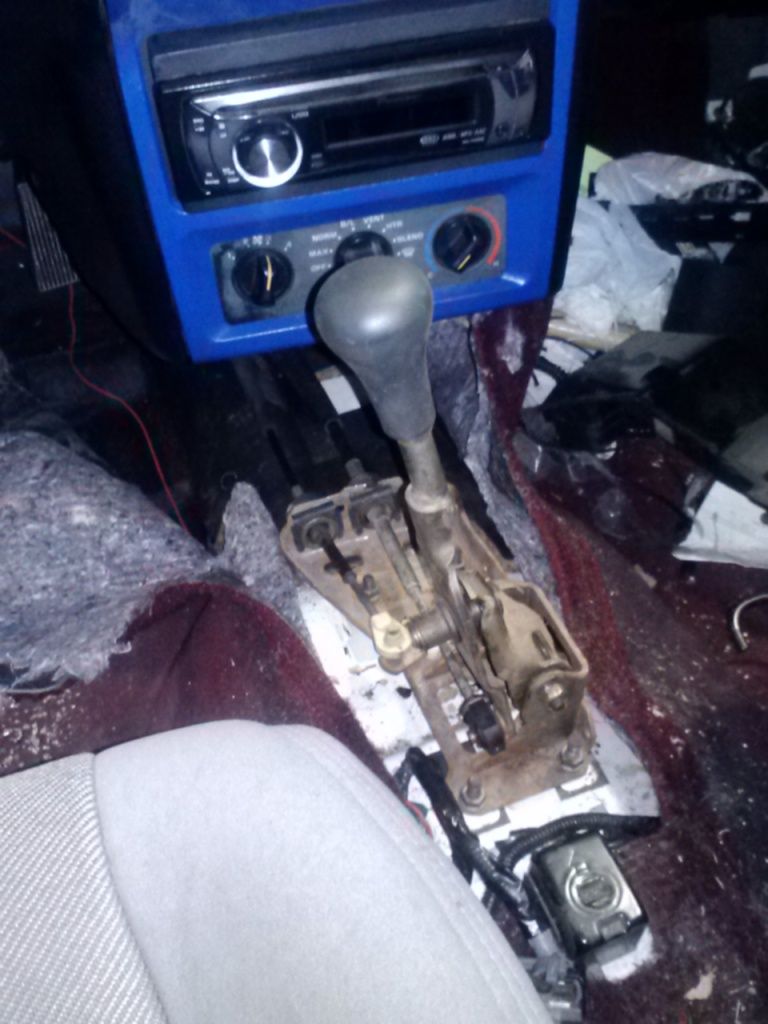

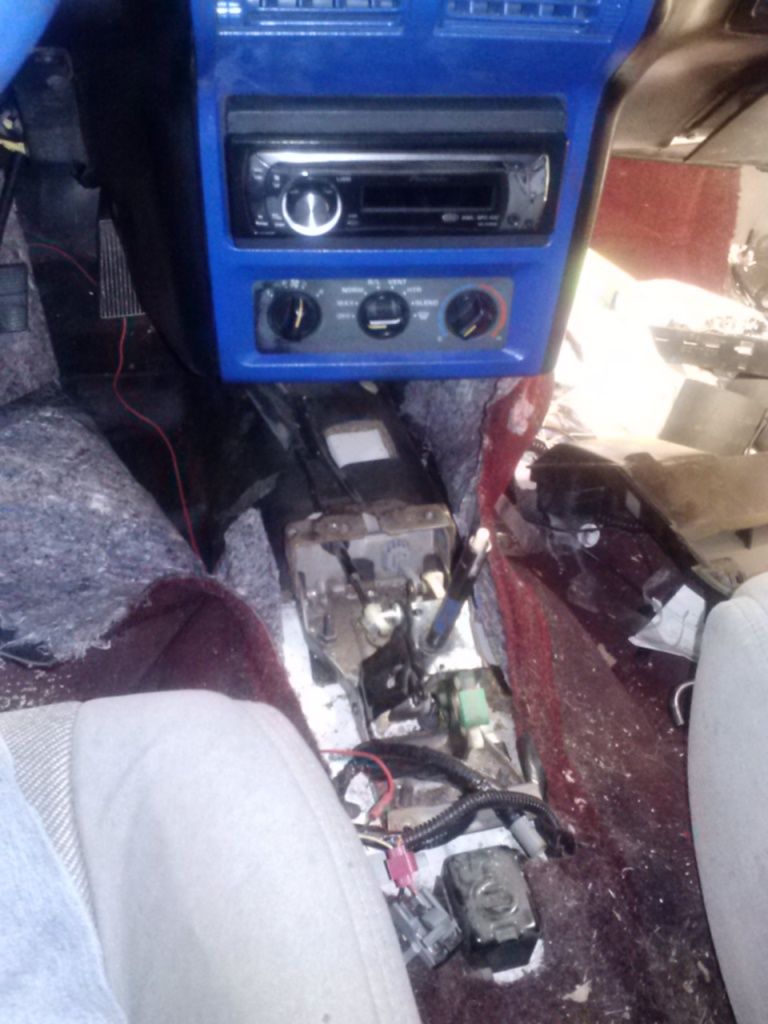

Pulled the console, split the carpet (replacing it down the road with new black or charcoal carpet) and removed the lower ducting, then unbolted the auto shifter assembly.
GTFO!! LOL
Bounced back to the motor and trans and installed a few things here and there. Not pictured is the jackshaft installed, which, i dont remember seeing anywhere that if you use the J-body open shaft, you have to do a little bit of grinding...oh well, no worries.
Next, landed back in the car and proceeded to install the cables (that took too long) and the manual shifter. Took longer than i wanted, but got em done.

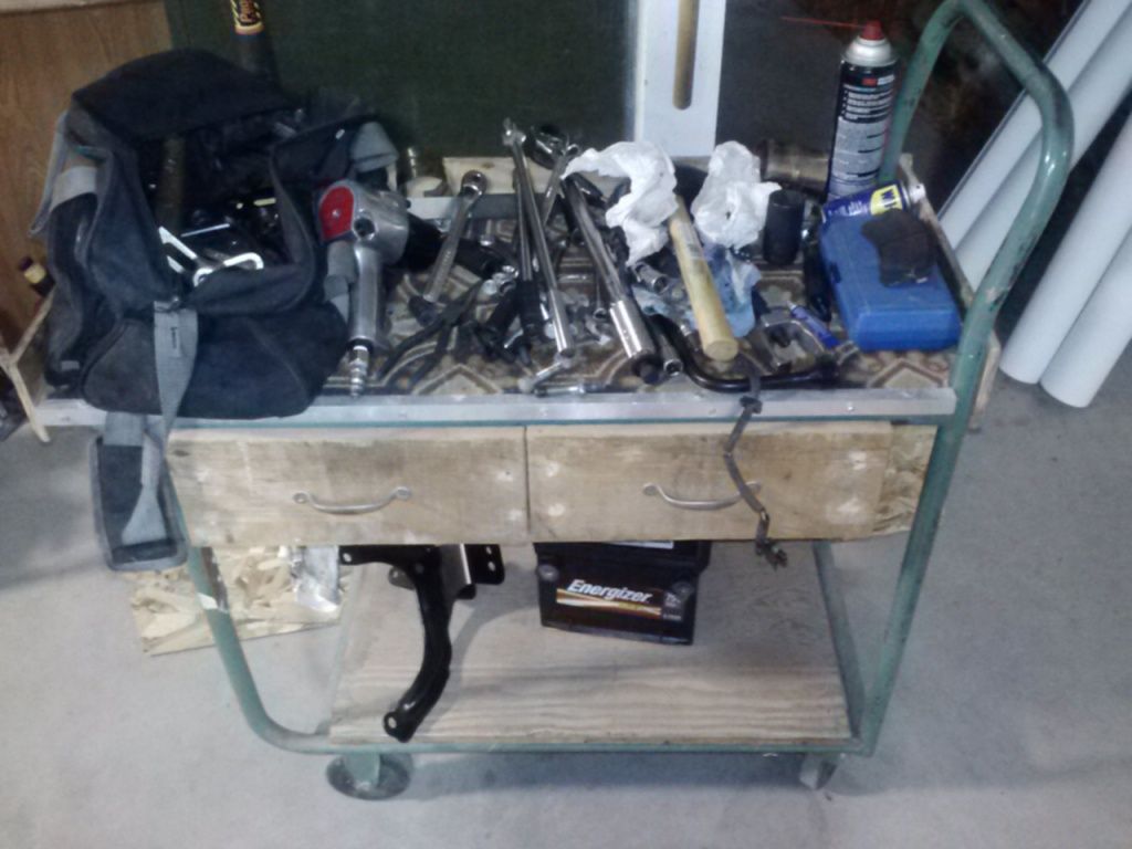

The carts of parts and tools lol

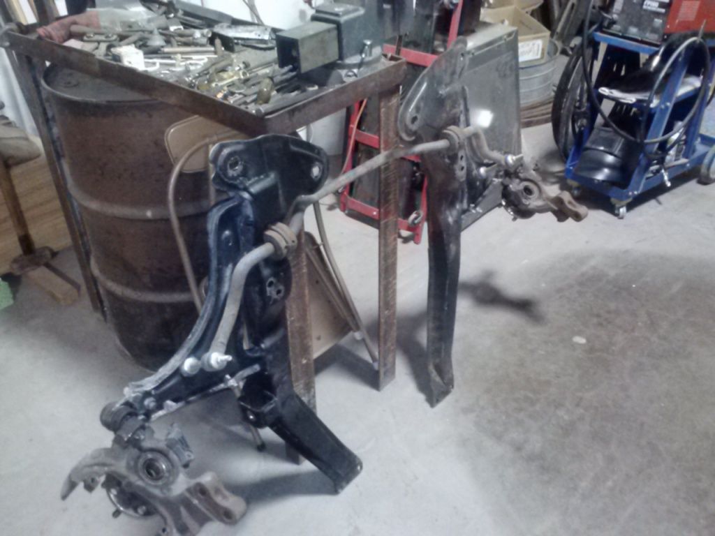

Got the subframe cleaned up some too
Finished the night out last night yanking the wiper motor to replace it with one from the donor 96 so i can have delay wipers. And a pic of the awaiting clutch master mounting.
GTFO!! LOL
