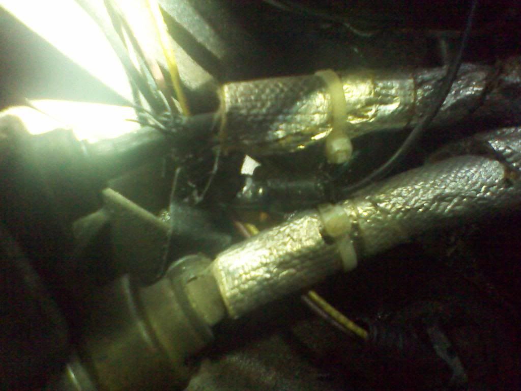

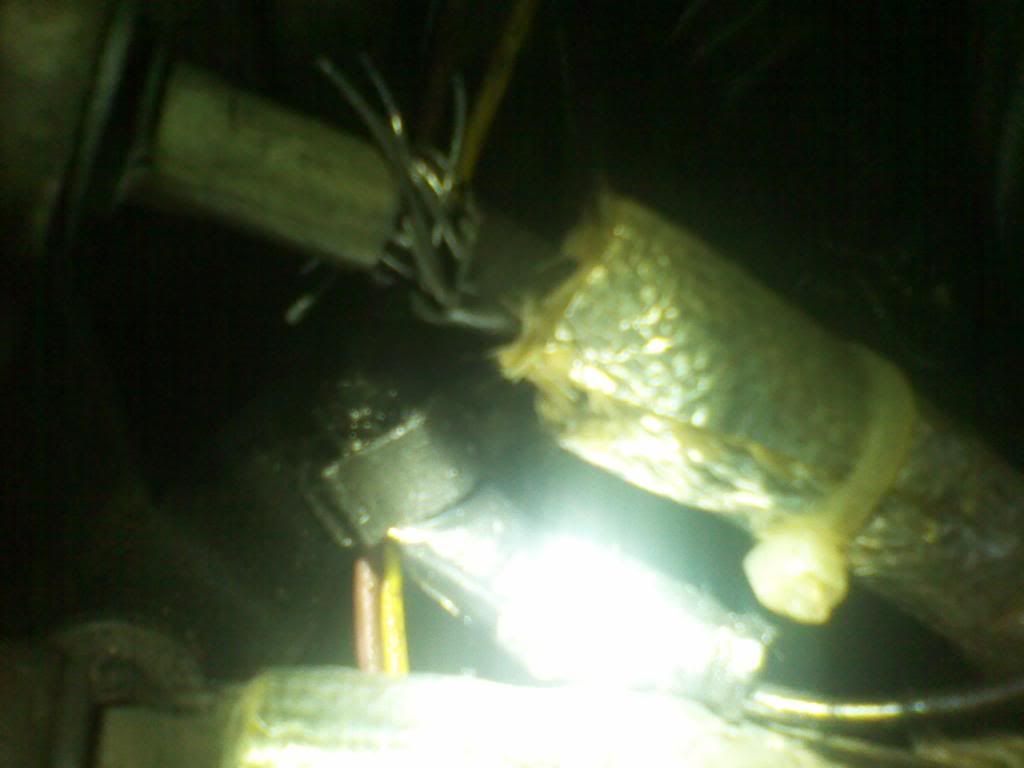

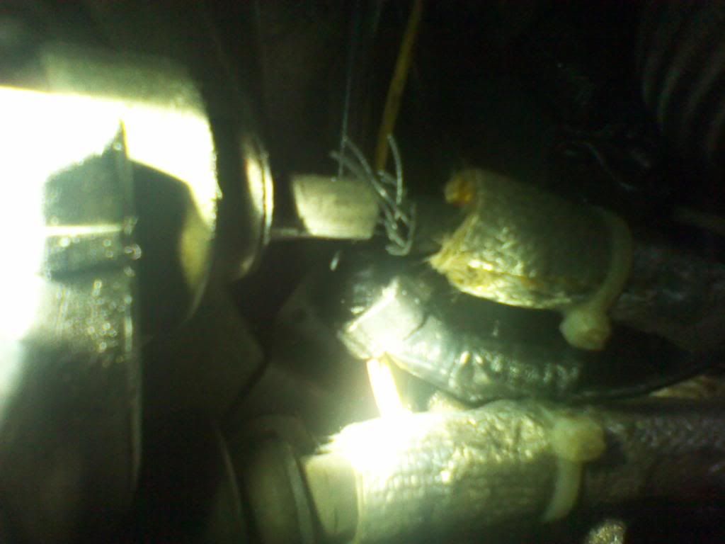

finally had a chance to look at her and I found this
Re: No 5th gear or reverse!
Yep. Broken cable. Though it looks like the outer housing is damaged, more than the inner, but then I have no real clue, never really had one of these to drive and work on, outside of the POS 94 base 2.2 with the Isuzu. As noted in the thread, there are members with some to sell.

Unfortunatly that is a break that you cant really avoid with any other stock beretta cables. They are aluminum collars crimped to a steel cable housing. I wanted to weld mine but obviuosly couldnt. I broke a cable the same way.
You can modify and use cables from almost any other fwd car. I started to build a sick shifter setup with a civic shifter, h22 cables, ball bearing ends, etc. But lost interest in fwd all together.
Can you fabricate? Almost every import shifter out there is better than our shifters and other GM crap.
