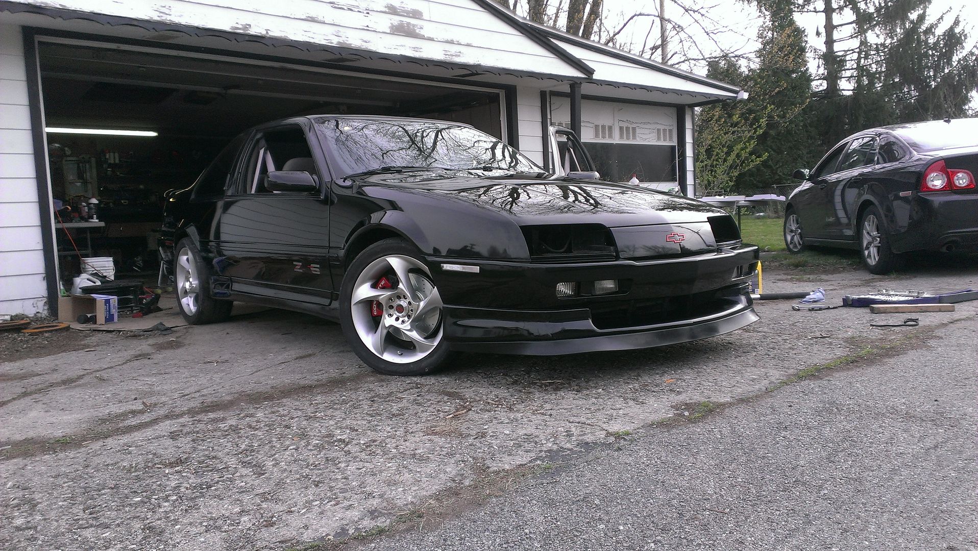

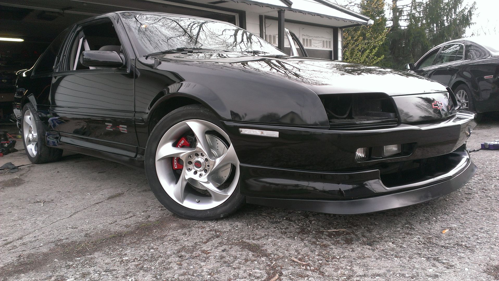

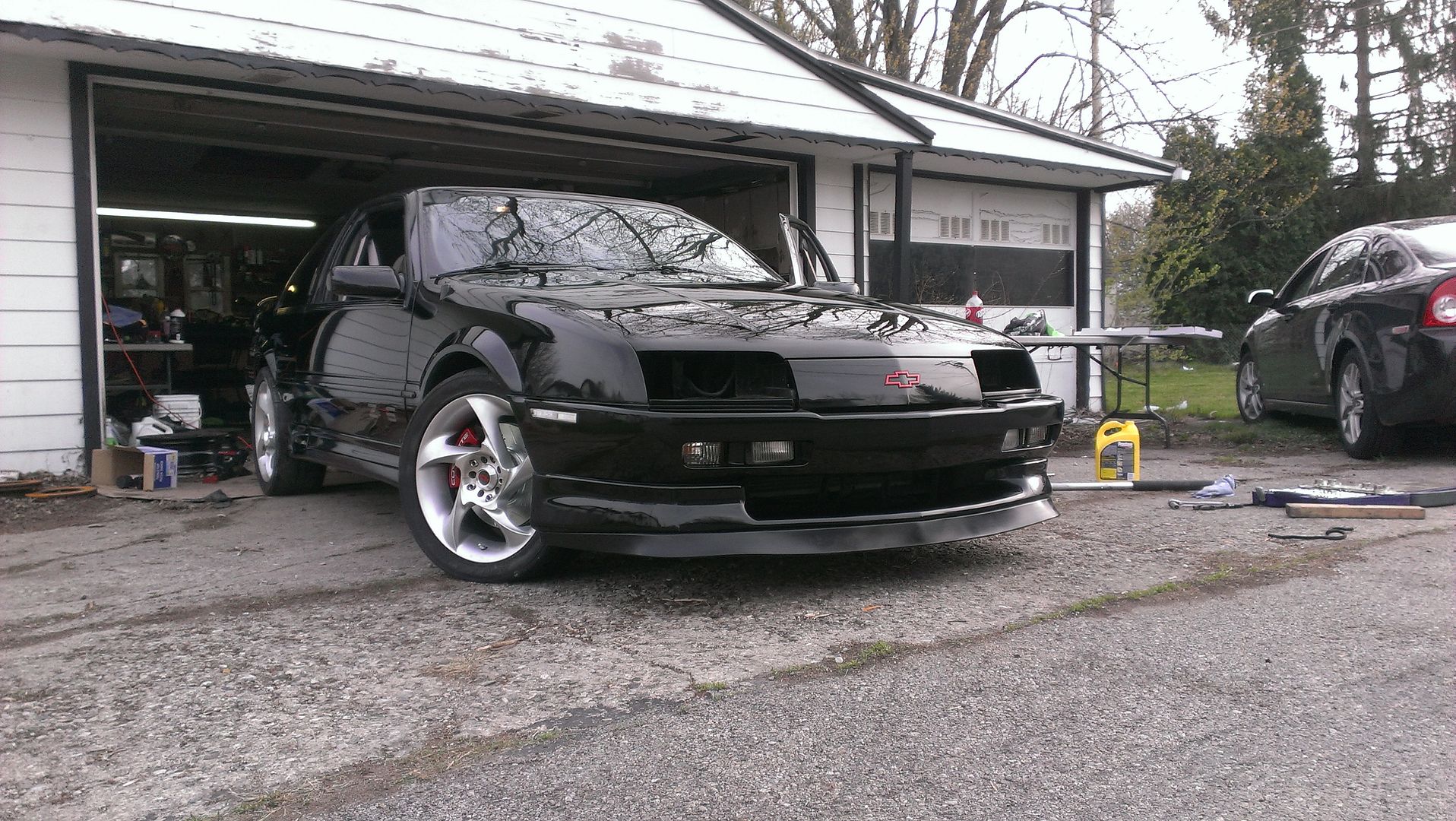

Here is my favorite part.. the car back on its wheels. I seriously like that I can do what I really want with the car now the the Quad is gone and I dont have to worry about what I am doing to a rare car..
It was a long day by the time I got to this point.. I really wish I would have taken the 5 minutes and put my headlights back in but ah well.
I missed a few important parts that I will post later.. one is how we re-enforced the upper radiator support for the mount and all that. Ask any questions about the swap and I will answer them. It runs and drives at the moment and is going to the exhaust shop on Friday. I have videos of it running will post later also.

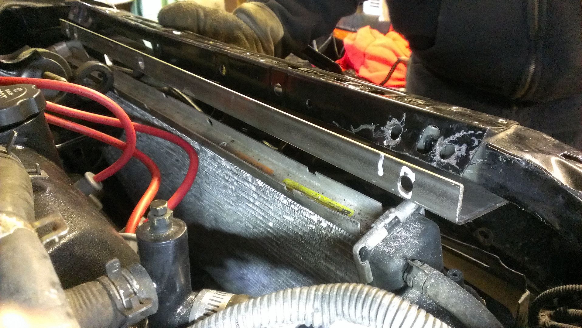

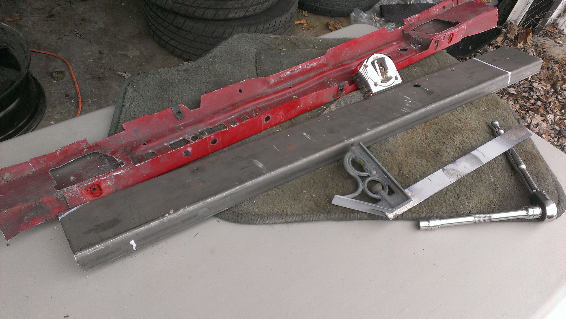

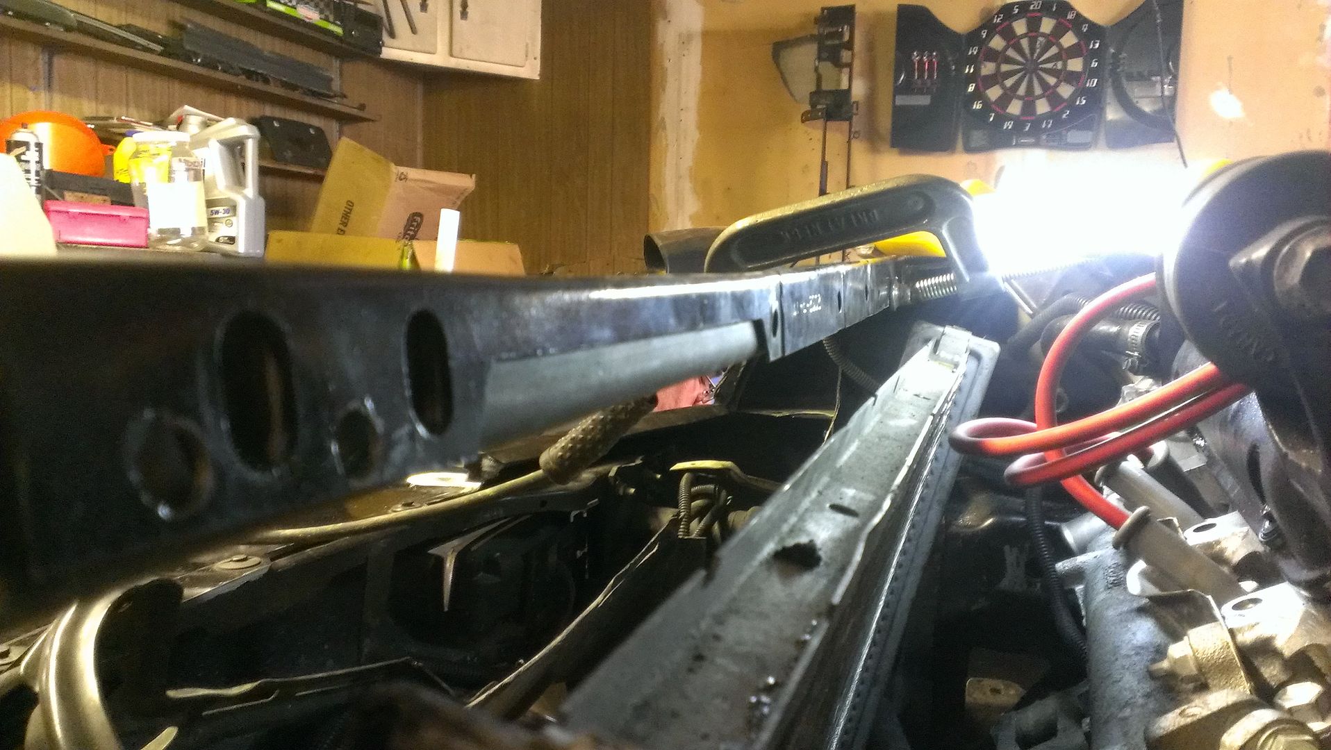

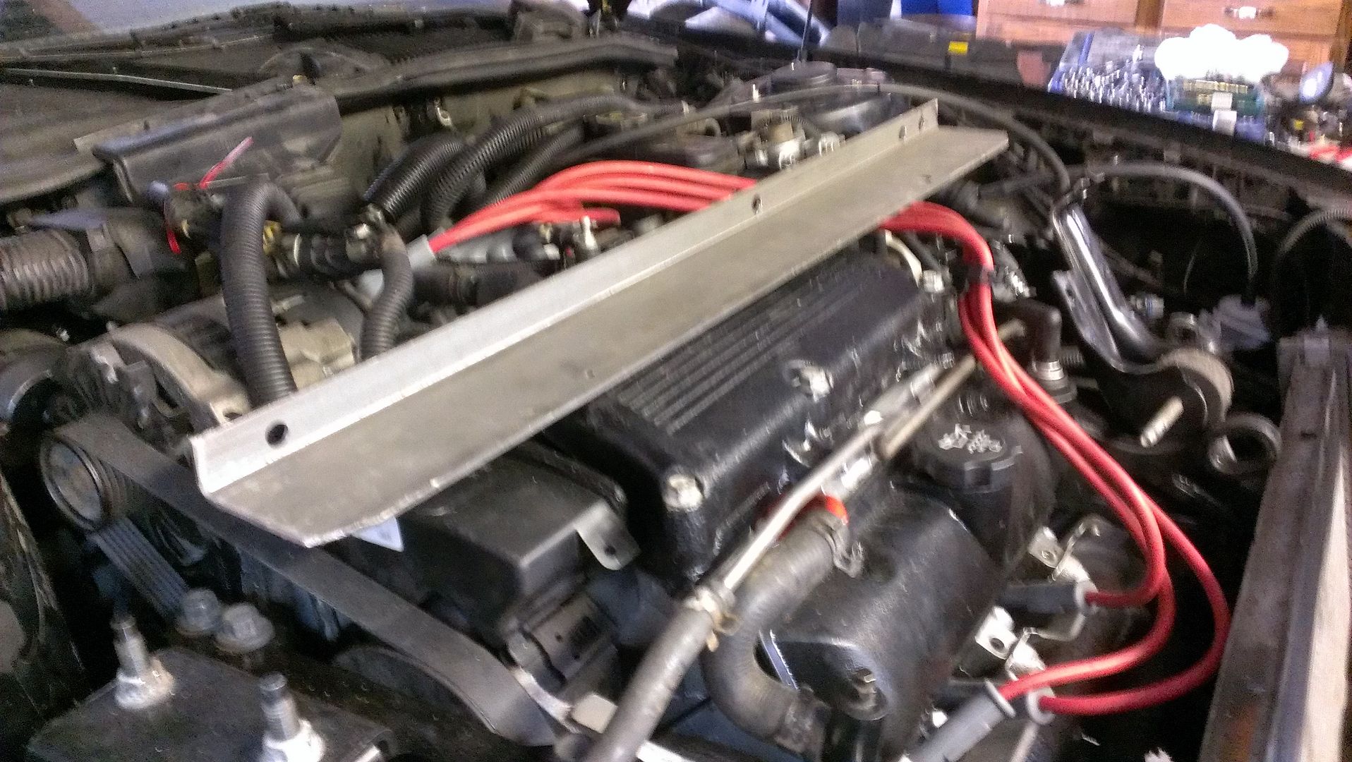

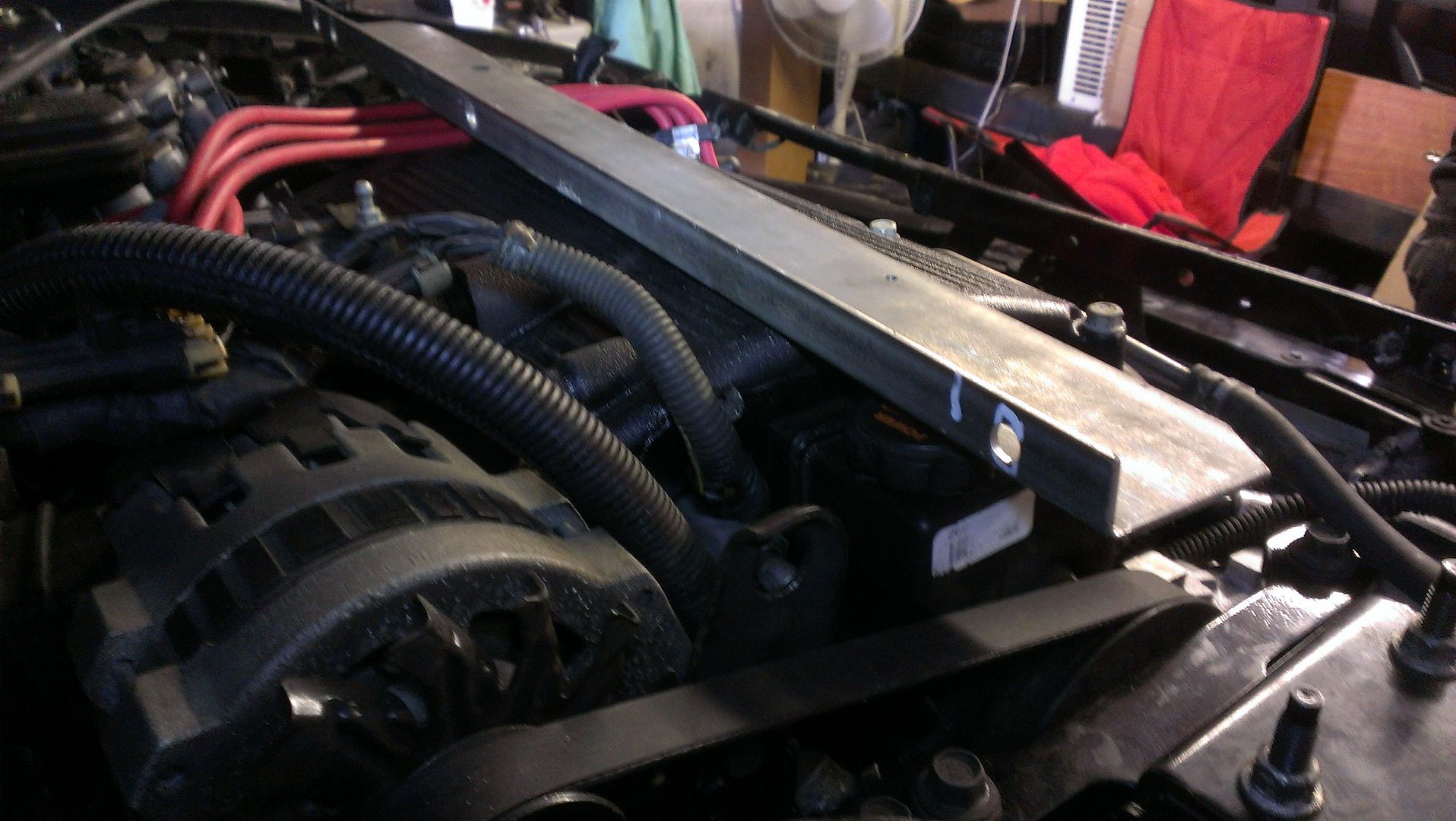

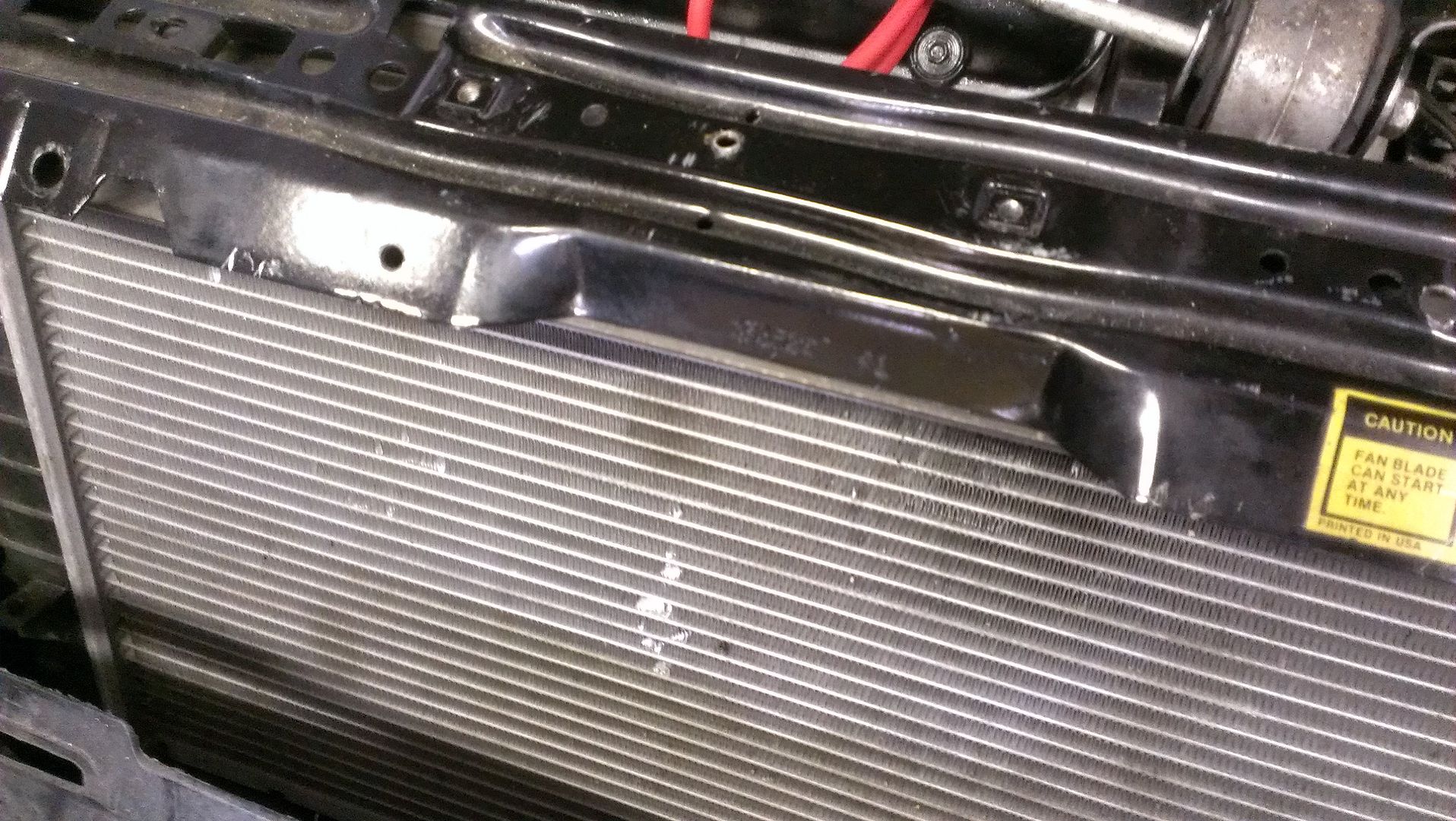

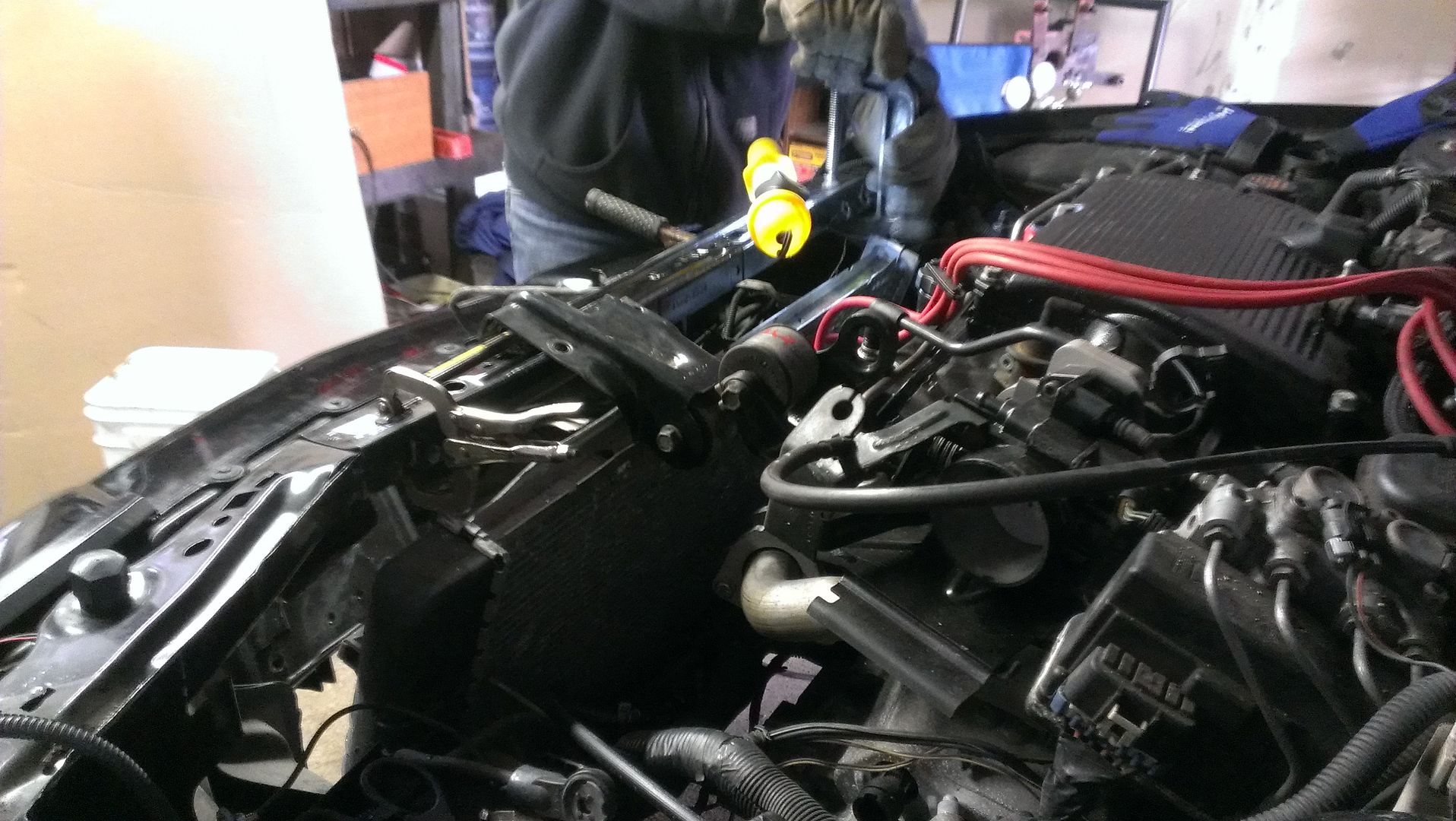

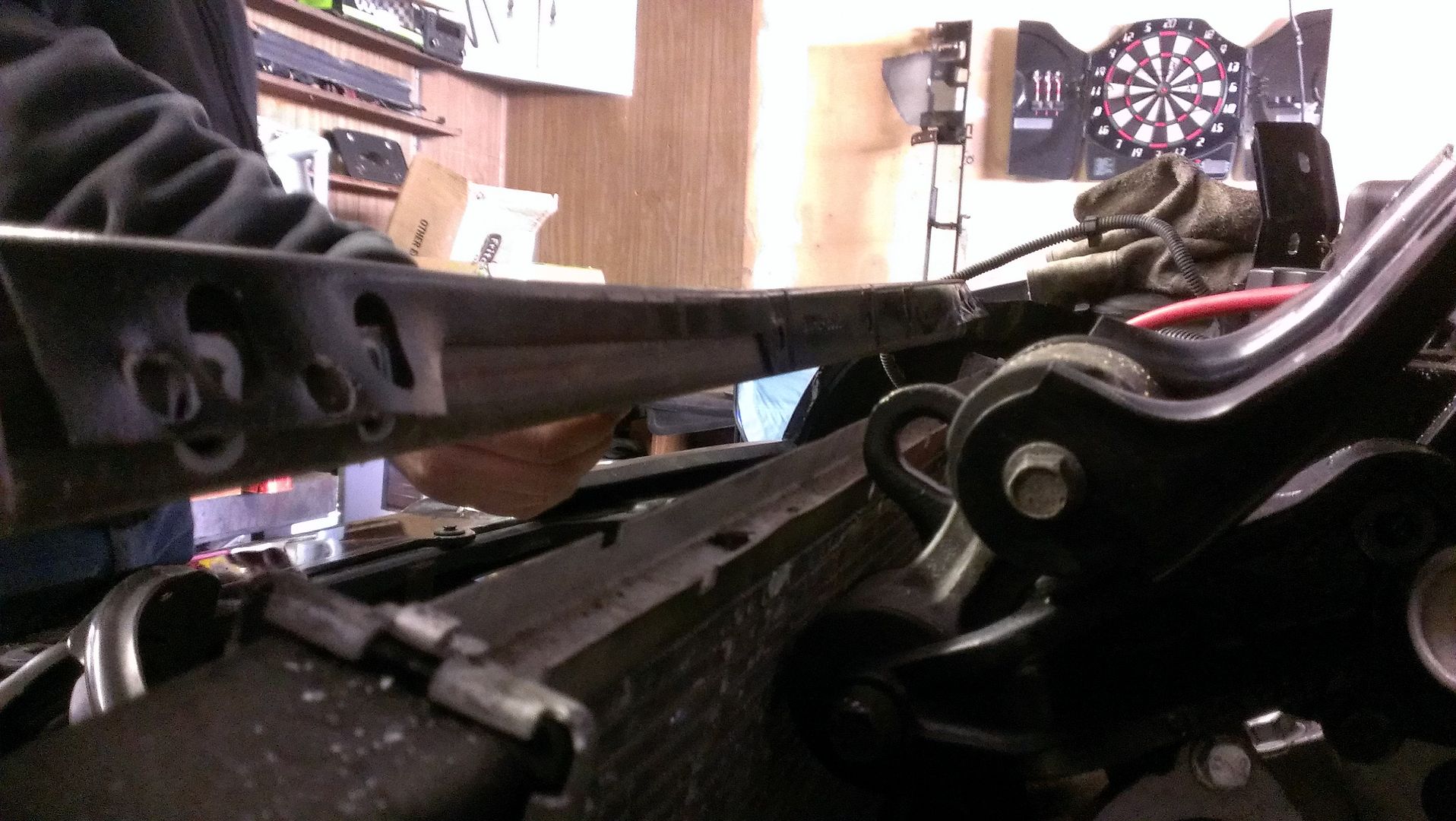

Here are the pics from strengthening the upper radiator support.. Charles Larcom did an awesome job helping me out with this part of the project.
Used a upper radiator support I cut out from a 96 base at the junkyard for reference..
Then got the part ready to go..
Split the spot welds
Fit in and welded
Then I dont have anymore pics from that lol It works perfectly though to keep the radiator support sturdy.

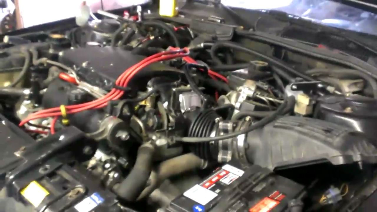

Here is the video right after we got it running.. sounds mean as hell!!!!
Then driving it real quick
edit- per request, I have removed the video.
If the videos dont work let me know I will try posting them a different way

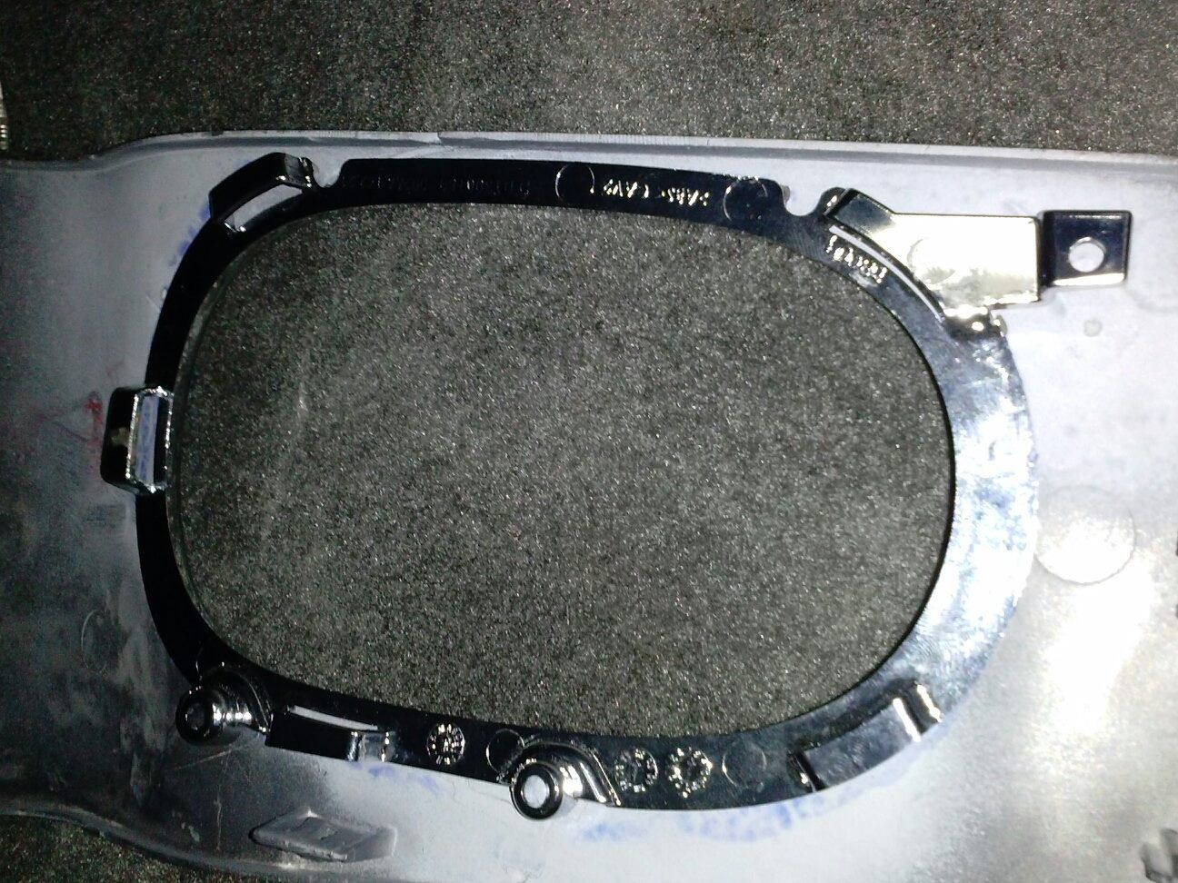

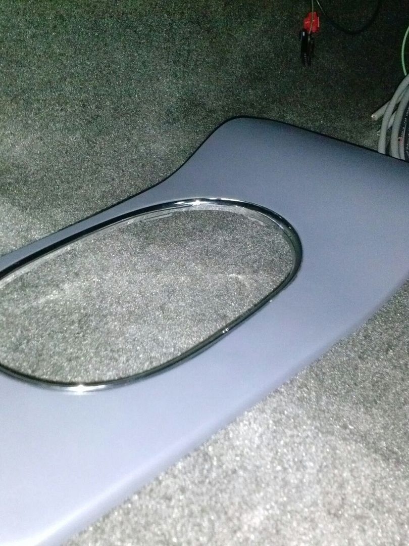

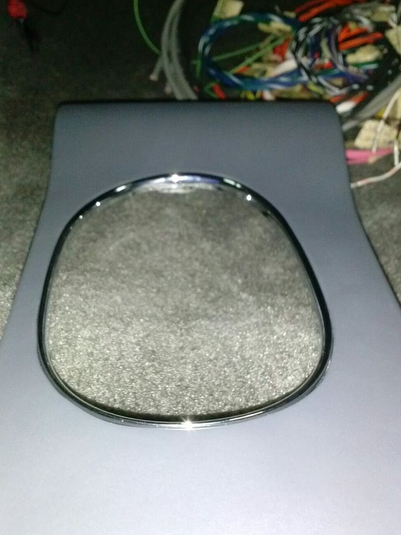

Here is the shift plate Charles knocked out for me, the Corvette center console trim piece fits perfect!!
I am going to get that covered in Carbon Fiber.. then cut and modify the G6 shift lever to fit the ZR1 shift knob so the boot, knob and trim piece will all be like factory Corvette. Also going to put my headunit back in and get some other pieces done in CF at the same time. Cant wait to get the ZR1 knob on though!!

Is that on stock tune?
Re: The trip into the "big leagues"update pg 12! 6spd swap d
That is a tune I flashed to the ECU with 3500 tables in it, with the running video's he's posting I'm almost embarrassed to say I flashed that ecu... They keep posting videos of it running with no o2 sensor in the exhaust and I don't even know if it's hooked up, so the car is in limp mode needless to say and that's why it's running like garbage... I guess the tune is only as good as the install and right now it's not complete and shouldn't be running.

3X00-Modified wrote:That is a tune I flashed to the ECU with 3500 tables in it, with the running video's he's posting I'm almost embarrassed to say I flashed that ecu... They keep posting videos of it running with no o2 sensor in the exhaust and I don't even know if it's hooked up, so the car is in limp mode needless to say and that's why it's running like garbage... I guess the tune is only as good as the install and right now it's not complete and shouldn't be running.
Jon what is the big deal? The car has been under knife for a LONG time.. I just wanted a video of it moving on its own..
The O2 sensor was in for the running video but wasnt for the driving video.. Since its a manual there is NO WAY of fitting the O2 sensor in the manifold without the steering rack hitting it. It has a bad Throttle Position sensor that I have replaced now.
I will delete the video my bad....

Shaun you need to understand that yes I know it's been under the knife for a long time but it's NOT GOOD for an engine to be started without a maf properly piped when hooked up or a O2 sensor disconnected BOTH of those are used 100% to determine if the engine is running properly to the ecu...
I know all of these actions were not decided by you either and I'm well aware of the limitation of getting the O2 in with a manual, SO in my mind if you can't get it in or setup properly then don't try to start it yet OR drive it till its setup properly, it's not worth rushing because you can damage something or you just get a bunch of negative responses and then I or you could end up getting questioned or ragged on because it wont run and it's a tune I did.
Its awesome that your getting it done but when you post up stuff like this it makes others question the abilities of those who are working on your car because they are half assing it or trying to rush it just to prove something.
First ever run of my hybrid engine was completely installed lacking a full exhaust... That ensured a good start up video to illustrate it's running. After that I had to replace the radiator after finding a leak and then just get the exhaust made for it.

Hell I'm just getting back to this topic. I think the radiator support was a damn good idea. Can you still use the cover with that?
