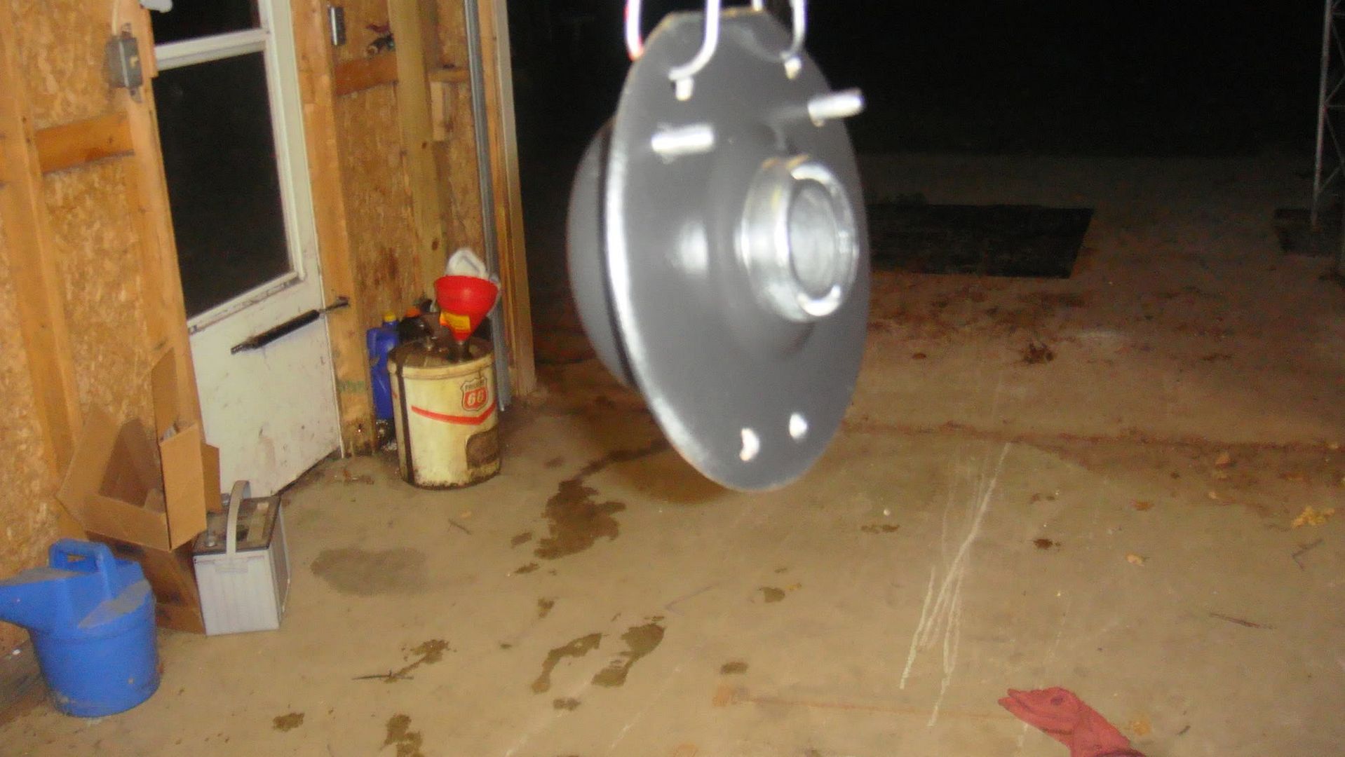

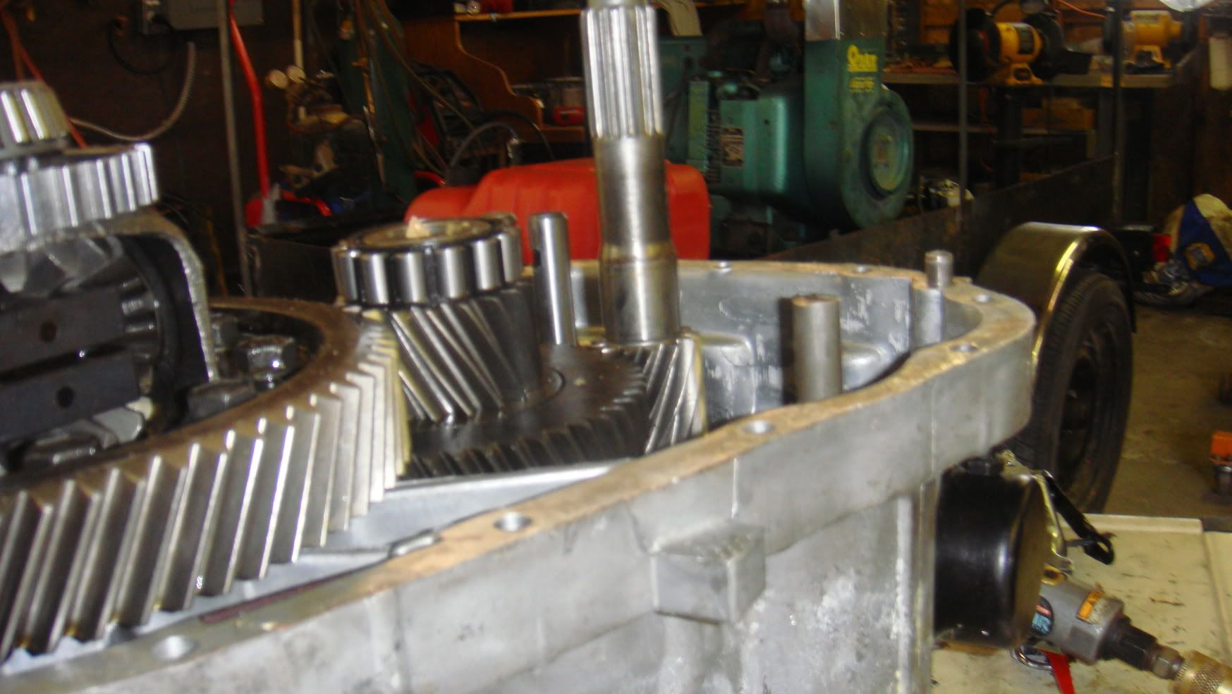

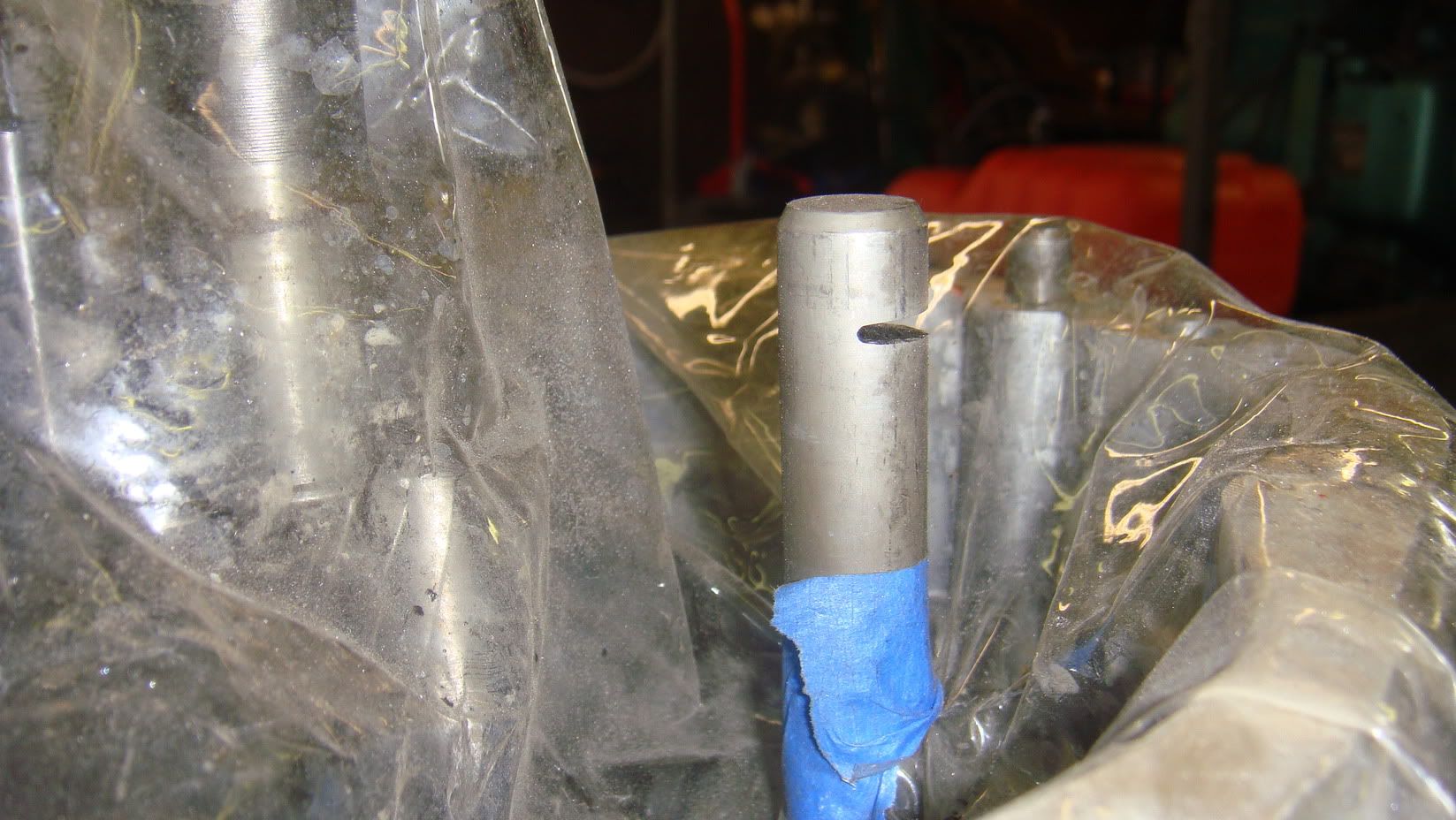

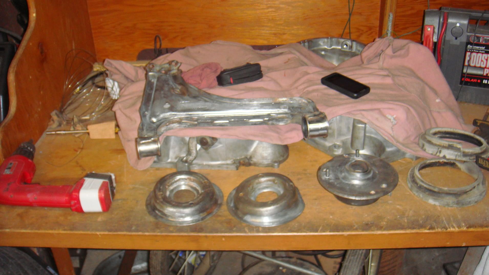

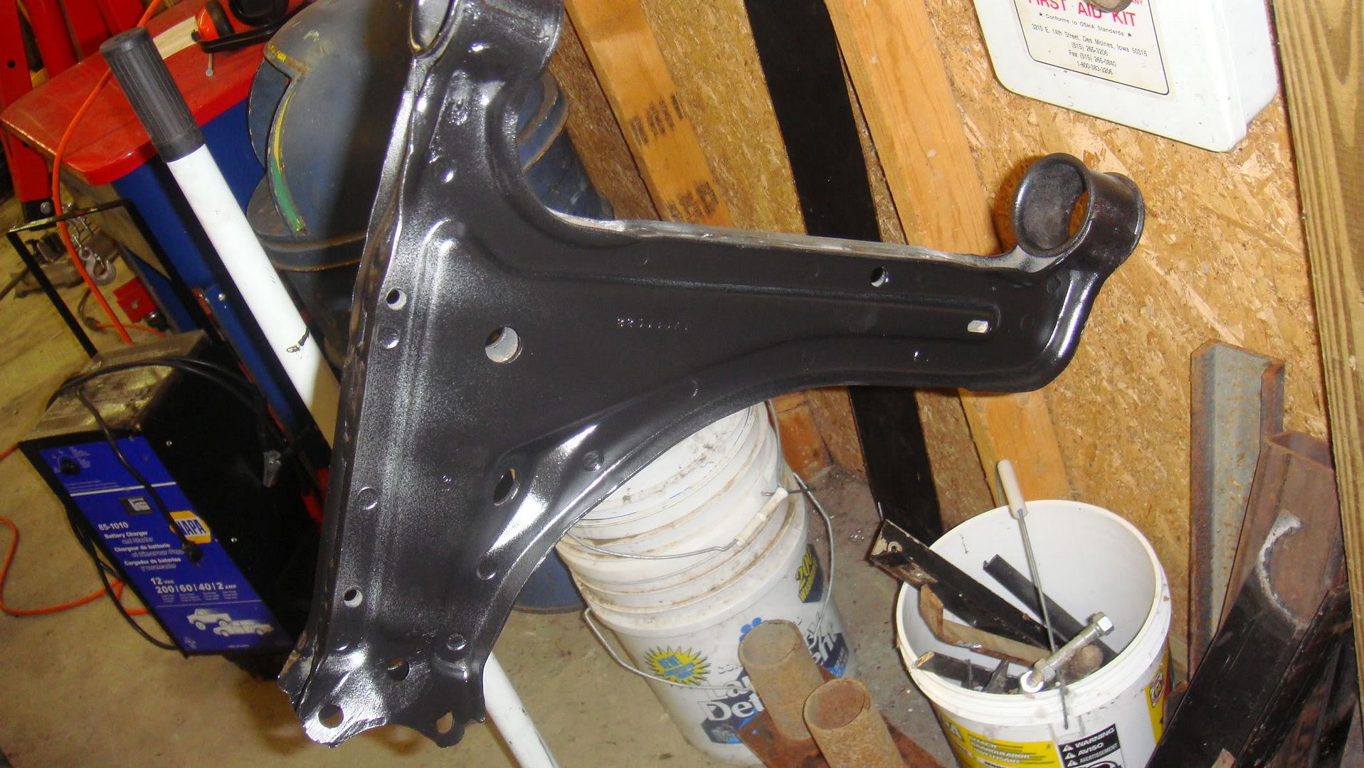

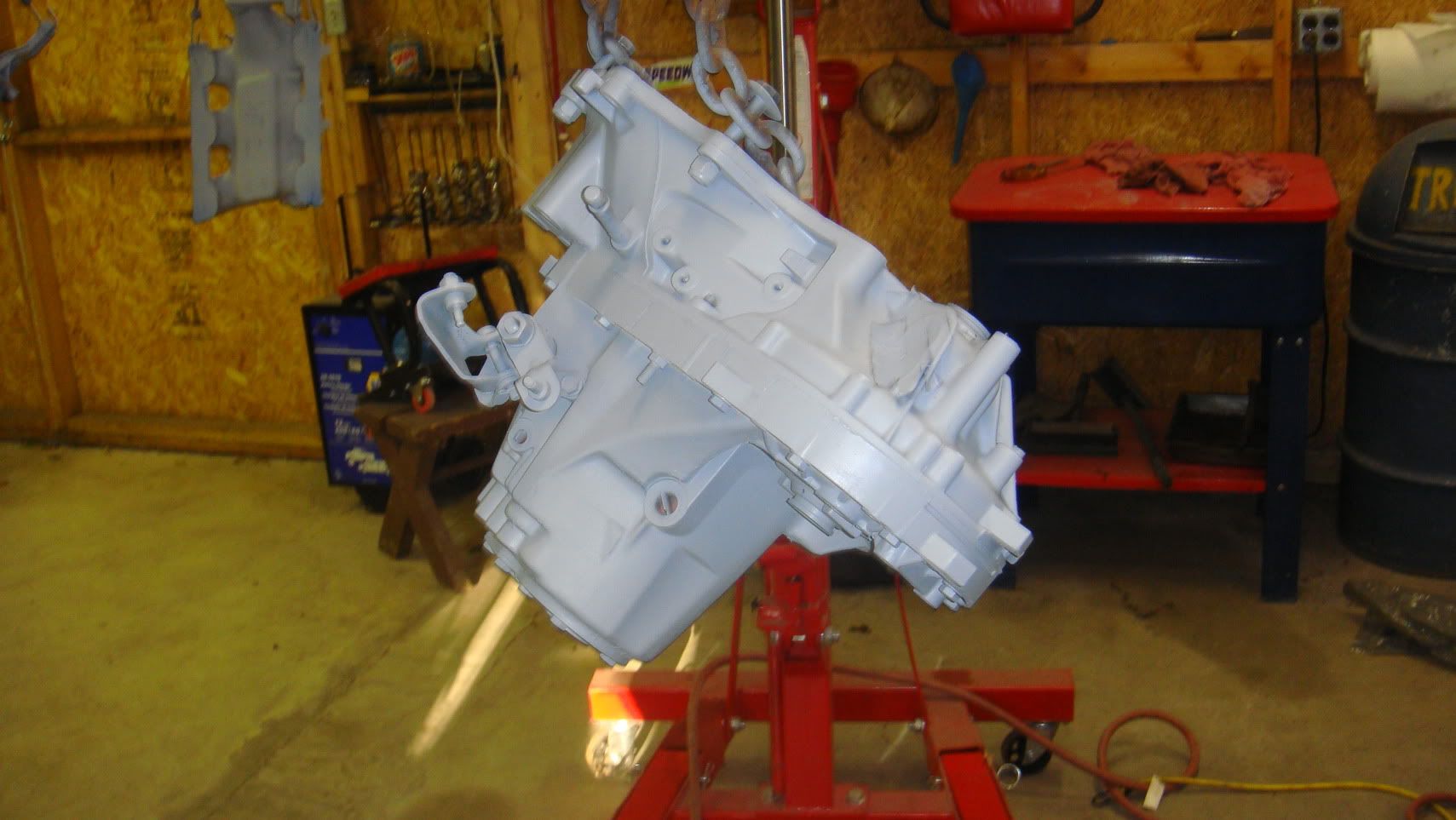

Well If you didn't know I had some front case tranny problems. One of the rods were hitting the case and locking into reverse. It ends up I have to cut in. I did measurements on it today. Two times, But I am going to wait and do them again tomorrow. So I did some parts painting.
These are the first coat of primer.
here is the link for the case problem: http://www.beretta.net/forum/viewtopic. ... 83&start=0

Well I got my lazy butt up after being sick. I did some cutting and more painting. I cut 7/16 off the reverse rod. After I cut it I did some much much needed cleaning of the shop that took me the rest of the day. But Now I have space for parts and painting.

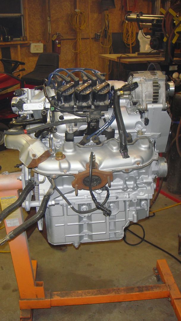

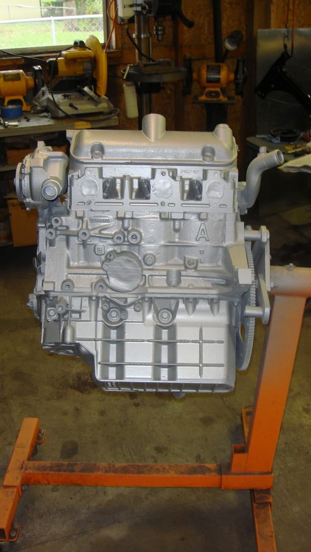

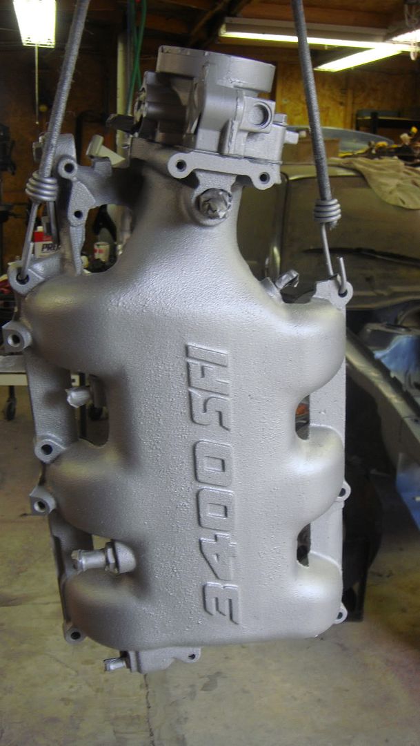

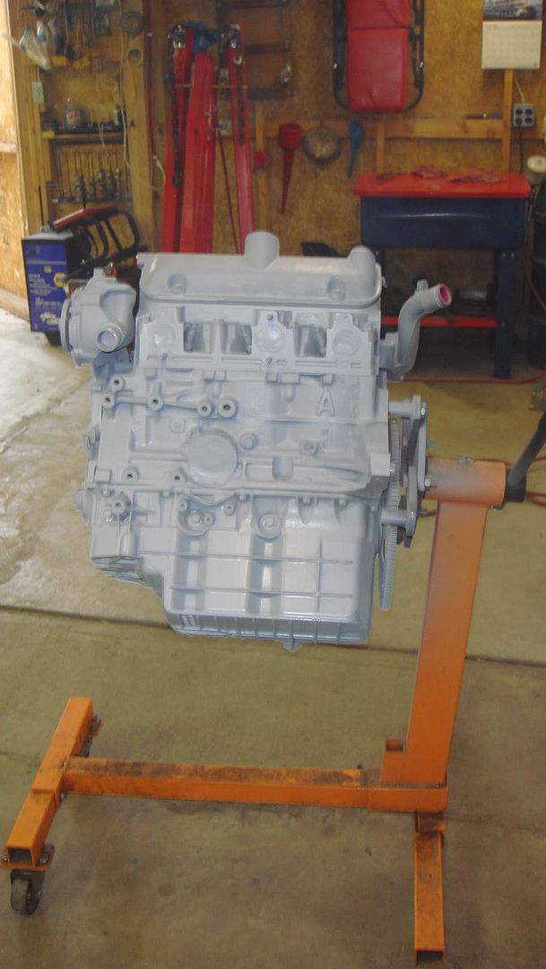

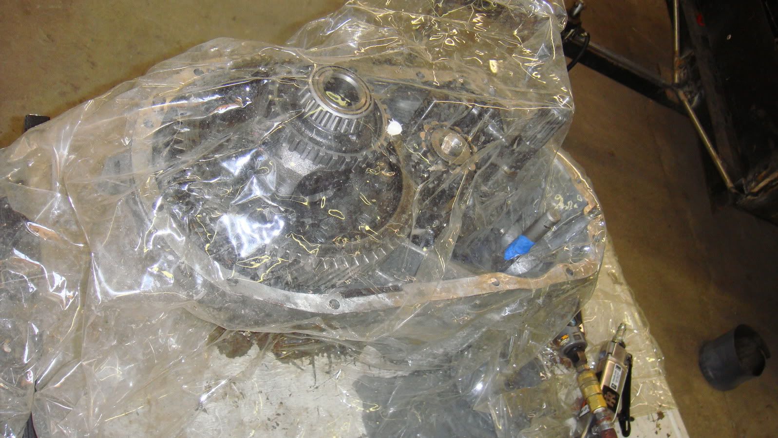

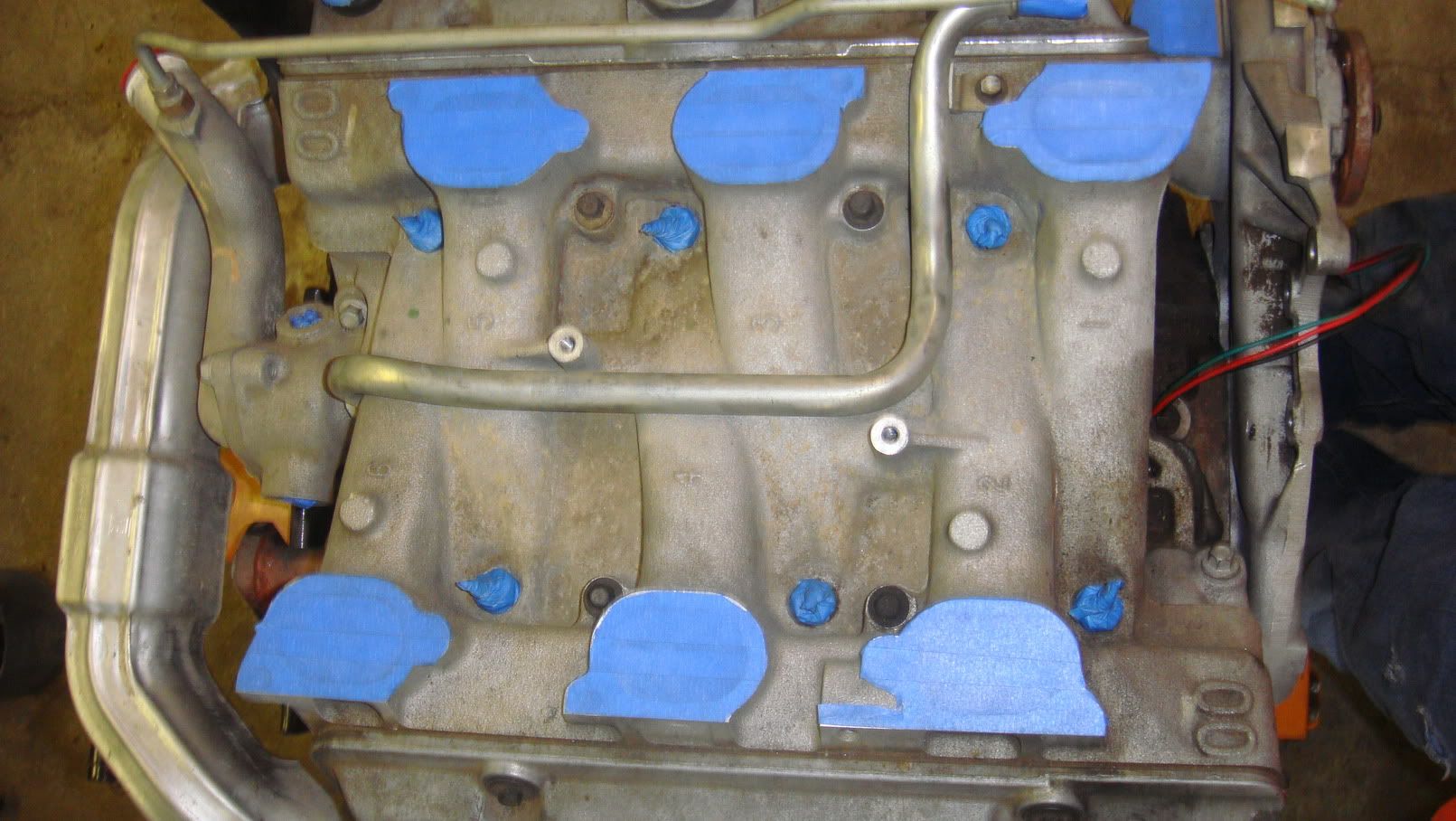

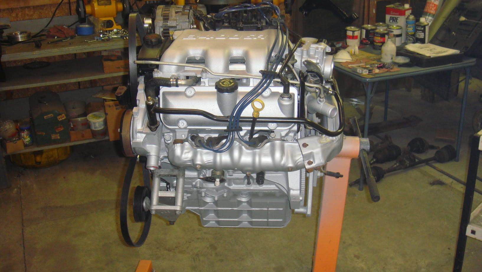

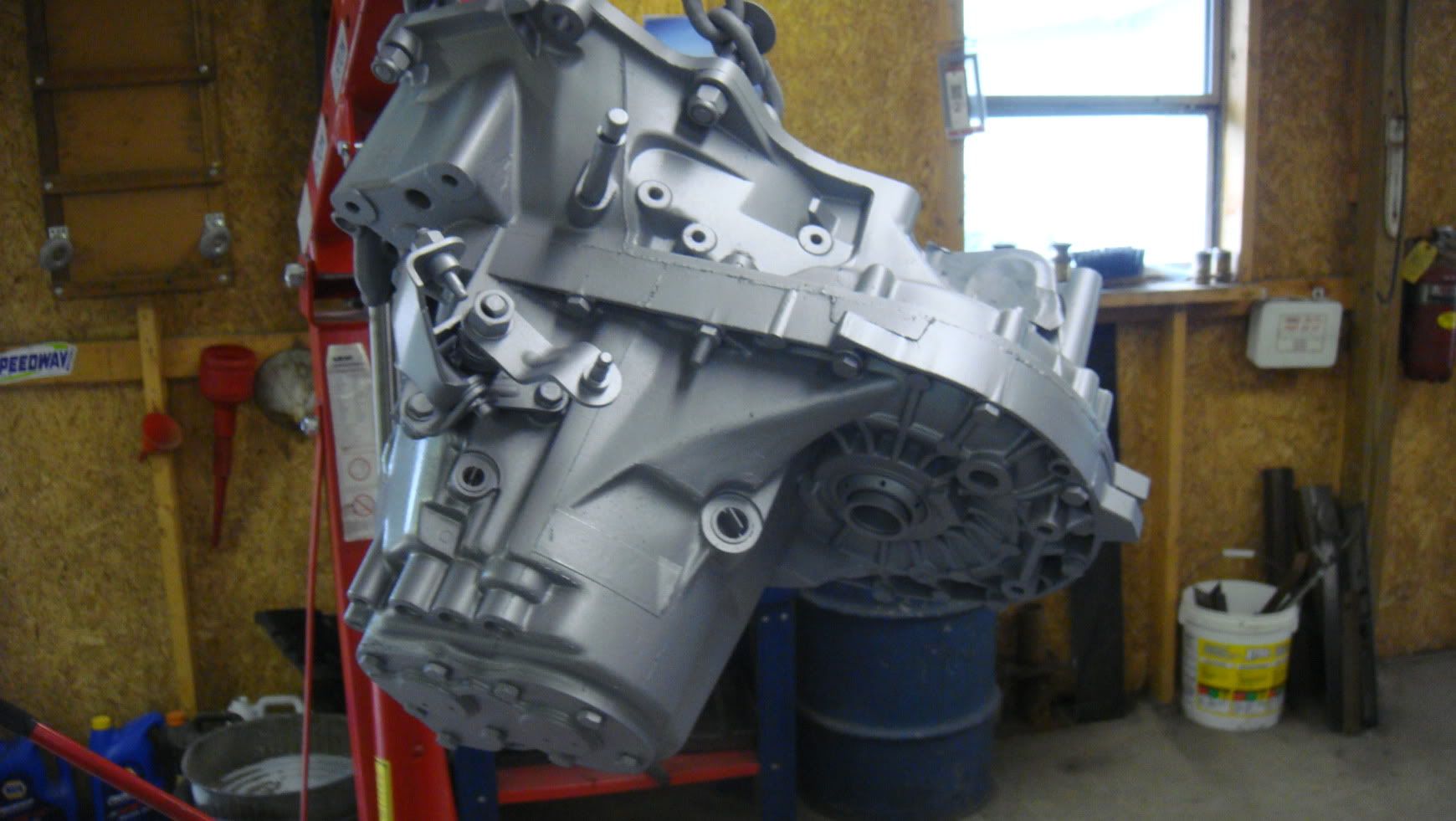

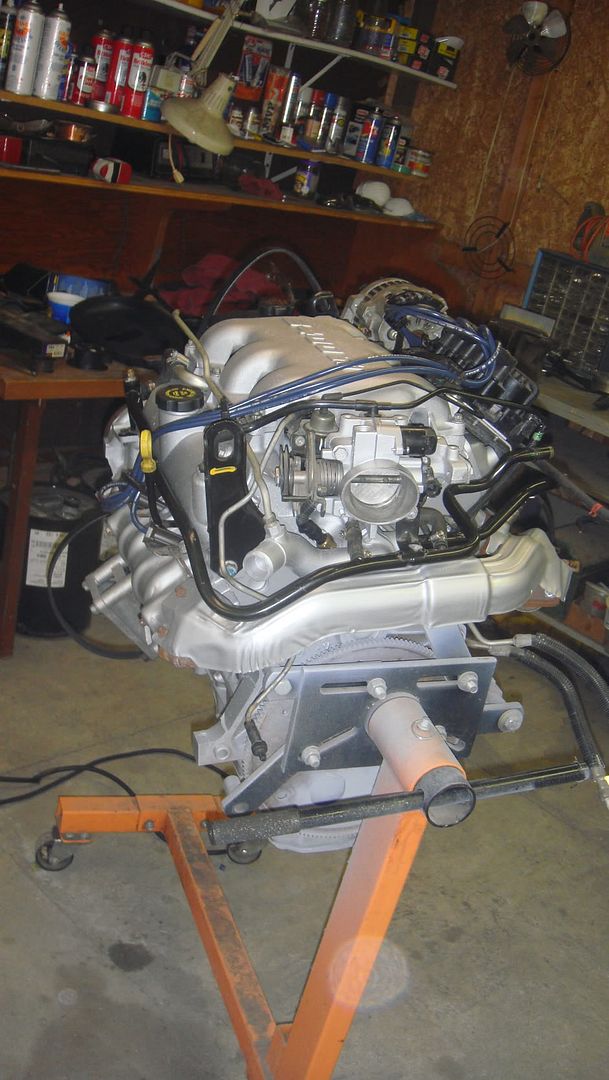

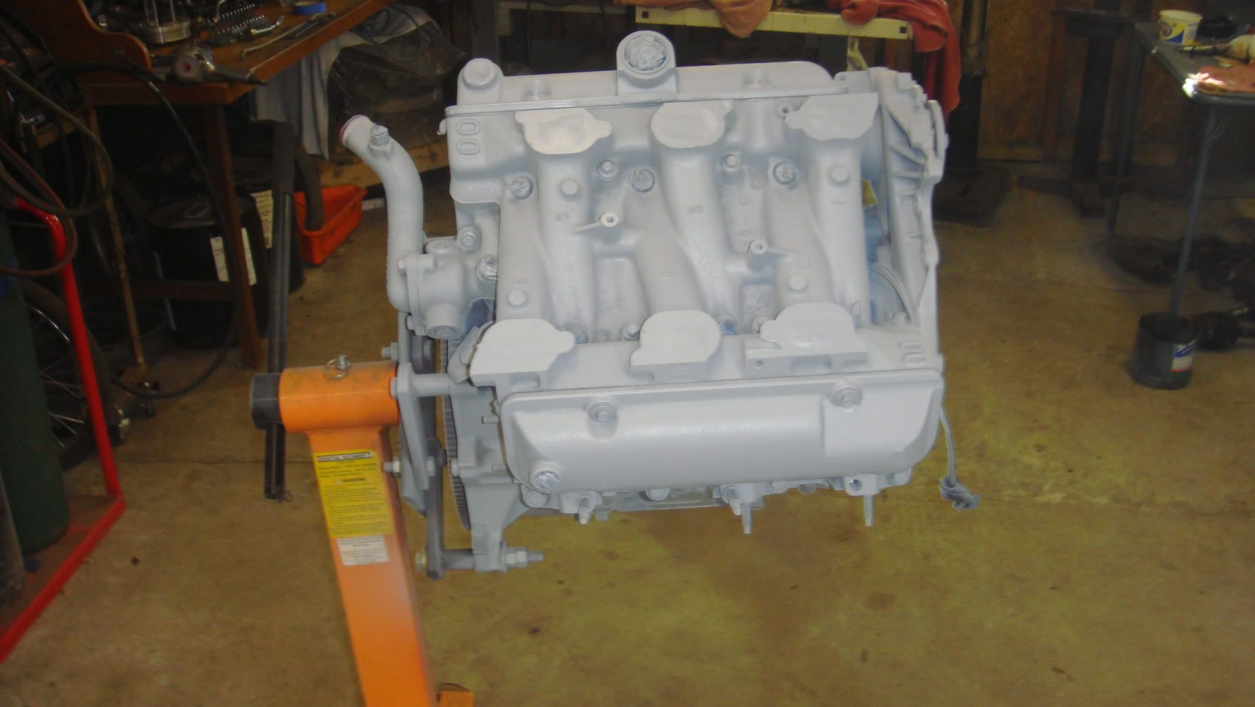

I got tranny together and sealed up. Cleaned and a coat of primer on in.

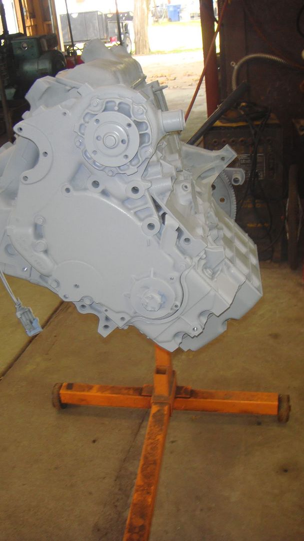

Engine, I got all undressed and clean and taped up for painting and got a coat on.

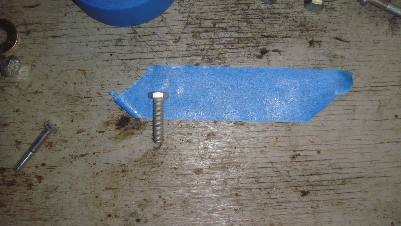

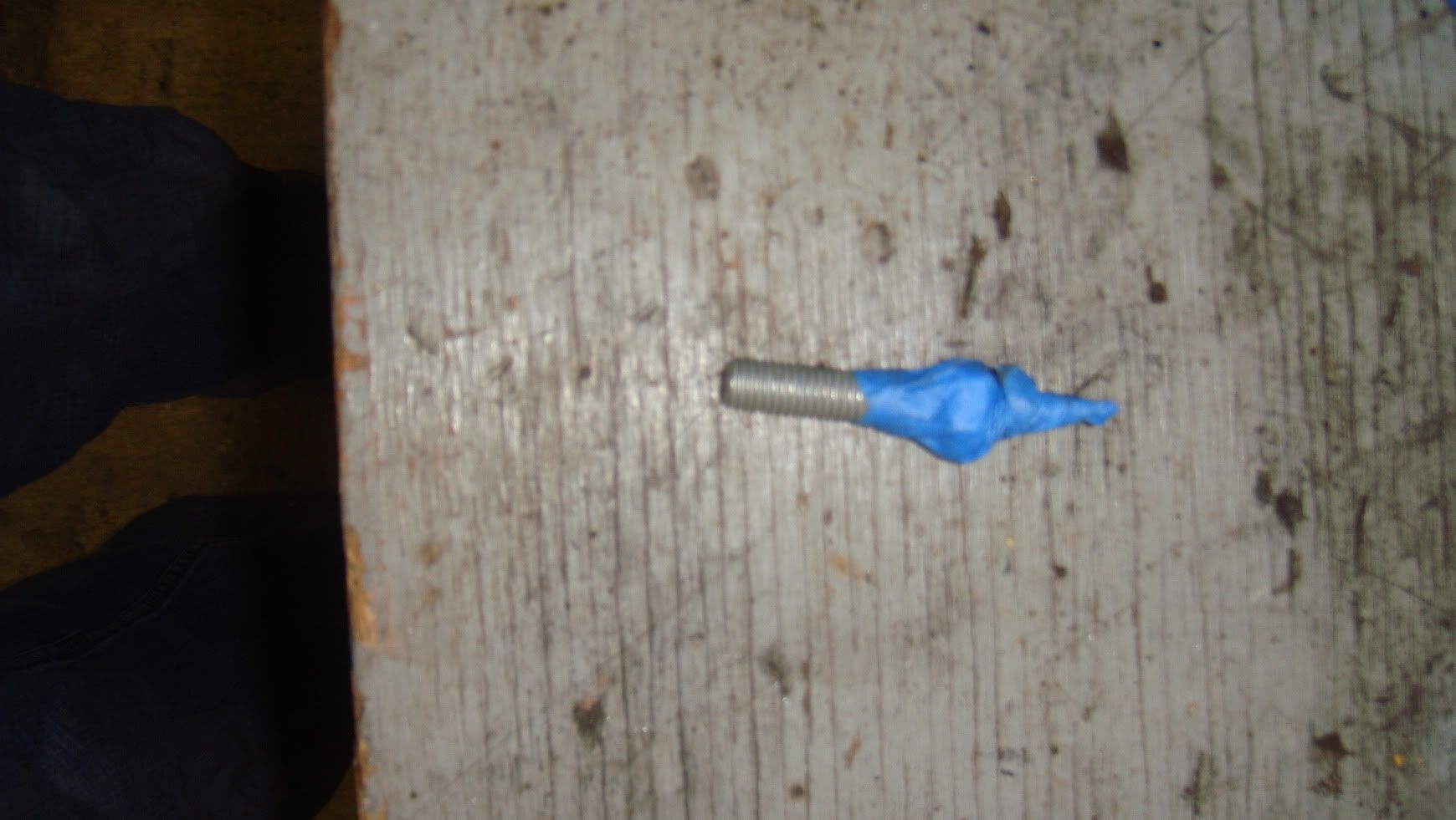

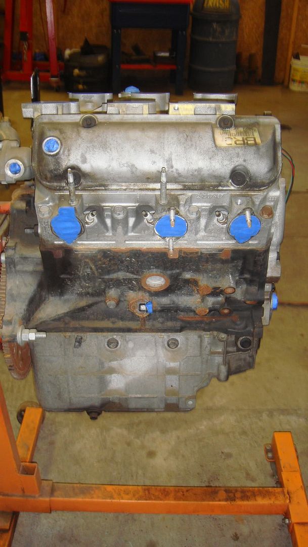

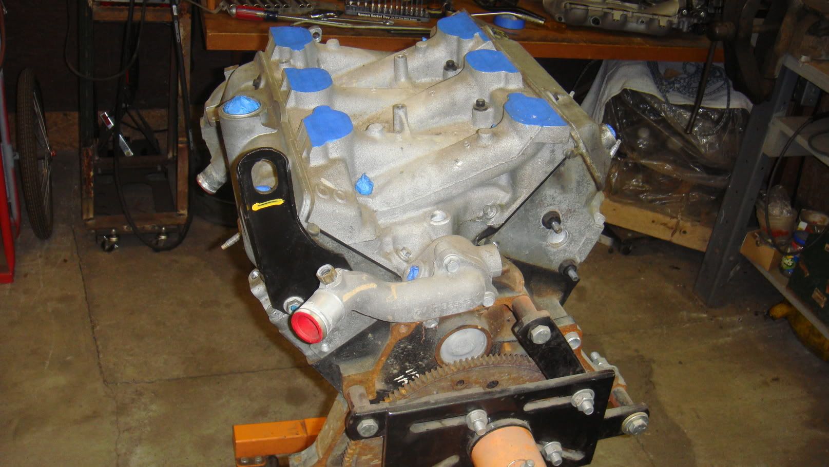

I didn't know how I should cover the injector slots so I used an oversized bolt with tape. Pictures below.

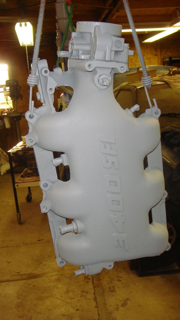

Here is the oversized bolt idea I used.
Here comes the paint:

Re: Project B
Post by MY91GT(Z) »
i love the primer look i wish i wouldve taken pix of mine as it looked pretty stellar with bout 3-4 coats of prime and about the same for clear coat & also had to add some blk inmine too

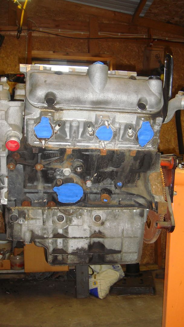

Re: Project B
I'm still trying to figure out how you got the primer to stick to all that oil and crap.
Luckymc420
Posts: 489
Joined: Mon Jul 10, 2006 1:31 pm
Location: Des Moines, Iowa
Re: Project B
Post by Luckymc420 »
Well to tell you the truth the engine was not really dirty at all. The only really bad parts were the front on the oil pan. I first I used a degreaser from work and then I used a Pre prep from Eastwood that removes dirt and oil and helps the paint stick. And some areas I had to use a screw driver to get into the little parts.
Here is the Base coat.
Re: Project B
Ok, so you cleaned it after you taped it up with painters tape? That I did not know. I would have used something like duct tape to seal it up and then clean it... Cheaper tape, and also less chance of it coming off during the cleaning process... then again I did use a power washer when I did mine :)
