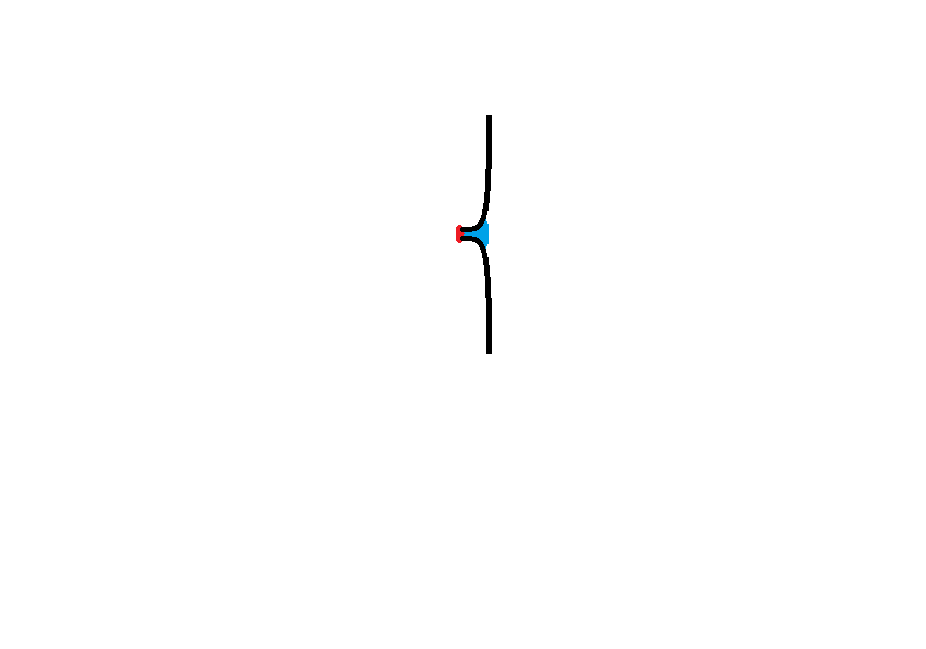

The sealant 3x00-Modified is proposing should do fine, maybe even better, since it applies in liquid form and may seal into the cracks better. But, I still suggest spreading the sealer in from the inside as well (maybe even first, and try to push it all the way through from the inside to the engine bay to make the sealant form one solid piece and prevent any air-gaps from forming between the multiple applications). There is better access from the inside, and the sheet-metal pieces meeting at this seam diverge on the inside, so it would be almost impossible to fill the entire gap and have it factory-smooth inside without applying it from under the dash.
Okay, look at it this way, if this sketch represents the cross-section of the firewall where the two pieces meet, applying sealant only to the outside (left side, represented in red) is a pretty flimsy seal as compared to pushing the sealant from the divergent inside joint under the dash (as represented by the teal color on the right).
Either way, good luck with it. I'm still going for the butyl-tape on the inside, but I think I'll apply a thin, deep layer of a sealant more like Jon suggests first just to get the gap filled better, and cap it off with the butyl-tape to make sure water never gets through it again.

by 3X00-Modified
thats not how the seems look... but ok.
