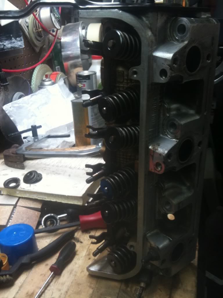

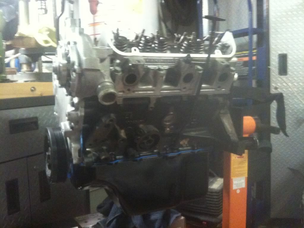

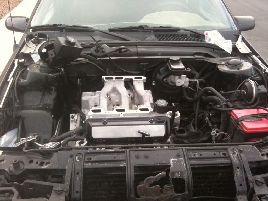

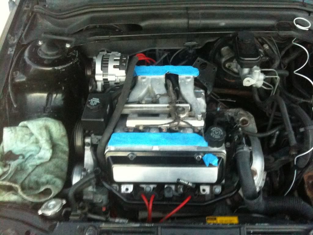

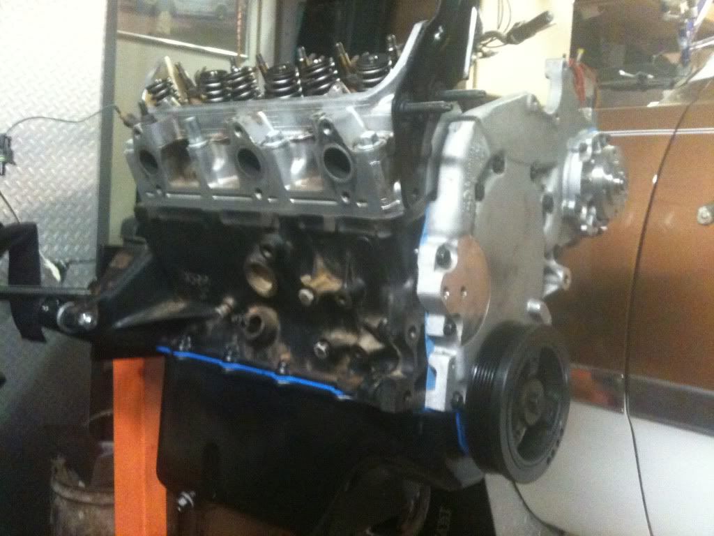

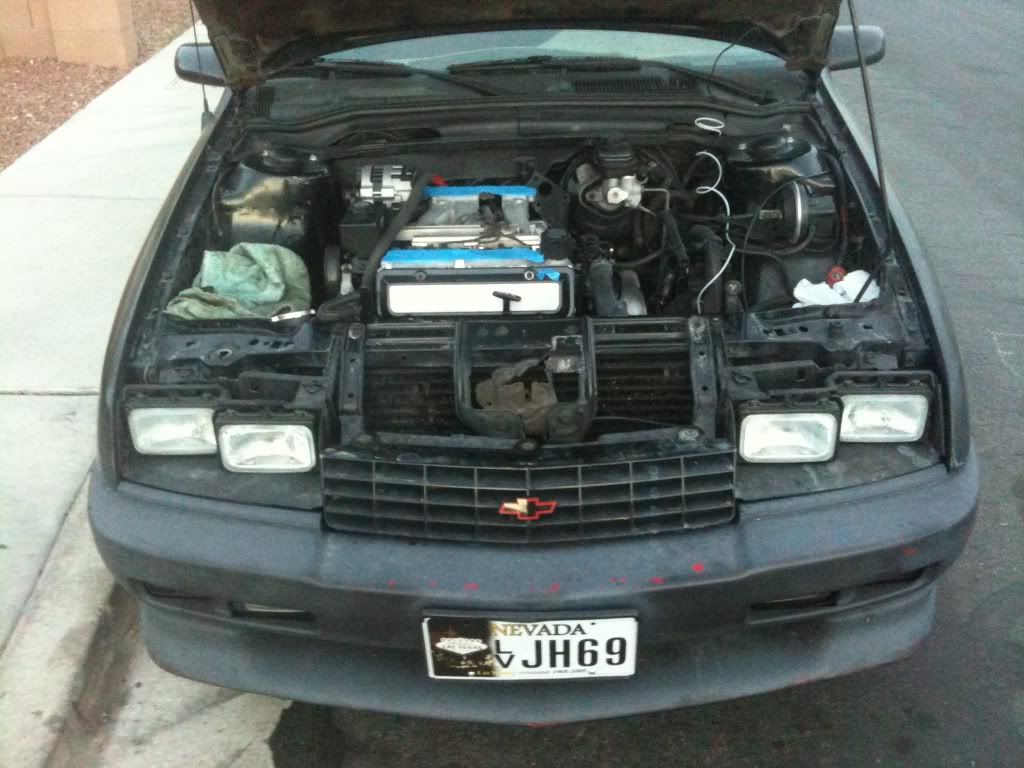

Ok...I've been debating on spilling what i have done to this engine, but as i continue debating here are some pics for your enjoyment...
ronaconda
Posts: 688
Location: Salt Lake City, UT
Re: Ok...here we go!!!
Post by ronaconda »
...bypassed the throttle body...
...and it runs...
