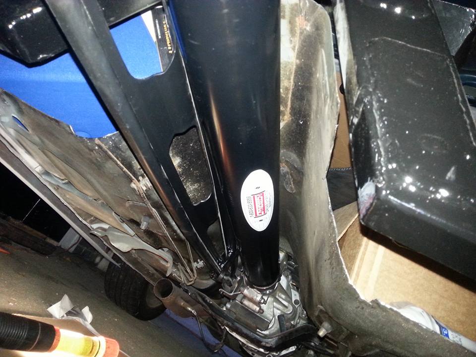

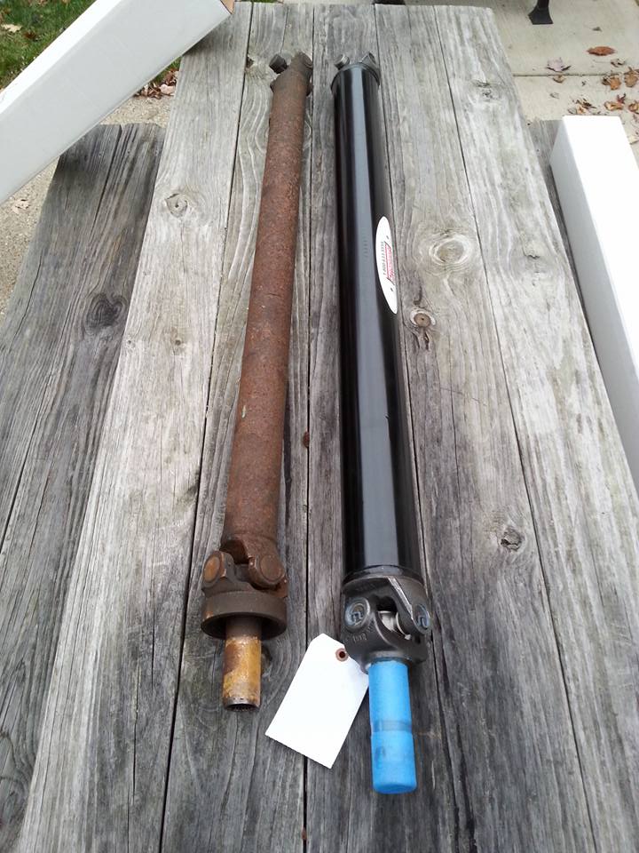

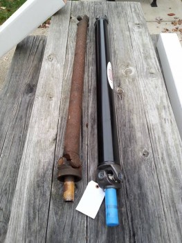

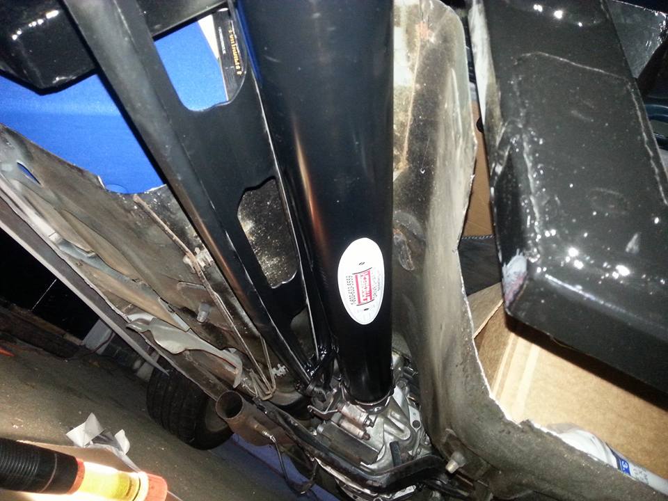

i talked to DSS, DennysDS, a place called ring and pinion and last a place by me called Dynotech.......no one came in under 400 $$ so to save on shipping i went with Dynotech.....I have a few buddies i work with who highly recommend them. and they were the cheapest seeing as i can save 50 $$ by not shipping. im having a pretty beefy shaft made (thats why there so expensive) to well exceed my current power levels to leave room to upgrade the motor as i can later.

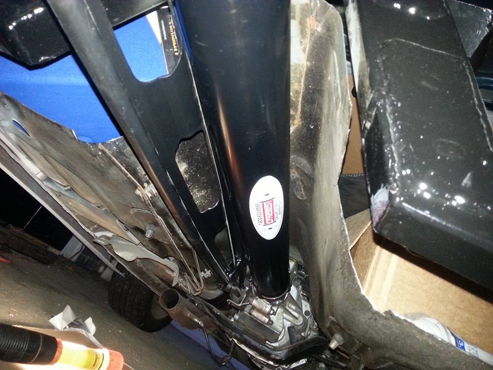

Well u know what they say.....Go big !!!!! Or Go ....get u a big ass drive shaft !!!!! 3.5 inch DOM from dynotech ......should hold everything I can put through it and more
Posts: 668
Re: Beretta Z28
Post by ifixalot »
My 68's drive-shaft is 47 inches long center to center.
I have a 1310 u joint on one end and a 1350 u joint on the other end.
So mine would not have worked, it's too long.
Keep up the good work on your project.
Posts: 4778
Re: Beretta Z28
You sure have a nice looking shaft! haha
What size are the u-joints?

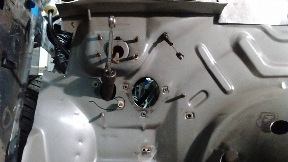

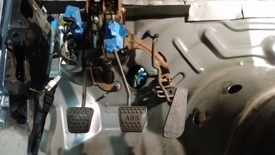

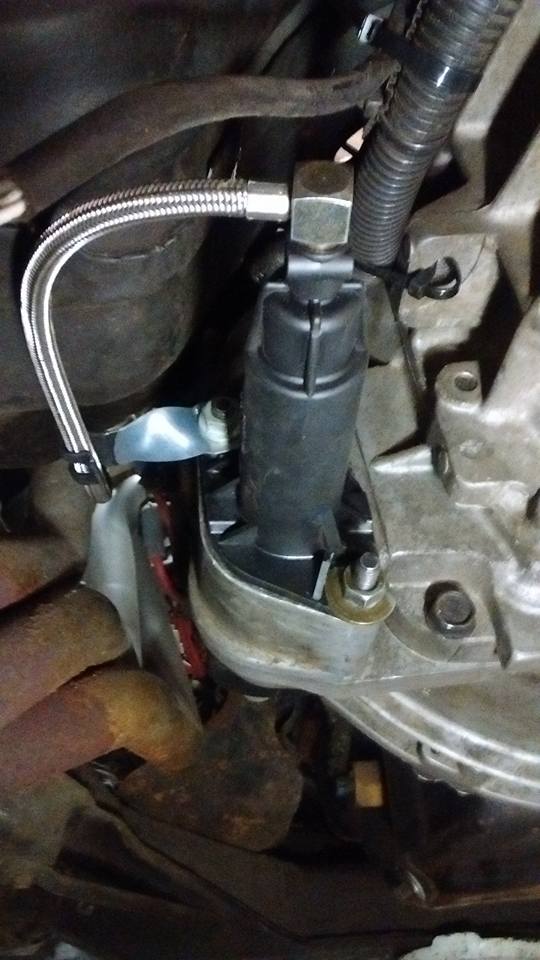

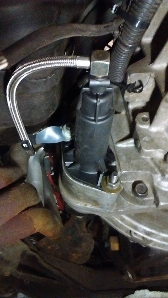

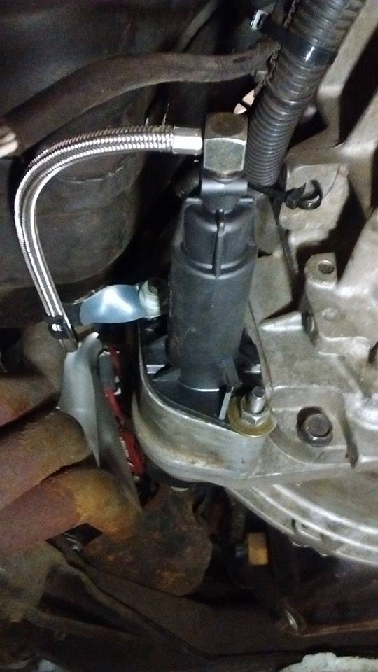

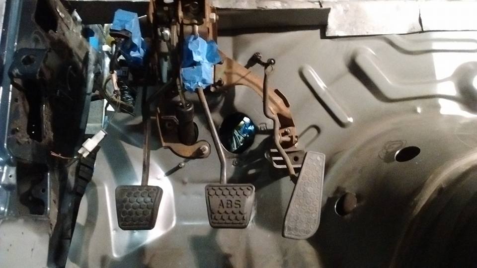

Clutch master cylinder and manual pedals getting fitted on the firewall and Finished test fitting the master/slave cylinder for the cluth/t56

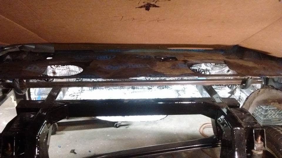

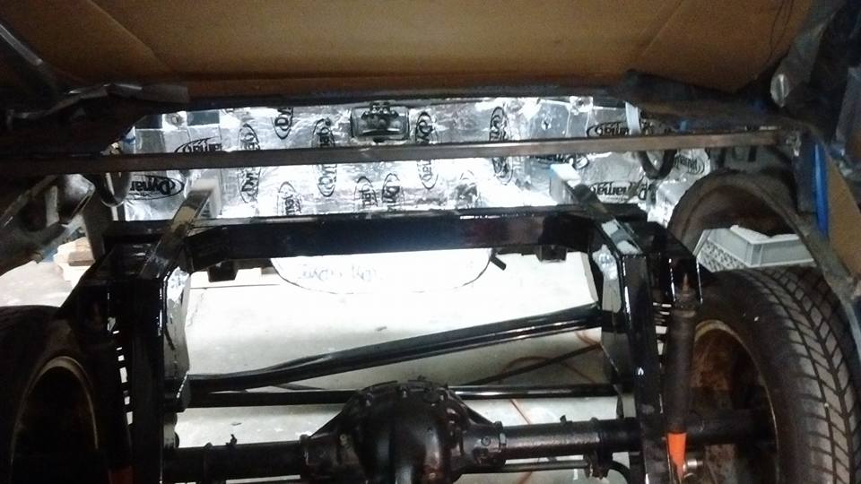

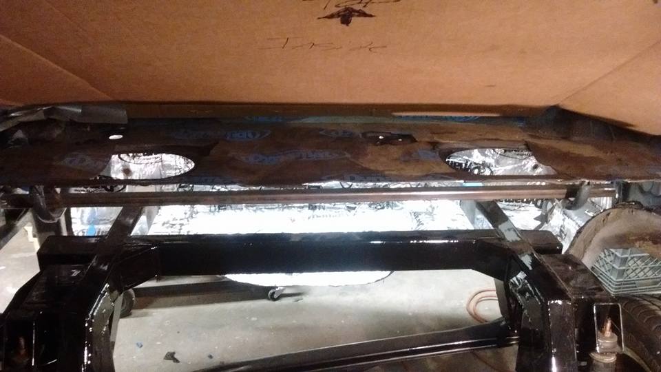

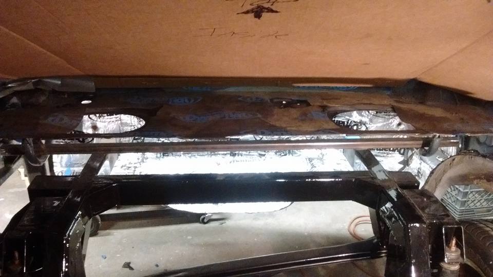

Some rear firewall progress....Cut out the rear speaker package tray and welded in a cross brace ......

Re: Beretta Z28
Will there be a faux speaker package tray put back?
jjanke
Posts: 425
Re: Beretta Z28
Post by jjanke »
Yeah ....... There was so many lil holes in it......gonna just put a clean piece of sheet metal there...maybe with some bead rolls in it......keep the smoke out hahaha.... And the fire to !!!
Re: Beretta Z28
removable sheet? if so, might run into T.I issues... if you run it on a course.
jjanke
Posts: 425
Re: Beretta Z28
Post by jjanke »
Was thinking just the center portion will be rivited in.......the speaker package tray, sides and front will all be welded for sure ......I will definitely look into it though thanks.....
Posts: 4778
Re: Beretta Z28
There are restrictions on the gauge of steel/alum you use for the rear firewall too.
Quick google turned this up.
http://www.jalopyjournal.com/forum/thre ... on.435175/
