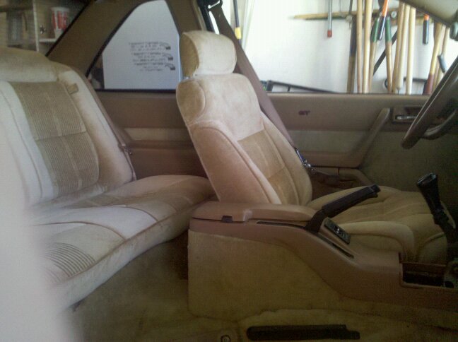

okay...okay...teaser pic #2!

lmnjlo wrote:okay...okay...teaser pic #2!
omg... le drool. Oh someday I'll restore my interior. I'm getting there. but not quite there yet. I want my sexy tan seats back.

That interior is very brown... LOL

The body shop did the work before it was painted. It's all flush and smooth. The old seats were so worn out and faded. This cloth exactly matches the old cloth once we pulled back the seems and matched it up. This new cloth is an exact match believe it or not. Better dark then too light. Lol

That interior is very sexy... LOL
fixed

car looks great and so does the interior
