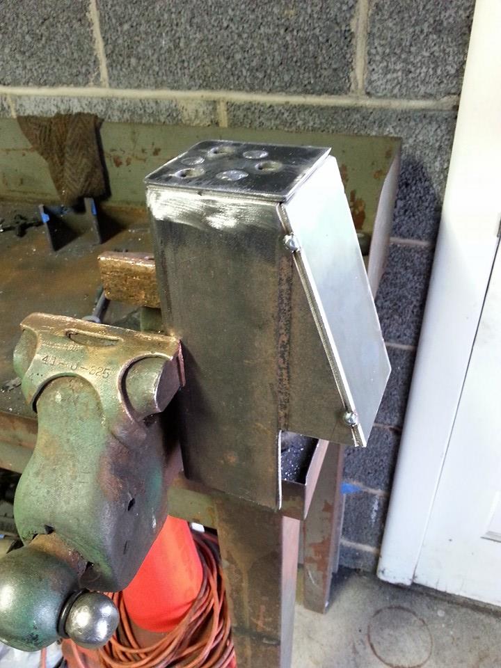

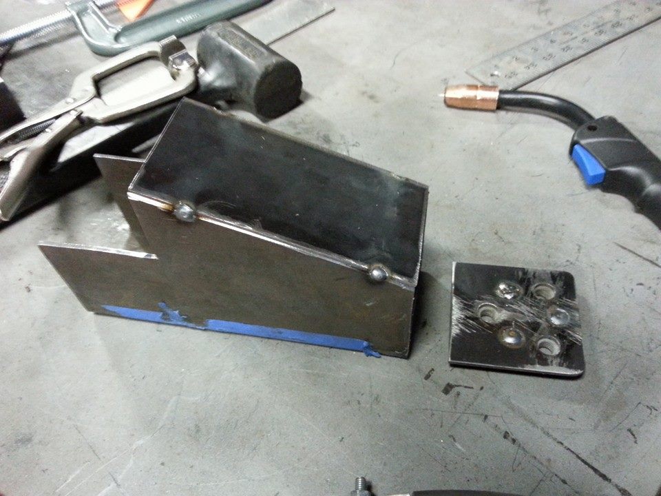

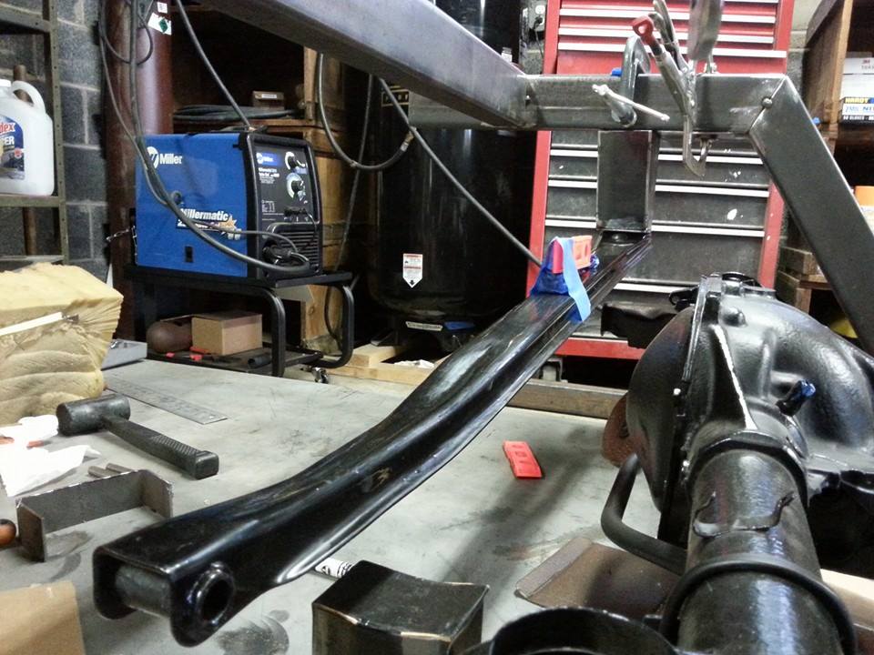

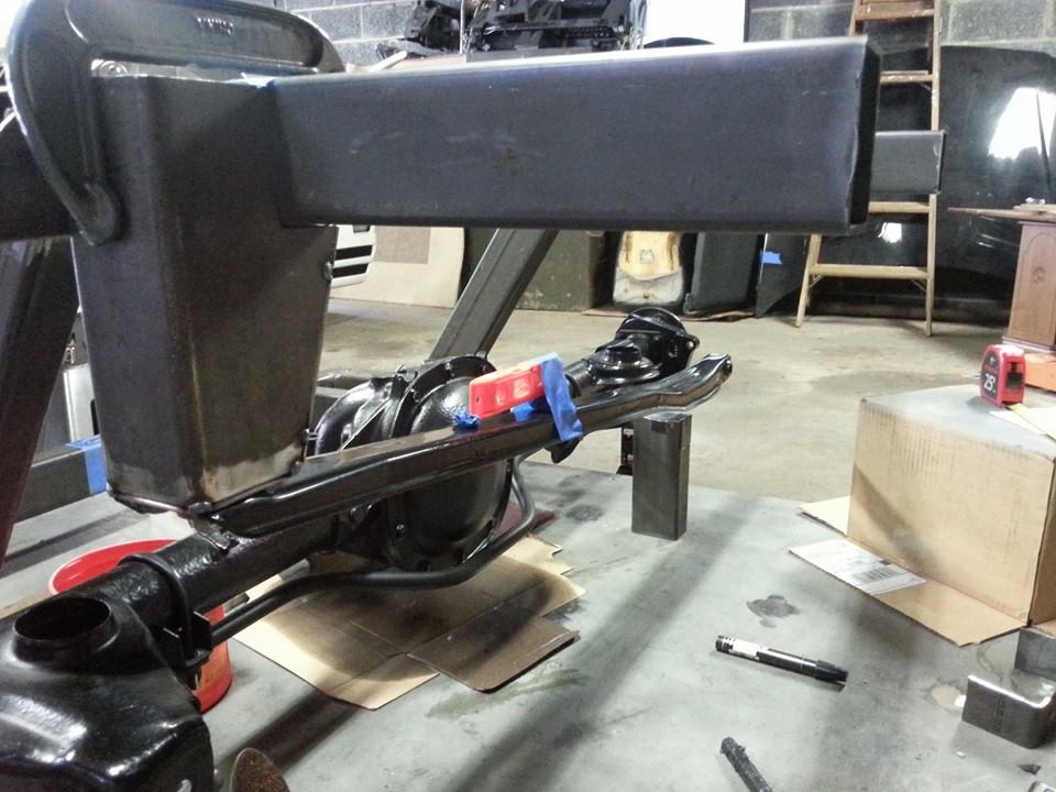

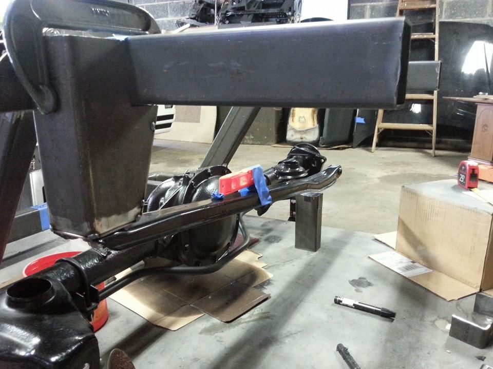

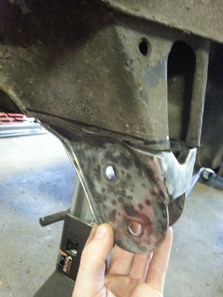

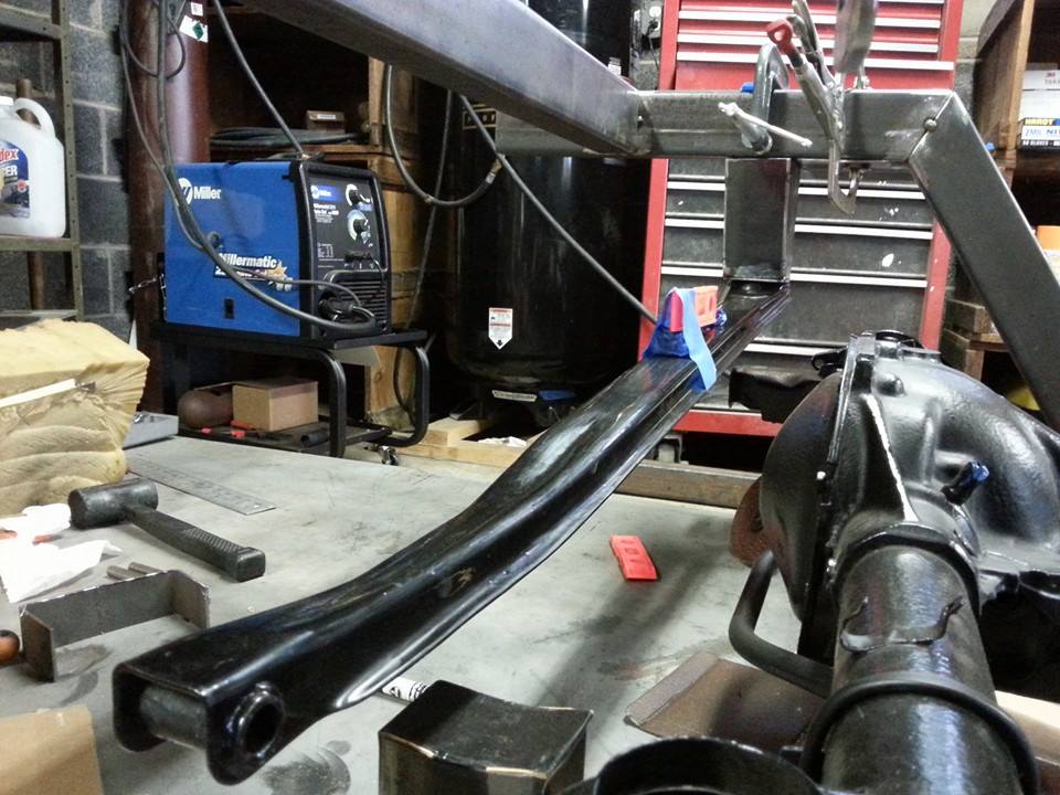

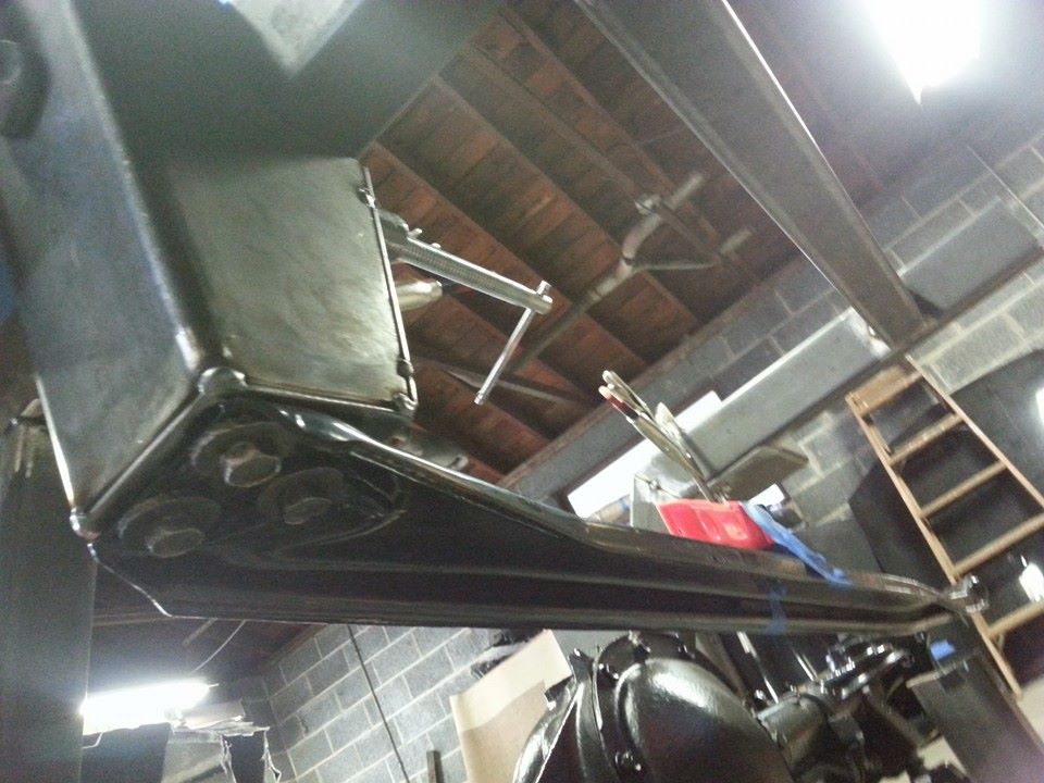

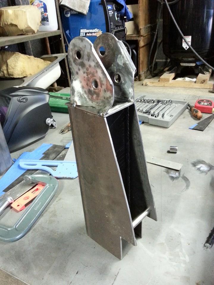

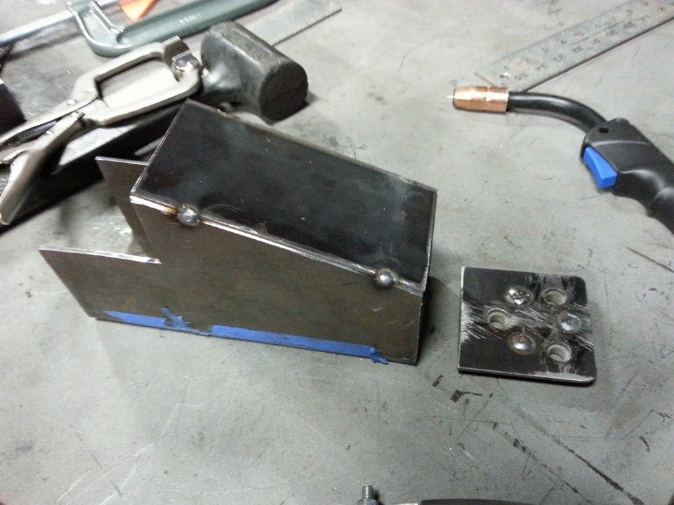

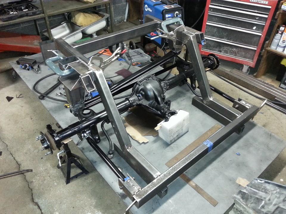

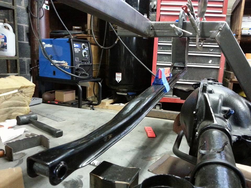

Driver side panhard bar bracket done and upper panhard bar brace cleaned repainted and mocked up

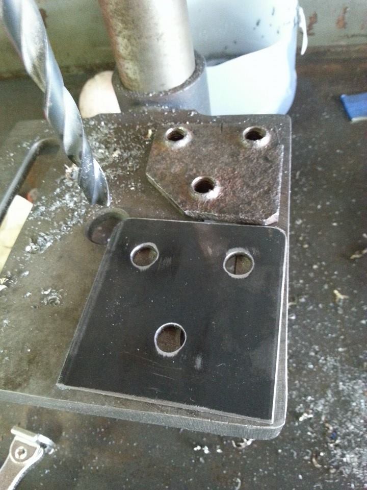

Post by jjanke »

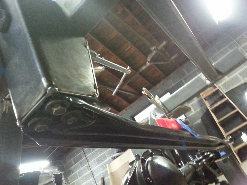

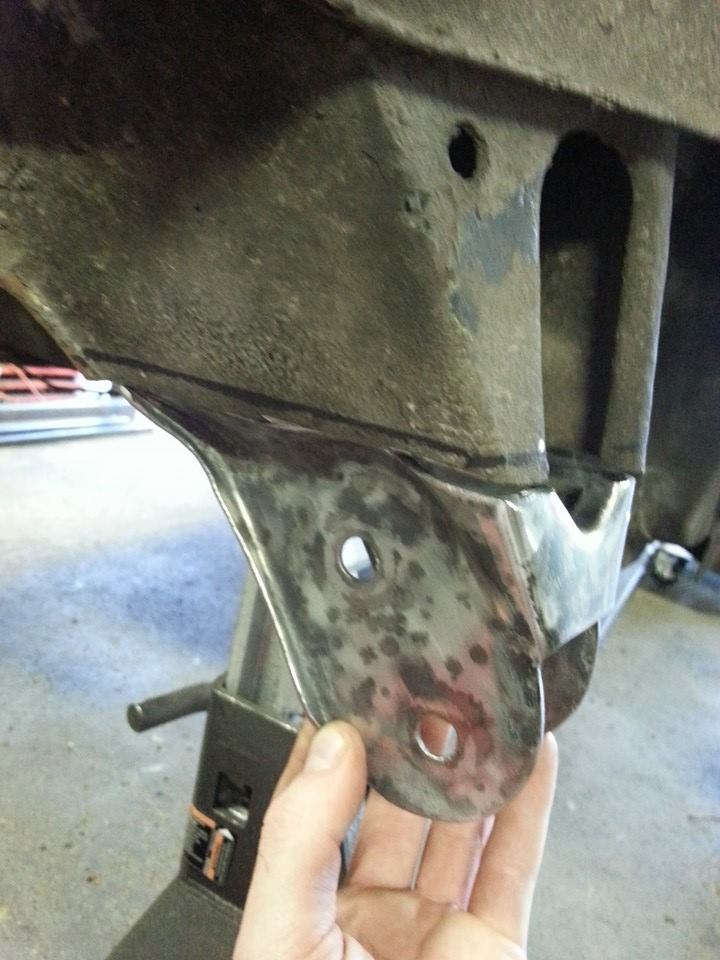

panhard bar

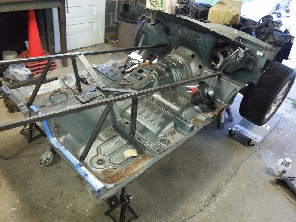

Post by jjanke »

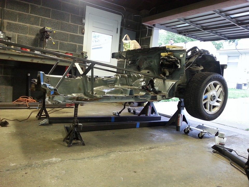

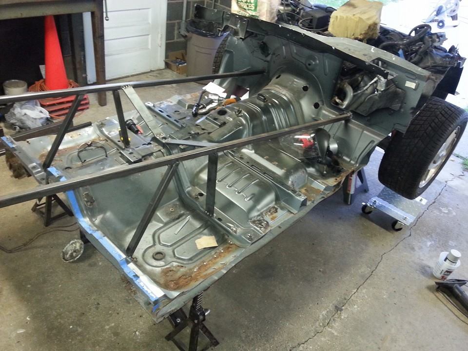

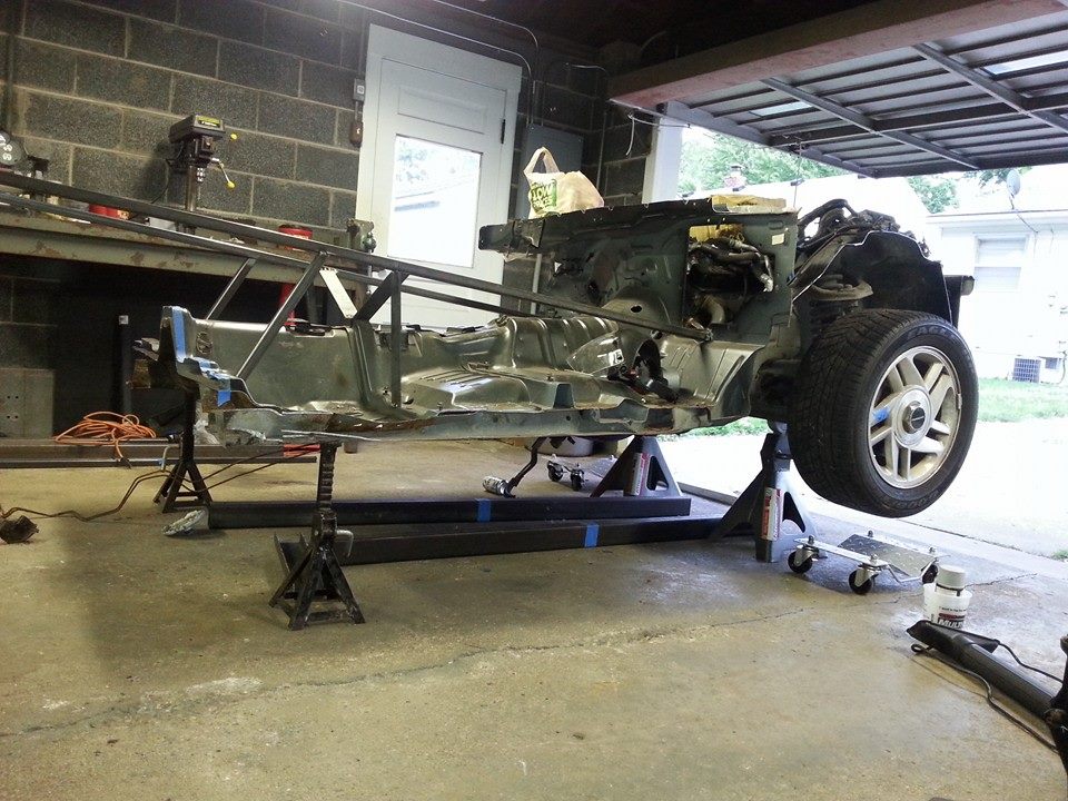

Im gonna run 3x2 box (body rails) from the rear sub up to the fire walland tie a cage into that......im thinkin the cage will add all the strength I need but we will see......sub frame connectors cant hurt.....

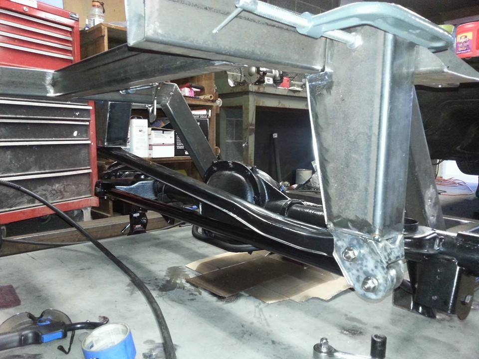

Post by jjanke »

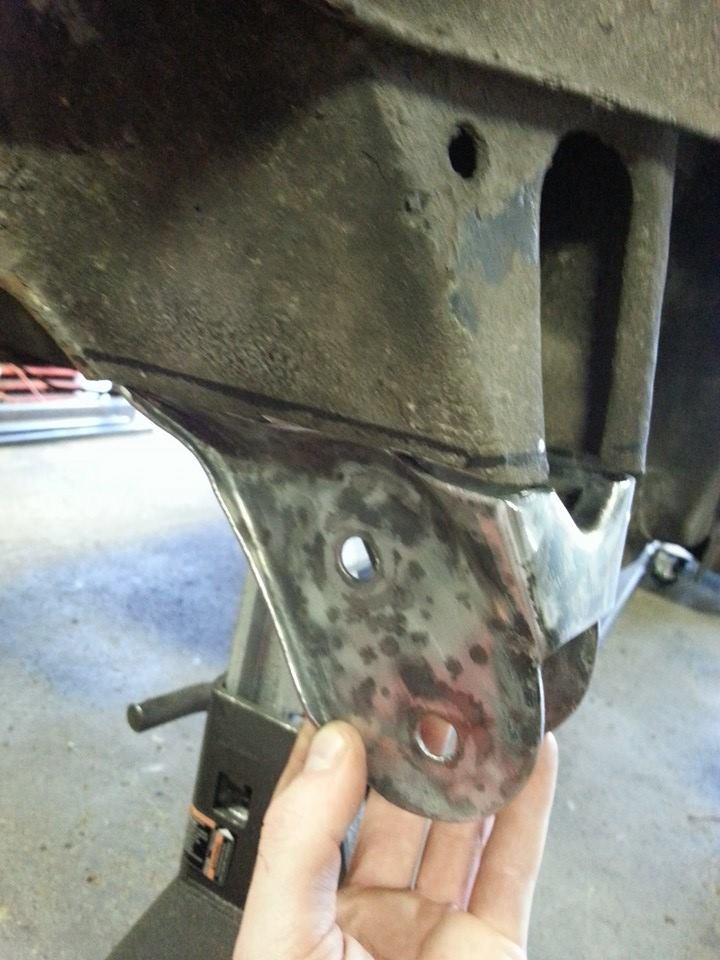

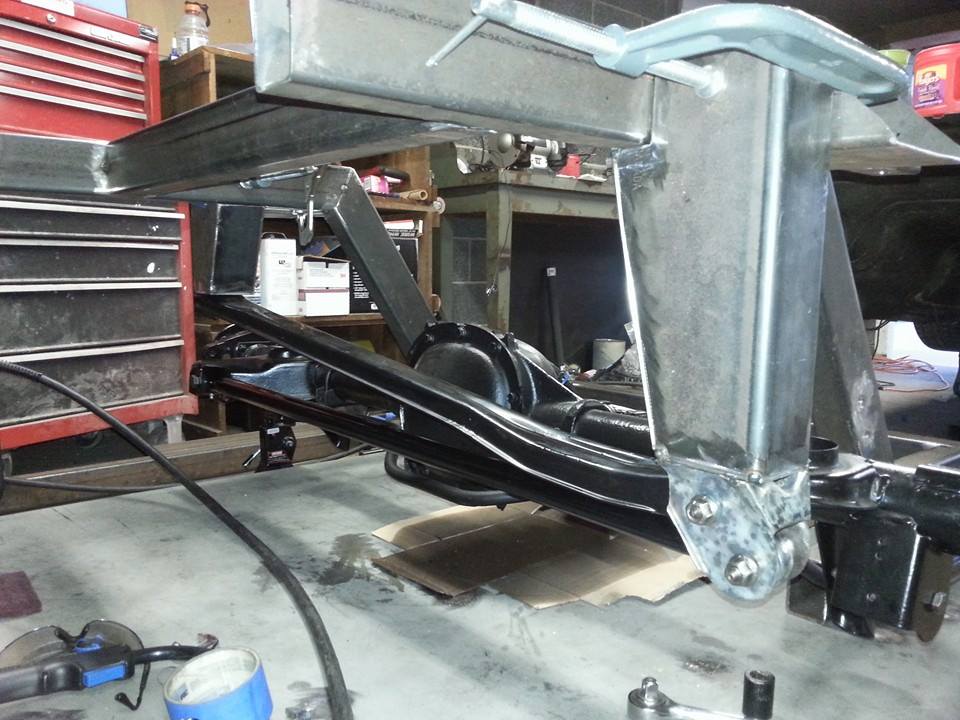

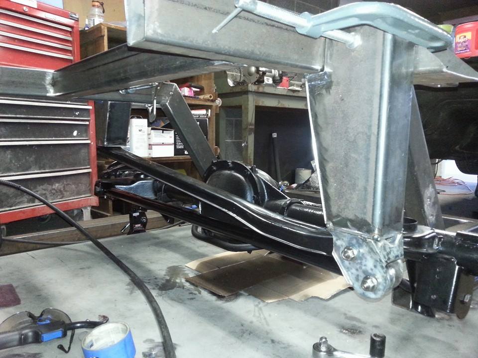

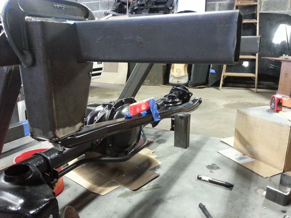

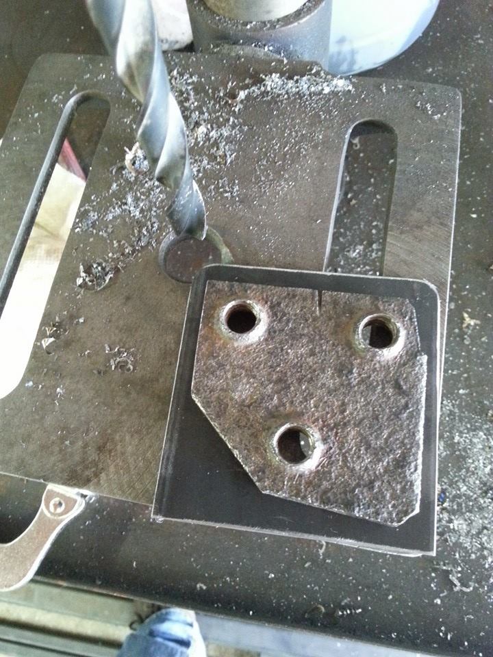

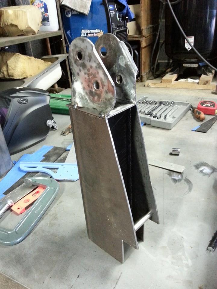

passenger side panhard bar bracket mocked up and panhard bar installed

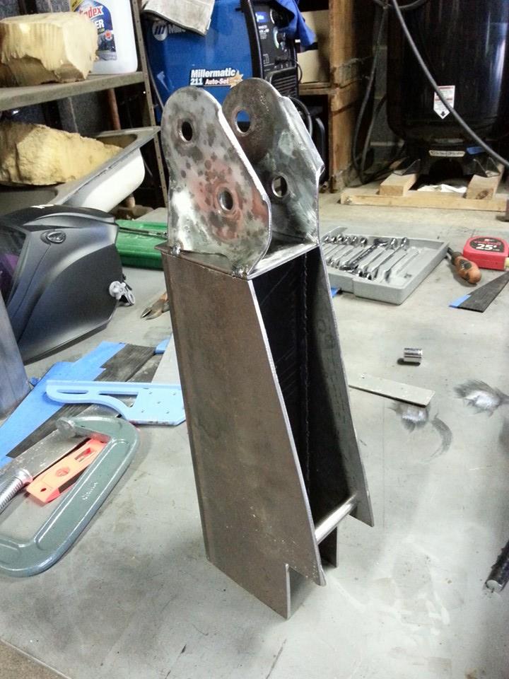

Post by jjanke »

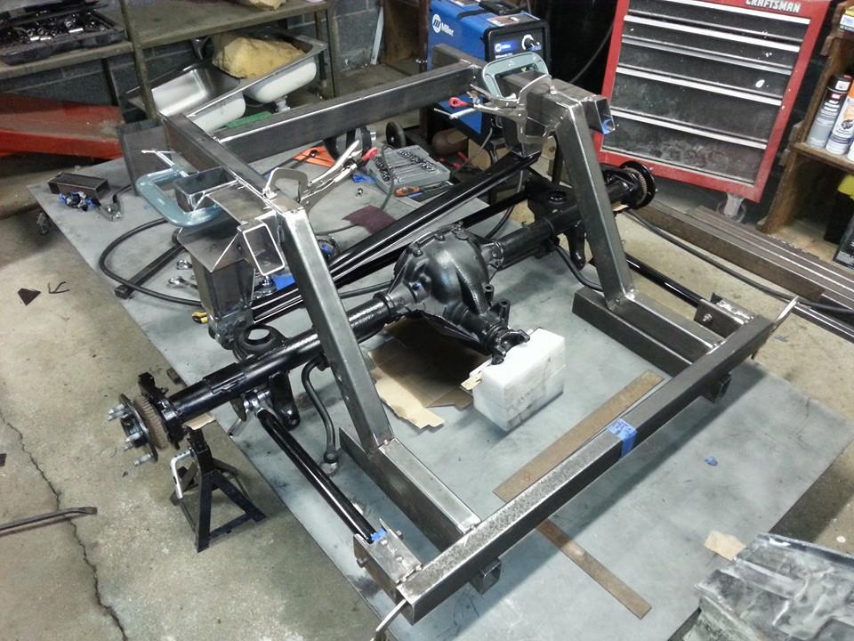

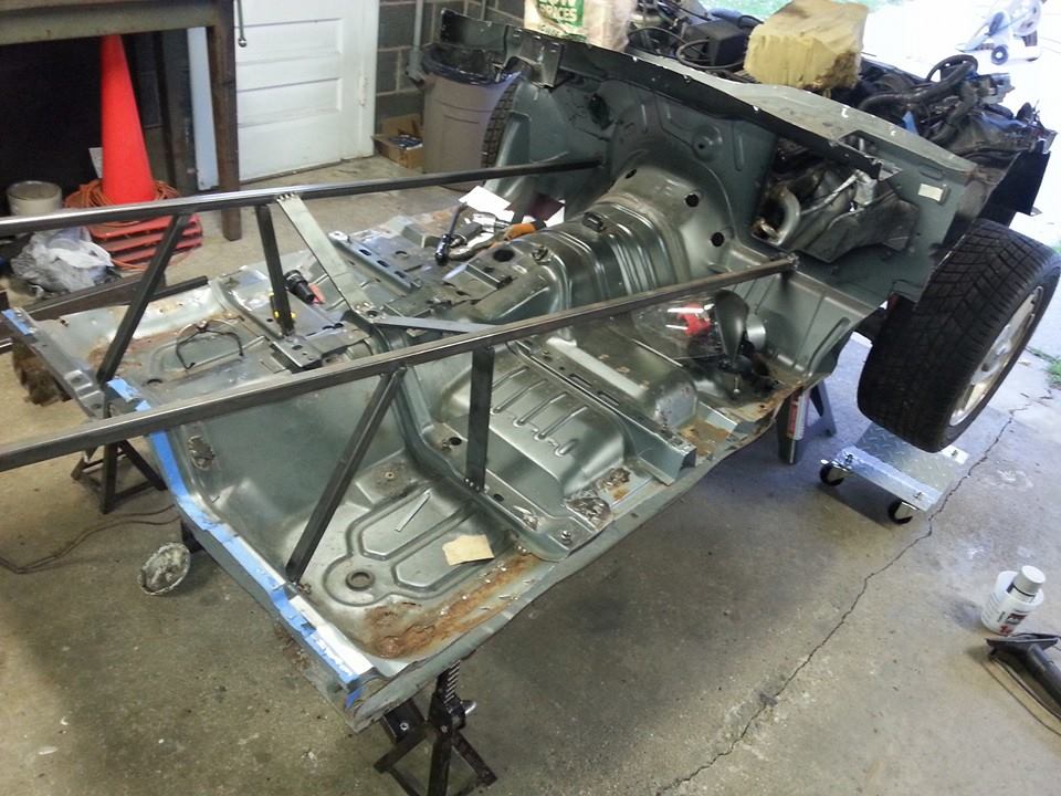

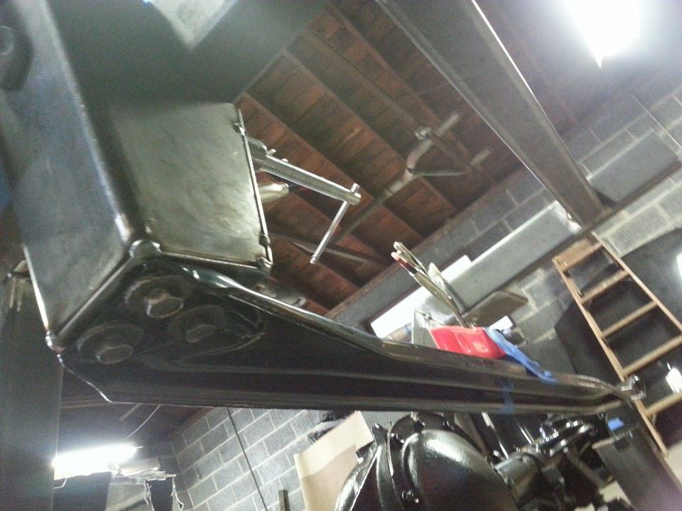

made some more room for the new rear subframe
Re: Beretta Z28
That looks like it's going to be really uncomfortable to drive... LOL ;)
Posts: 1834
Re: Beretta Z28
3X00-Modified wrote:That looks like it's going to be really uncomfortable to drive... LOL ;)
Very safe though! %)
