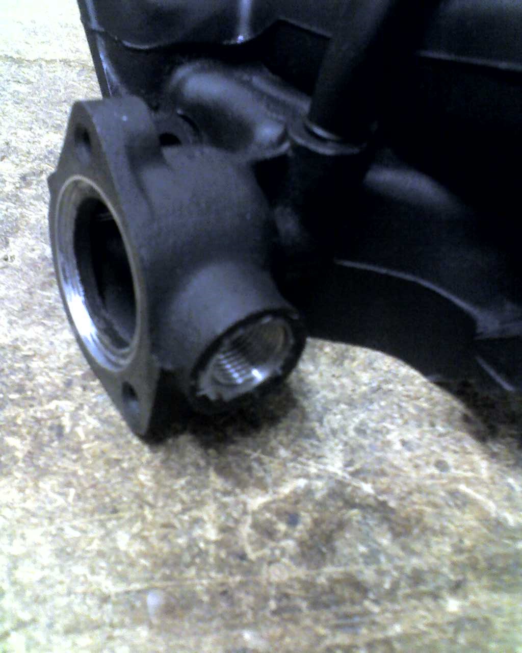

I did a 3400 upper and lower intake on my '95 Z-26 a few years ago. I tapped the water-pipe outlet on the rear of the lower for the Z's heater-core line, I think I used a 3/4" NPT tap, but I can't recall for sure. Doing that will save you some headache later, unless you already have plumbing figured out for it.
LIM tapped for heater-core line quick-disconnect.
Quick-disconnect installed.  I virtually always use Teflon tape on fittings like this.  It never leaked, and I MIGHT be able to remove it again in the future...

What is the exact name for the heater core pipe called? N where did you get yours?
Re: While im doing this.....
Posted: Mon Dec 16, 2013 3:32 pm
by Rettax3
I think it is just referred to as the heater inlet pipe, GM probably has another name for it, like heater supply line, or some such. Mine was retained from the original 3100 'M' code in my Z-26. Generally, I like as much of my stuff as possible to be plug-and-play.
The outlet part pictured above that screws into the manifold is called something like 'the upper heater supply quick disconnect fitting' or just 'heater hose inlet fitting at engine'. I don't recall where I got that, if I actually saved one from an engine (they usually break), or if I bought an after-market replacement. Dorman makes one, no worse than the OEM junk... Most auto-parts stores should have them available, or Rock Auto sells it for $5, part # 800401.

Im having trouble getting this part.. Maybe its how im describing it... My motor is a 3. 4 lumina apv.. The thing that goes into the bottom of the intake manifold.. Where does it goes/goes into from the lower intake manifold?
I brought the silver part that shows in the picture, and my mechanic says i don't need it?
Help here please

If I am thinking along the same line... To heater core at firewall. When you see it and realize it, you'll likely assume what else will need to be done.
Posted: Fri Jan 10, 2014 2:26 pm
by 3X00-Modified
That's because they don't exist on the 3.4's... this is a part that you would tap the lower intake to accept the style that the beretta used so you can re-use the same pipe that was there and not have to modify one to fit like I did.
The 3.4L engines had a pipe that was just slipped in there with an o-ring on it.
