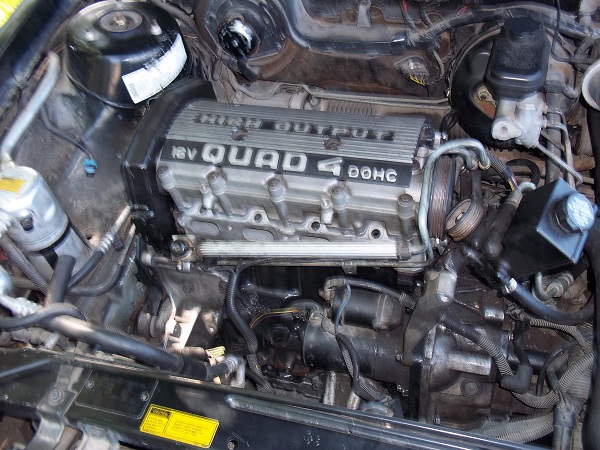

thank you for the welcome and yes it was a preety good deal i only paid three hundred for the bike at a pawn shop but its retail was 900. as for my questions is there any thing i should know about these cars and engine things too check out. also wondering about the noise what is normal my engine is making a notacable tick\knock sound from the head of the engine i hear there noisy engines but what is normal.

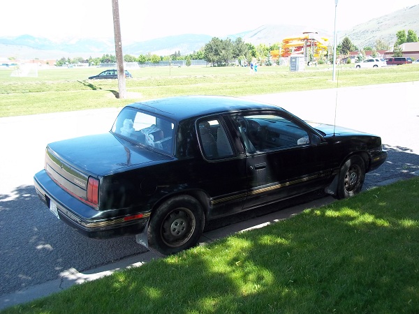

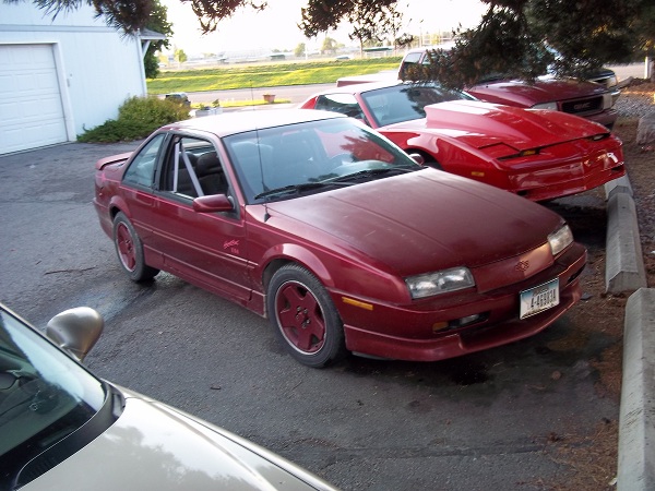

ok finally some pics so this is the beretta i got i love every thing about it but excessive engine noise and the pink heart beat pin stripe down the side any one know how too take that off without damaging the paint. any ways that is the olds quad 442 doner car and the engine im going to finish and put in the beretta.
p.s. thats my pos trans am in the background.

Ticking in the upper end is usually a stuck lifter or the lifters not getting enough oil.UnDerE$t@MateD wrote:as for my questions is there any thing i should know about these cars and engine things too check out. also wondering about the noise what is normal my engine is making a notacable tick\knock sound from the head of the engine i hear there noisy engines but what is normal.
Re: new to site and car
Could you post a video of it so we can hear it? Does it make the noise more, less, or the same when the RPMs go up?UnDerE$t@MateD wrote:thank you for the welcome and yes it was a preety good deal i only paid three hundred for the bike at a pawn shop but its retail was 900. as for my questions is there any thing i should know about these cars and engine things too check out. also wondering about the noise what is normal my engine is making a notacable tick\knock sound from the head of the engine i hear there noisy engines but what is normal.
The pin stripe should just be a sticker. Just buff/wax the car afterwards to make sure it didn't leave a mark on the paint.

3M general purpose adhesive remover... I pulled the stickers off my car when I got it... Even though the paint was coming off. It was also one less thing for the painter to strip off before painting it. And the 3M will not damage your paint, but I suggest trying to remove the stickers in the sun if possible, makes them more pliable, and then if you can use the 3M in the shade so it will have time to soak. If you spray it on in the sun it just evaporates quickly and doesn't break down the adhesive. But that combined with a bondo spreader works great.
