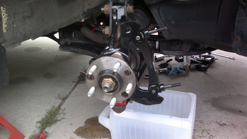

Got the Wilwood kit in today! Mother nature turned on me tho halfway thru so I didn't get to test them out thoroughly. Hopefully tomorrow will be nicer to me. My buddy who helped me took a lot of pics and I'm hoping he'll post them when he gets home. For now I only have this one:

Very clean swap too, I like that crank-trigger setup too. What ECM are you using to run the engine, the original 2.8 computer?
Glad to see the upgrade on the exhaust, that crinkle-bend crap was giving me the shakes! :bad:
And I like that brake setup, I'll bet it doesn't fit behind a 16" wheel though, does it? :sorry:

Thanks! Crank trigger is from britishcarconversions.com, Stock ecm with a burned memcal from Scott0999. I do actually have 2 spare sets of GTU rims, and lastly the kit does fit under 16" rims. Not the GTU rims tho, they have an inner lip that smacks the caliper. The kit is expensive but it's worth every damn penny! The lines wilwood has listed for the cavalier/sunfire work perfectly as well. They may look funny in the pic but the lines actually dont interfere with the wheel or anything else. These brakes are PHENOMENAL!!!
