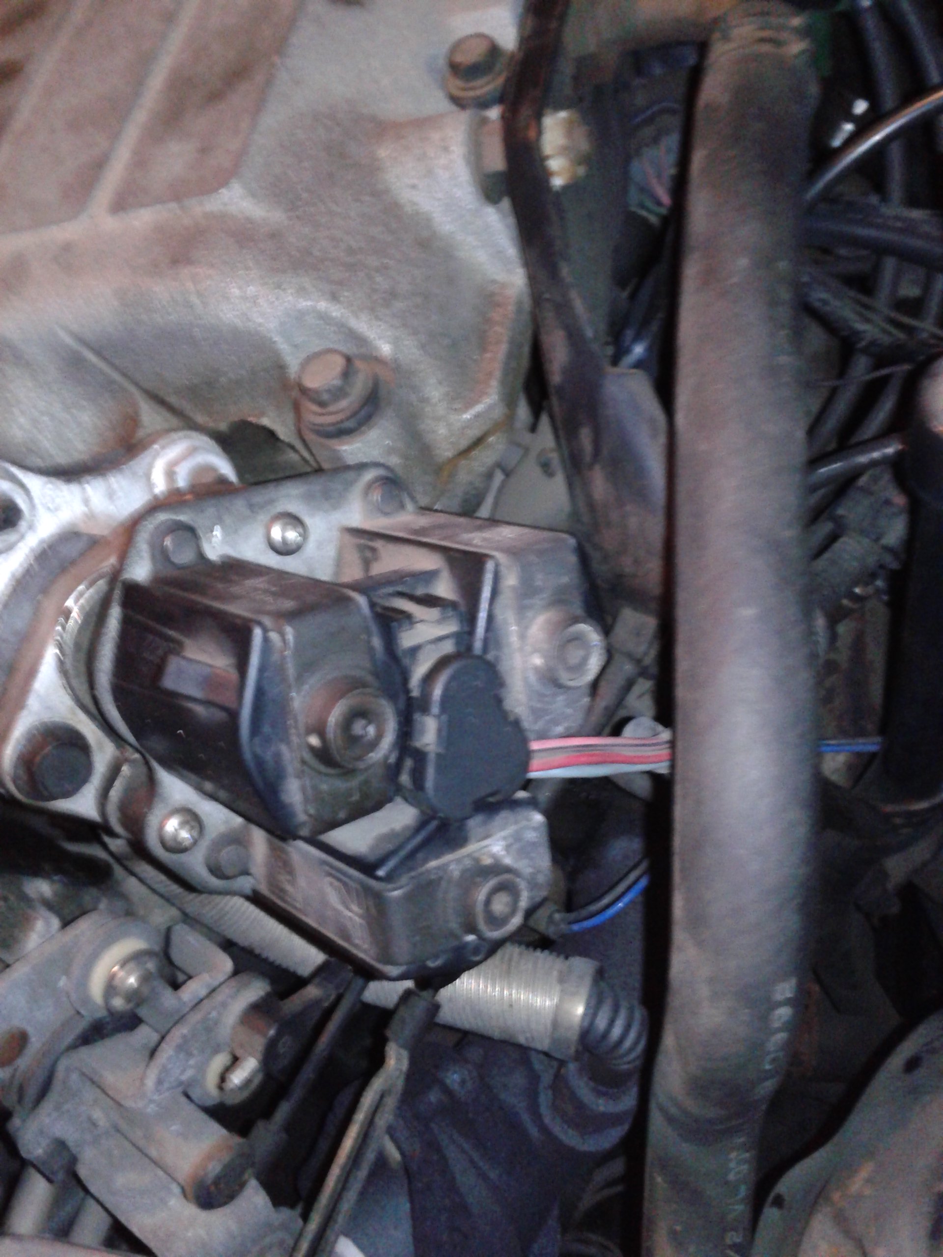

I tried taking the hose off the back of the manifold, which I assume is the one you're talking about (photo included) and plugged it. This didn't change the idle, but instead made the car run rough, so I put the hose back on.

The EGR valve I cleaned I may not have put solenoids on the right direction (I took the whole thing apart). I have included photos. If you guys could, please take a look and let me know if it's on the right direction. While the valve itself is slotted, the solenoids are not so they can be rotated without the right valves being in the right spot on the valve. I put it back with the flat edge facing the flat part of the valve, which I assume was the right way.

If your master cylinder was leaking then the booster is suspect. There is a big hose that goes from the manifold to the booster right next to the master cylinder. Take that hose off the booster and leave it plugged in to the manifold. Once the hose is unplugged you will need to cover the end of the hose with your finger to seal it off. See if the car changes.
