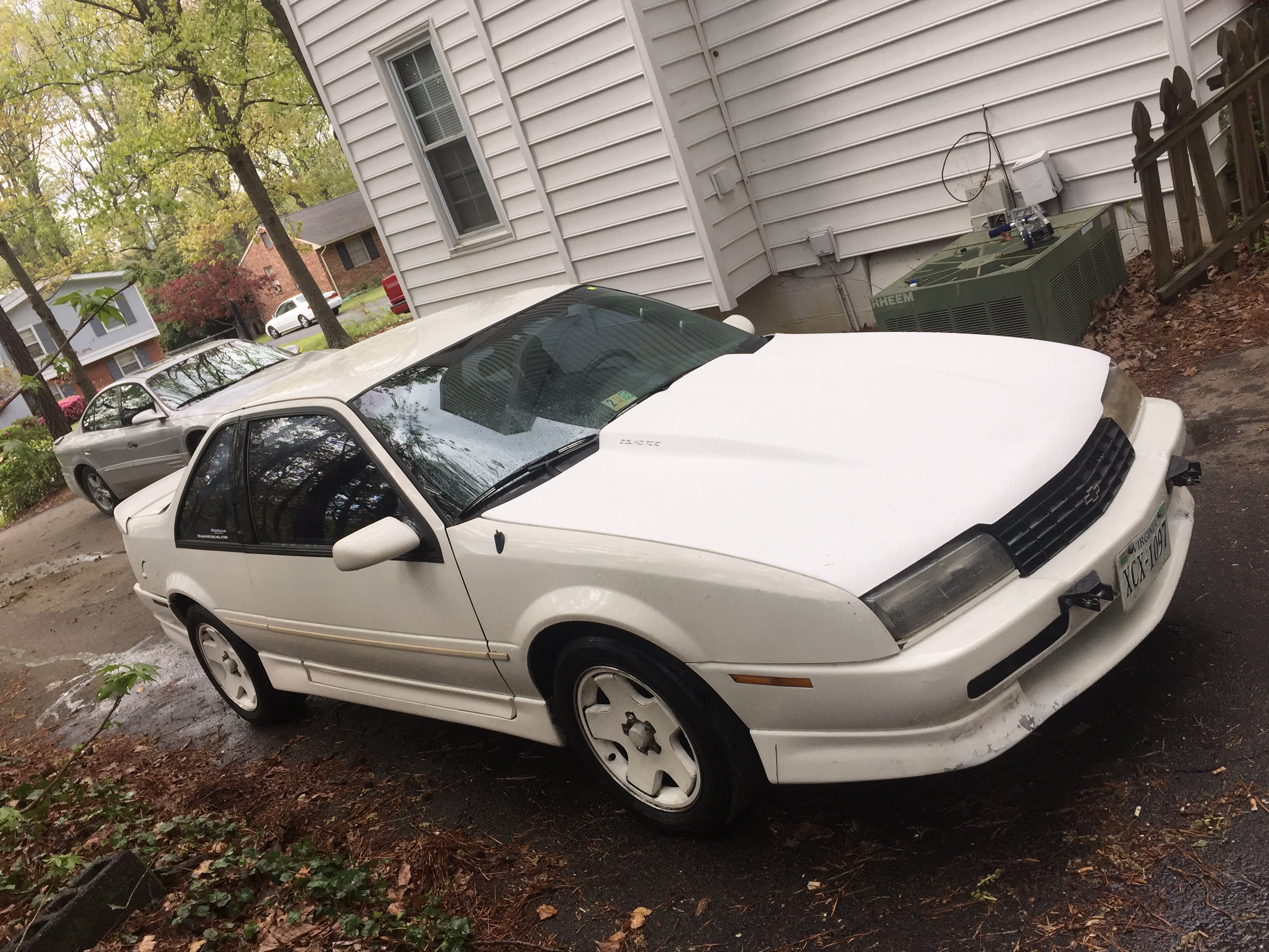

Re: Nukkinfuttz Turbo GTZ
That's a nice little bullet for that car. Are those tow hooks on the front?

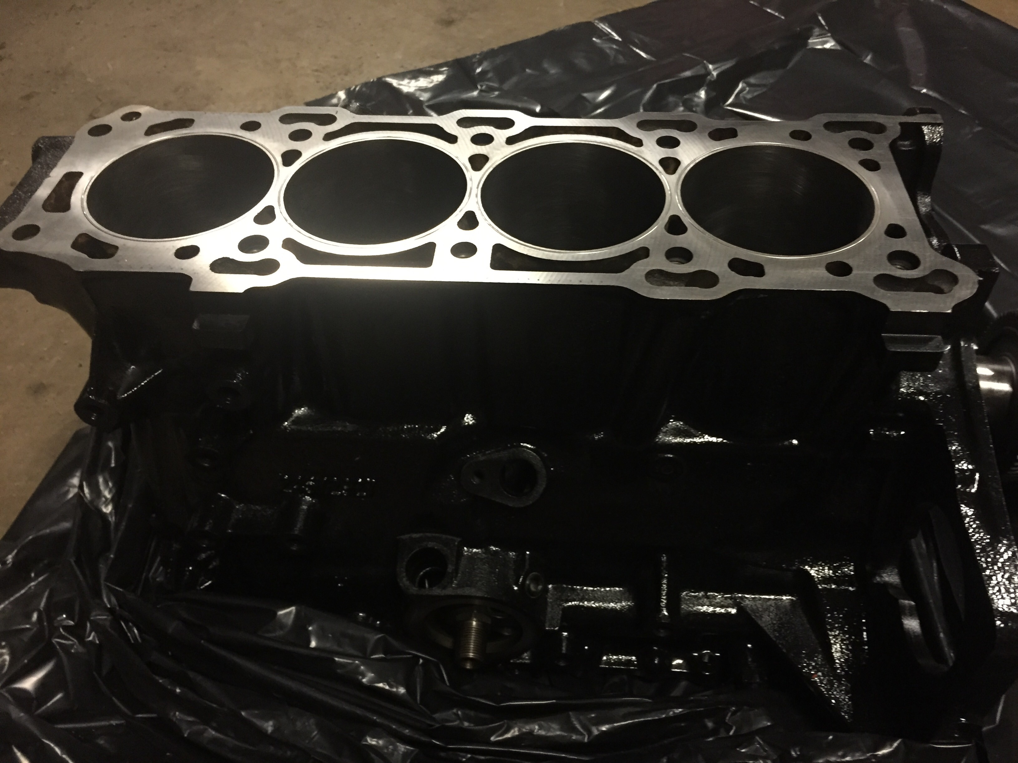

Got it back together with an o-ringed block and copper SCE Titan HG. Took the boost up to 22.5PSI which is the max of my MAP sensor and current fuel system capabilities.

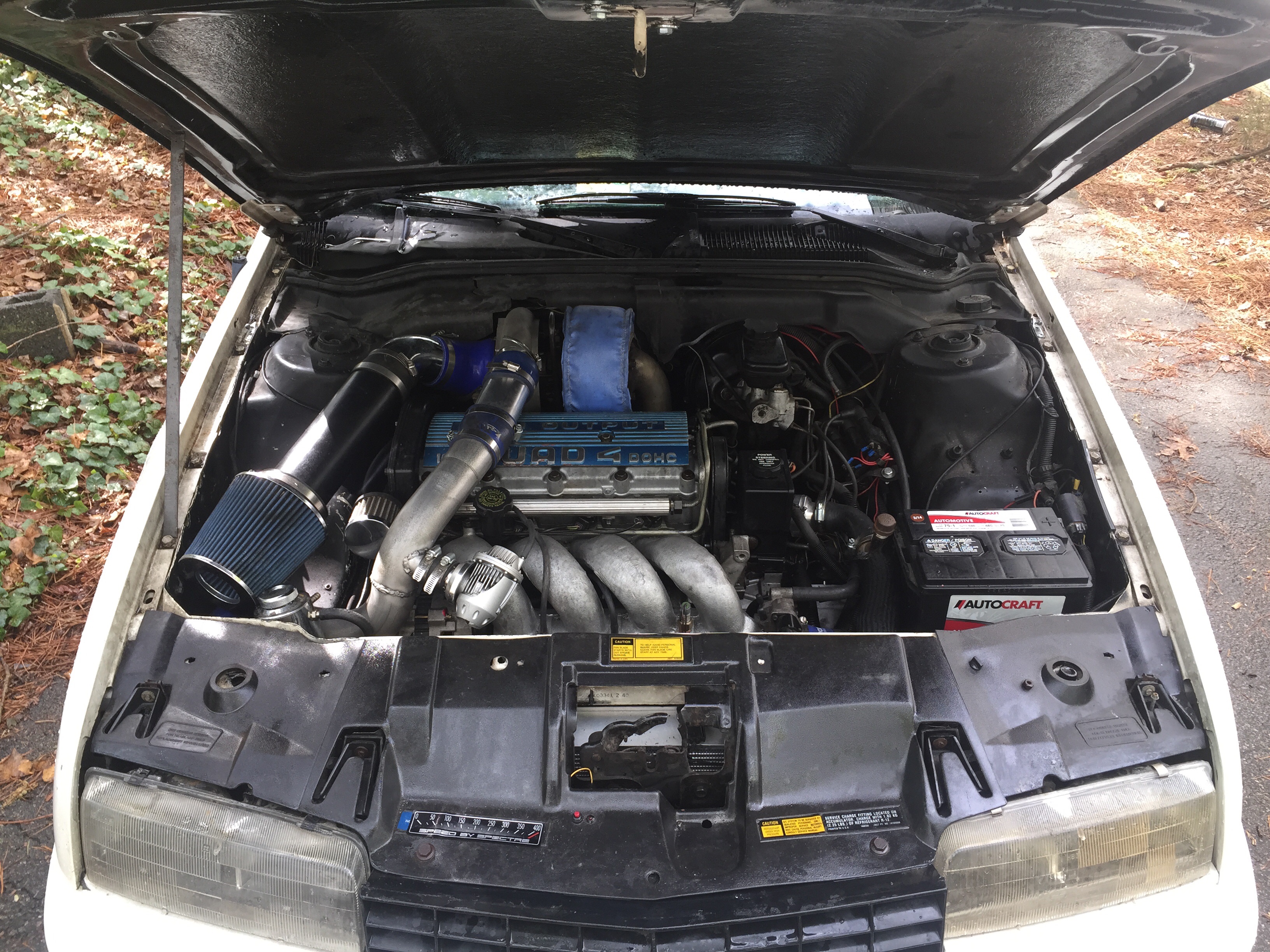

Lots of power coming out of that motor! Squealing the tires on the roll!
A word of caution, if you are going to run 30 psi boost, you have to consider alcohol injection
or some other means of boosting octane otherwise you may "knock" that motor apart!
Some of the guys on the turbo Regal board are running e-85 to help with using more boost.
You also don't have an inter-cooler? That hot boosted air complicates things too concerning more boost.
Good luck with the quest for more power.
