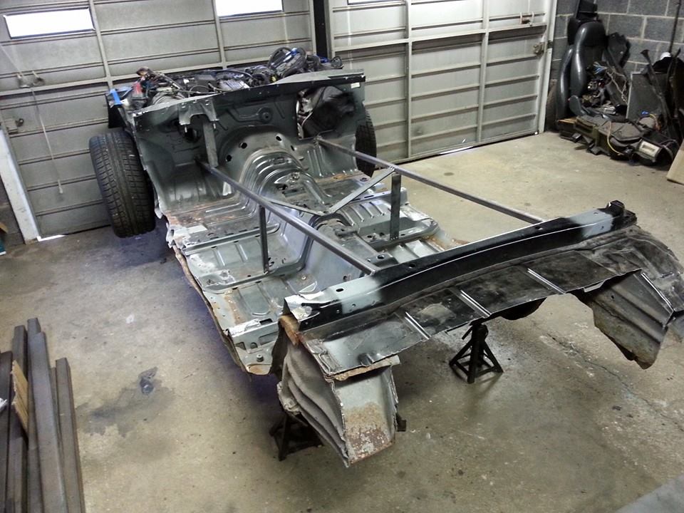

made a 4' by 8' welding table/surface plate. and made templets of the stock uni body frame rail sections from the fire wall back.
Re: Beretta Z28

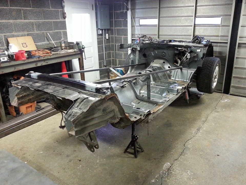

also started rough cutting off the bulk of the what will be un useable unibody sections of the camaro body. lots more to do here.
Re: Beretta Z28

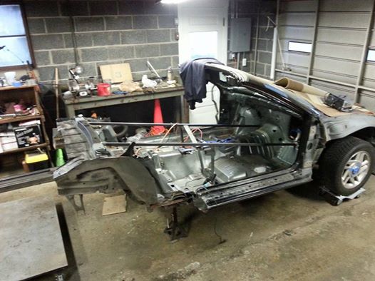

rear quarters cut off and rear frame rails cut off behind springs and panhard bar mount.

Re: Beretta Z28
If your taking the car down this far - you might as well minitub it while you can....
Re: Beretta Z28

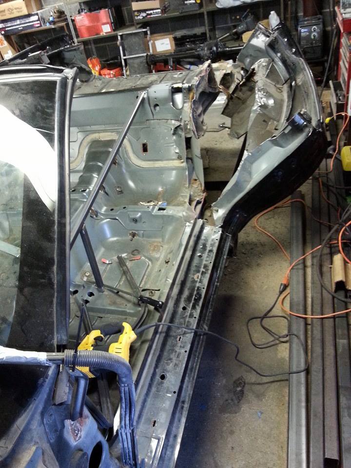

all rough cutting done....time to start construction on the rear sub frame / tube chassis........ mini tubs shouldn't be necessary. there wont really be any rear wheel wells.....or trunk floor for that matter........ so u can almost go as wide as the trailing arms will allow......but i will most likely be sticking with the stock z28 wheels to stay true to theme....more to come!!!!!!!!

Stock 4th-gens can fit 315s, but I'm sure that will change with a Beretta body...bonecrrusher wrote:If your taking the car down this far - you might as well minitub it while you can....
