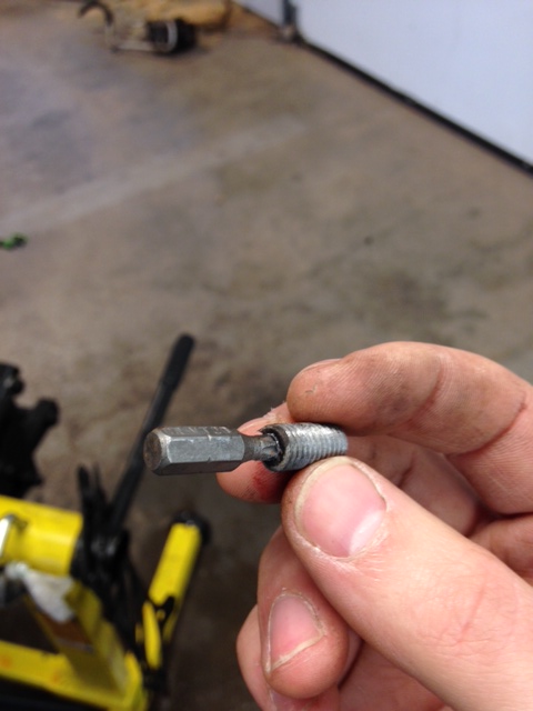

Some updates to the swap project, engine has all new top end gaskets, put together by a dealer tech. He says the inside of the engine looks great, so it should work well for this application. Plugs were originals (ordered a new set), van didn't have any check engine light on at all, GM ignition systems are amazing.
Learned a couple new tricks for stuck/broken exhaust stud removal. Double nut works really well for a stuck one and drilling out the broken one with a 1/8th bit then pound in a T20 torx bit, came out with ease.
