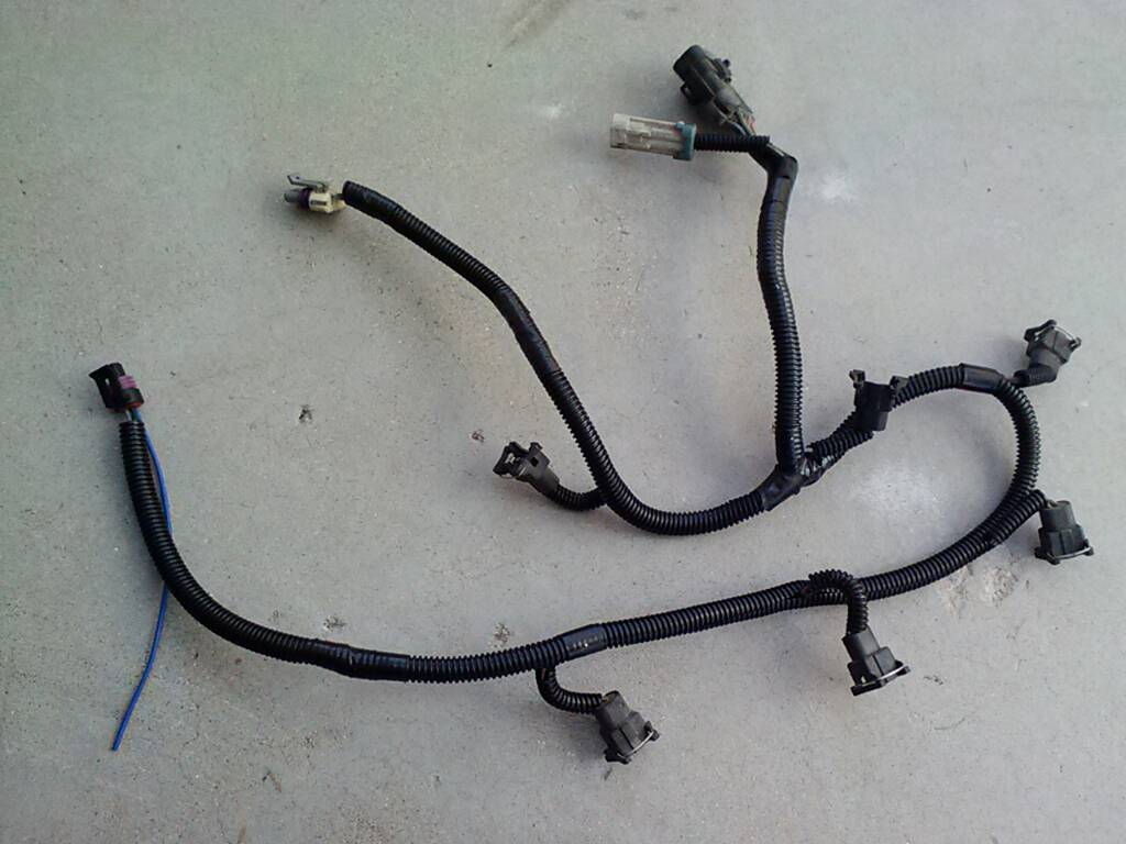

So not much going on, yet again. However, i did get the injector wiring harness re-loomed, the MAP connector soldered in, and the CTS connector 90% installed. Seeing as how i have to use the 3500 sensor and its a 3wire not the stock 2wire, the 3rd wire will receive a weather-tite connector to plug into the stock gauge wire on the firewall side. This way, everything has that stock appearance

Pic of the nearly completed injector harness. I now have a weathpack connector on the gauge signal wire from the CTS.
I am going to be re-looming the CPS harness to the coil pack and getting that attached as well. Dont think theres much of anything left to do but install
