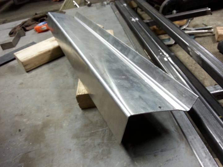

Put together a sheet metal brake with some 3.00 $ hinges and some scrap 1x1 square tube. Made some test bends and think its gonna be great for making some quick panels for the build and what ever else...radiator shroud and wiper cowl coming soon

Finished the radiator shroud/bracket

Fast progress and you sure don't take breaks! Can't wait to see the brakes all complete with the suspension.
Re: Beretta Z28
Thanks 88gtu. Gotta keep pushing. .....winters coming soon .....gotta get some heat in the garage if im gonna work all winter in order to be on the road in the summer.... ......as for the brakes and steering/suspension mods might wait till the car is on the road before upgrading ........focus on getting it running and driving .....then upgrades

Nice sheet brake!
