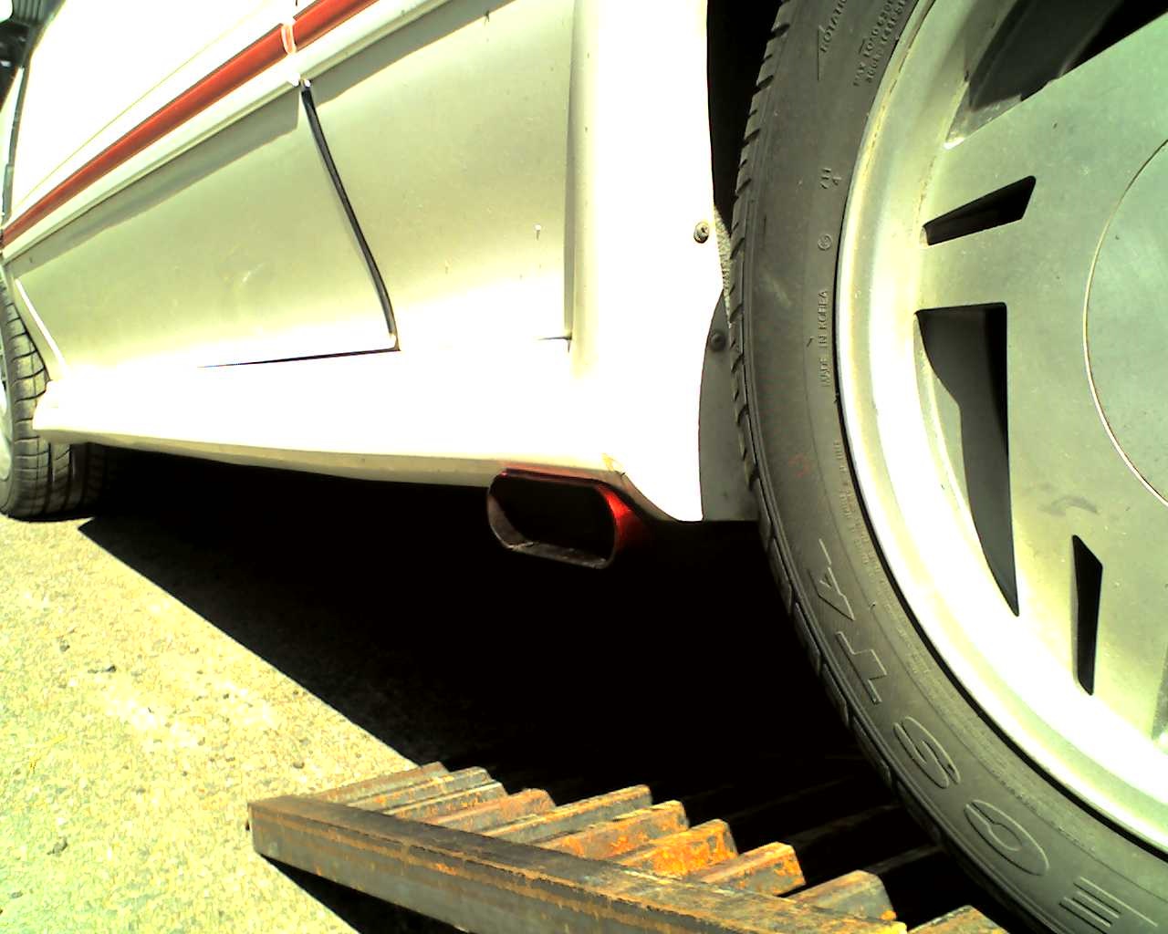

Thank you, that was actually the EASIEST swap/conversion I've ever done. It is tight, but fits well. Only permanent mods needed to the car are two holes in the right subframe, although I also added in the two-speed fuel pump control (not necessary, but nice) which also required cutting a ground-wire to the pump, and the side-outlets for the exhaust required trimming the ground effects, which were cracked in that spot anyway. In many ways, the 3800 fits the Beretta better than a 60-degree engine does -for instance, the heater-hose outlets are actually at the back of the engine, so i was able to delete the pipe running half way around the engine-bay...EPfiffner wrote:Wow, I can't believe you crammed that blown 3800 in there, I saw it in your sig, but I hadn't seen a pic. Impressive.

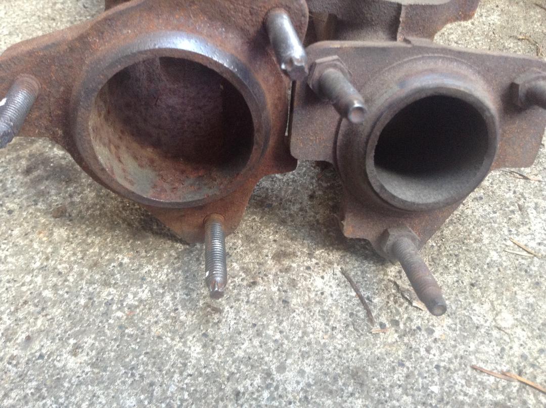

Got some serious exhaust work done today, just not much of it!
The new manifold arrived the other day, so I got the prep work done on it. I also thought some people might be interested to see the difference between the 3.4 TDC and the 3X00 exhaust system. This is why I haven't been aching to build headers for this thing -no need.
Flipping the manifold is a cool trick -can't do that with a 3X00! On the other hand, you don't have two totally different heads on a 3X00 either...
It is all about trade-offs... There is still some more casting-flash I want to clean up while I have the manifold off. The castings are a bit thin, IMO, so I won't be grinding any more out of the ports. Unless I ever pull the heads and port these things out, these manifolds will be plenty sufficient for me.
