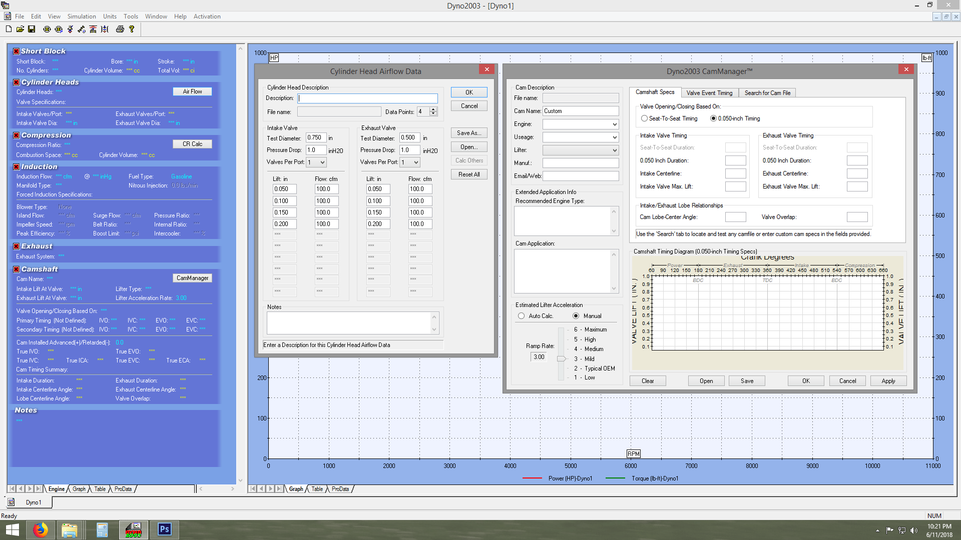

I really don't know on that. But here's a screen shot of the info you need:

Okay let's see if I got everything that's needed (probably not). The stock CFM is 233, CR would be 10.5:1. The cam timing would be 0 as I haven't gotten that far in the process. And here are my can specs :
Duration @ .050" : 206*/206*
Lobe Seperation Angle: 112*
Lobe lift: .313"/.313"
Lift @ valve: .501"/.501"
Hopefully this can be useful if something's wrong or missing let me know

Lots of info still missing.
Bore and stroke?
23cfm on the head? At what lift? The more lift points the better. What size valves?
How big is the throttle body? I can figure cfm of that from there.
Those cam specs should be good.
Bore and stroke?
Re: Dyno simulator
Bore is 89mm stroke is 88mm. TB size is going to be 56mm. I can't find the cfm at the specified lift apparently and I wouldn't know how to try and calculate something like that.

You'd either have to measure it with a flow bench or find the info online. Unfortunately, there's not much sense in doing the calculation without accurate flow data.
