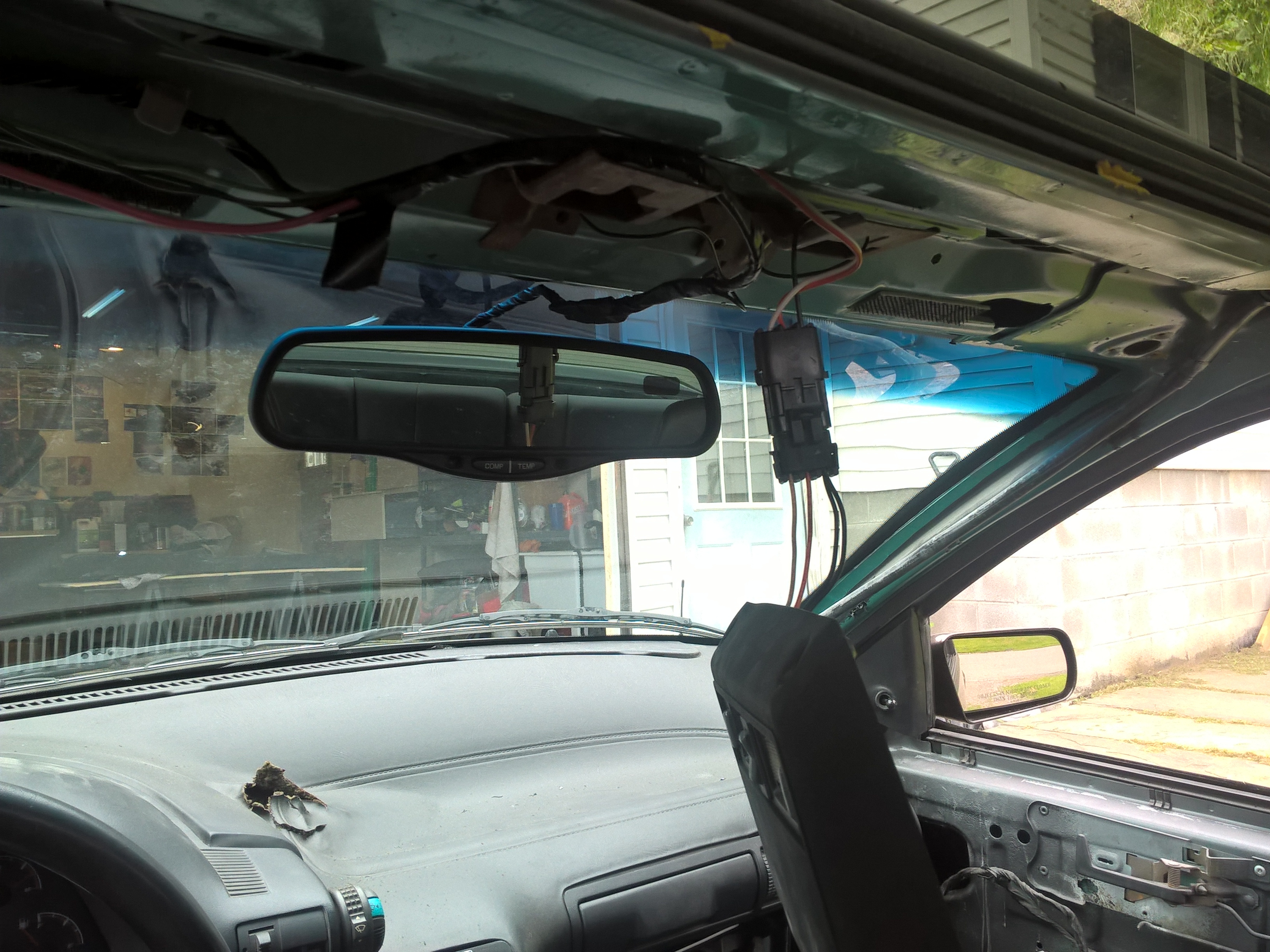

Well, the bracket itself wasn't too bad to install. The original ground for the rear view mirror map lights located one of the holes to get it started. It did require a bit if cutting to the headliner... and of course, my 25 year old headliner adhesive decided to fail all over the place when I touched it... lol. Hopefully some Super 77 will do the trick overnight.
As for the wiring - The ground is pretty obvious but it also appears there are two +12v wires going to each bulb. I assume one is for a switch and the other is to activate the bulb for courtesy lights when the door is opened? I gave it +12v to test it and the switched side worked but when +12v was applied to the other, the bulbs lit up very dim. I tried my LED festoons and they worked great aside from being clocked 90* the wrong way and they wouldn't activate at all using the courtesy wire... Not sure what to make of the courtesy wire... any thoughts?
DanteGTZ
Posts: 768
Re: Adding the overhead console?
Post by DanteGTZ »
Forget some reason these LED festoons (tested fine) don't seem to work but the Incandescents do. As I understand it, the black and white wires are grounds (switched) and the orange is constant +12volts. Ideas?Image

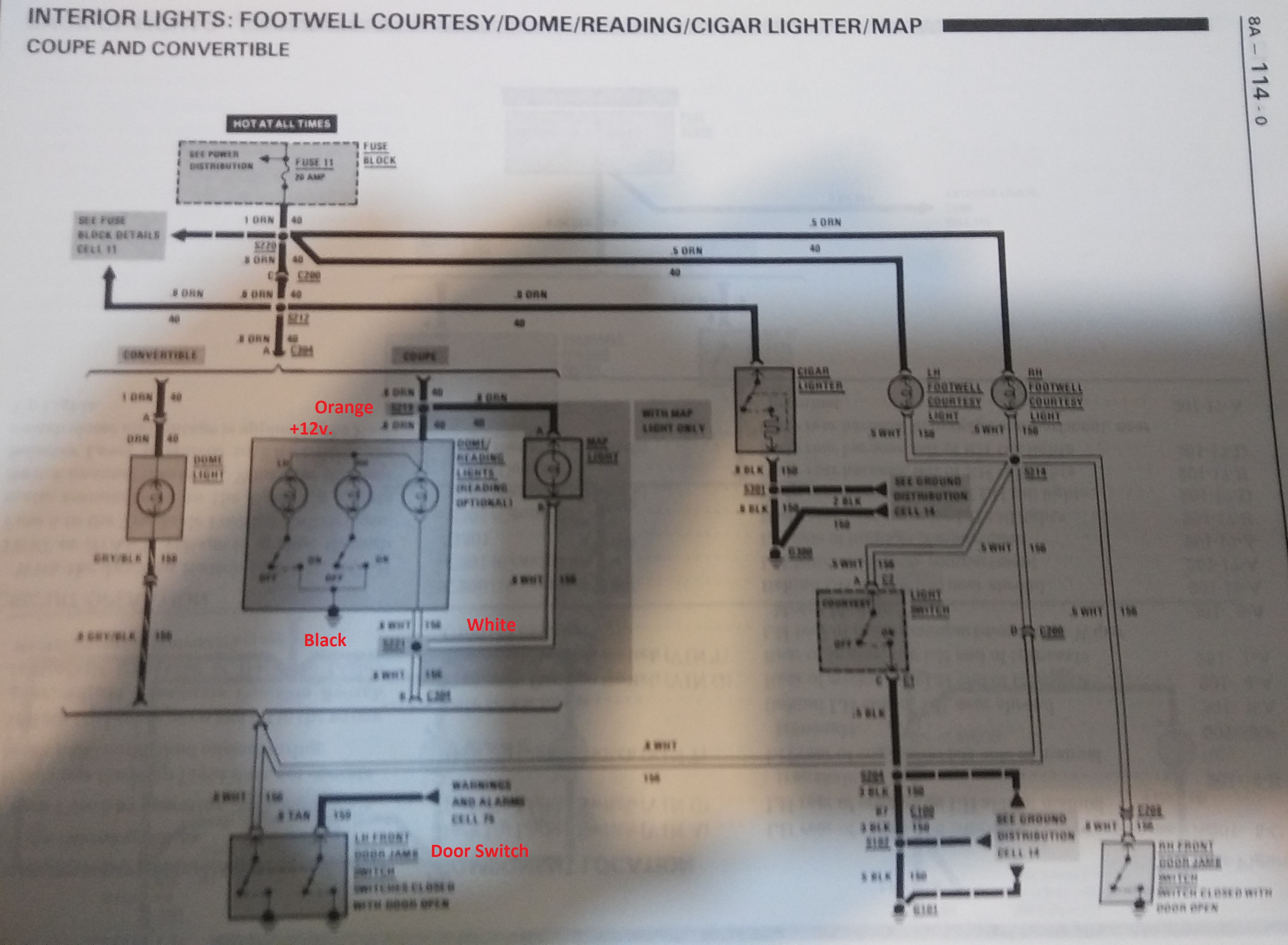

Orange wire: Always +12 volts. Can use dome light positive for this, Connect LED Positive sides to orange wire.
White Wire: Interior lights, switched ground (Door switches), Can use dome light negative for this.
Black Wire: Always Ground, connect to battery negative (or Car Body).
I think I'm a little late, but I hope this is helpful. :)
Photo from 1990 GM Service Manual:
