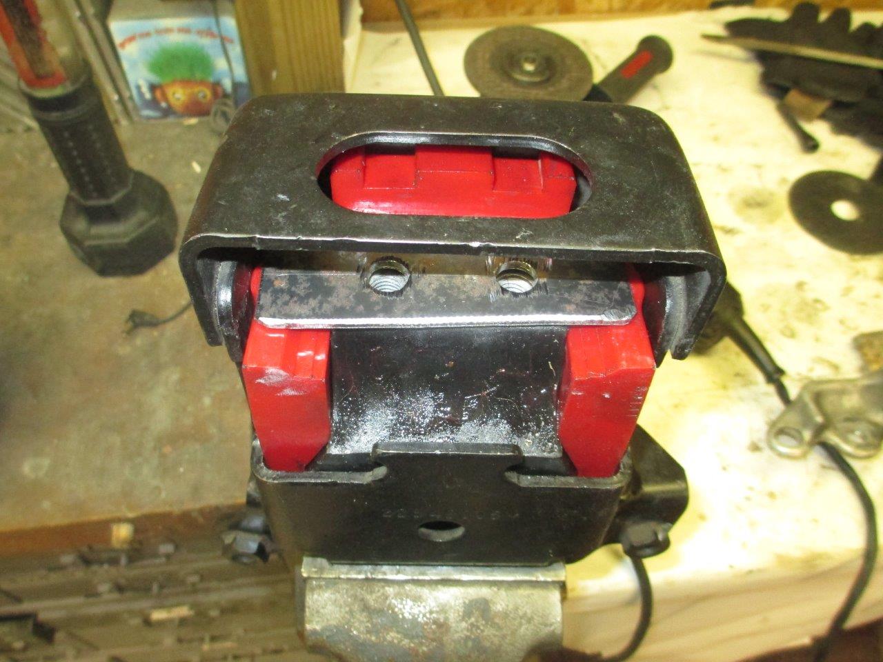

This past weekend along with some maintenance, I had to check out the front motor mount. I could tell something wasn't right ever since we took it in vacation.
I had replaced the mount last winter so it's only got maybe 8k miles on it.
Once I had the car jacked up I could see the front cradle was riding in the subframe: there's my rattling.
I thought the cheapass China mount may have broken , but I pulled it out and it was fine, it's just that the countersunk Allen bolts on the bottom had worked loose. I fabbed a thicker shim for under the mount (looked like the bolts could be bottoming out).
I figured now's the time to install my RK Sport poly insert too.
I didn't install it in the first place because it took like 2 months to get it. Something went wrong with the order, but they got it to me eventually after I had already put the car back on the road.
I fabbed a plate out of scrap steel I had laying around to sandwich between the aluminum wishbone and the poly insert, with the intent of keeping it from riding up in the steel housing. My car is a '93, apparently at some point the mount was redesigned so this doesn't happen.
The insert is a tight fit, which is nice. I greased up the rubber oem mount and then the poly insert slid in with some persuasion.am
Here's some pics. So far so good, it certainly stiffened it up, it transfers more engine vibration but I'm ok with that.
