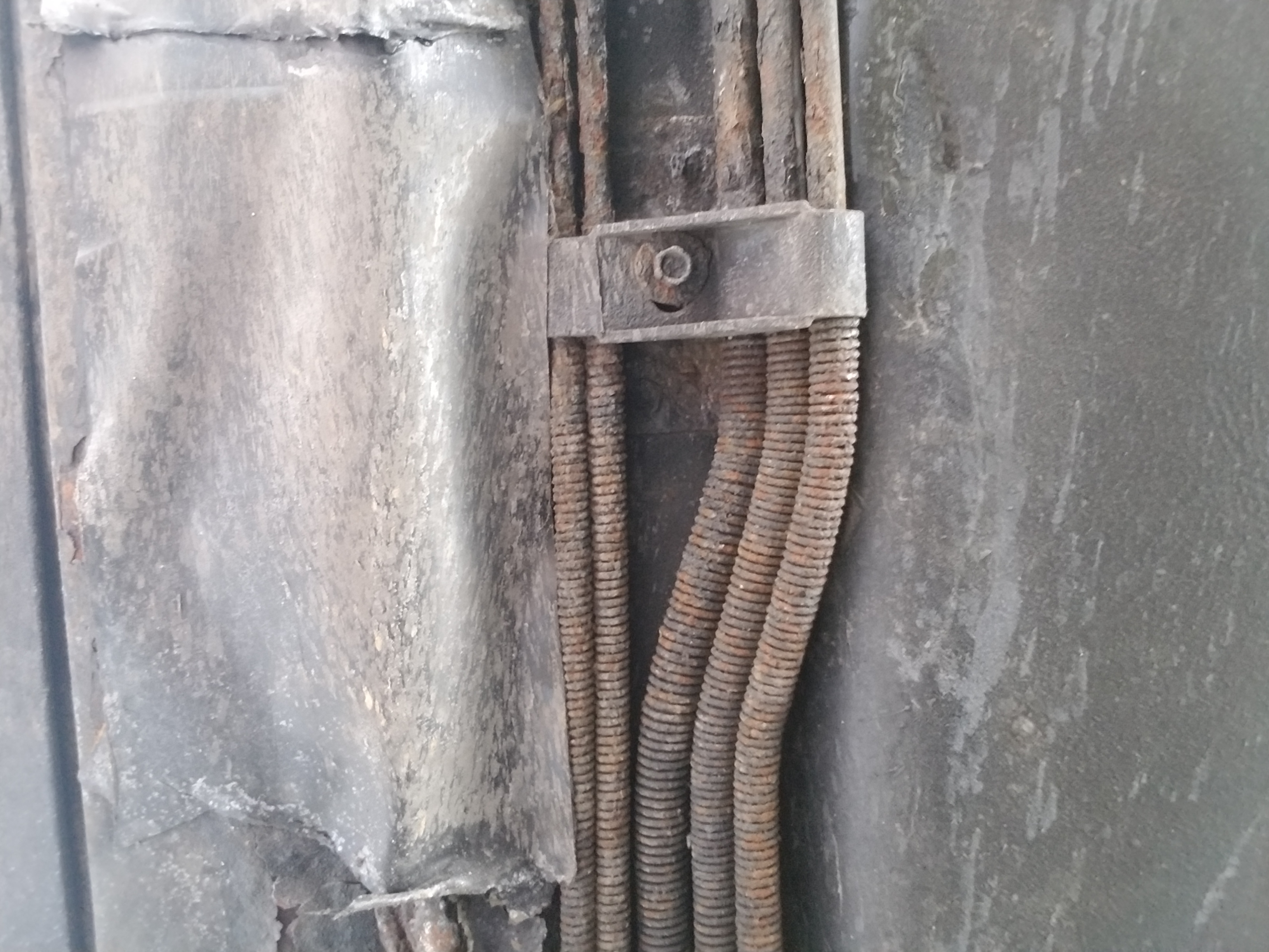

Unfortunately yes, it's not bad. There's just a 2 inch by like 6-inch hole on the driver side frame rail where the jack point is. When I was jacking up the car to do my suspension, it was kinda collapsing, and when I tried to do it again, the entire car fell a bit when it gave out. You can just poke it and it falls apart. I actually used some flex tape to cover the hole to avoid getting a bunch of salty road water in there and rotting it more. The rest of the car isn't bad, but I would love t get that fixed, but don't have the money. I live in Allentown Pa, and the previous owner also lived in PA, so its a PA car. So its rust and pothole central up here. From what I found out, it seemed like the guy bought it new when he was in his late 50s I think, which was actually his second Beretta, and drove until he died in April of 2017, then I got it in May of 2018. At least that's what I think as I found the card in the manual with the guy's info on it, and with a little bit of googling found an obituary for him. It makes sense, but I'm not sure if that's the real story, just what I think it is from the clues I found. I'll upload some pictures later if I remember, of what it looks like.

Here are those pictures I discussed. Some show the frame rot and the others show the rotten control arm. Not good.
Re: The Z26 you all wanted to see
This is why I URGE people to get under a car before buying it. Any rust and rot like that in the rocker area indicates the car will probably continue to rust out and you won't be able to stop it. That is a very bad area to have rust and to stop it since it's the main structure of the unibody. Best of luck with it, but sadly this car will have to be laid to rest in the near future. And it will definitely continue and quickly if you are daily driving this car in the winter road salt.

3X00-Modified wrote:This is why I URGE people to get under a car before buying it. Any rust and rot like that in the rocker area indicates the car will probably continue to rust out and you won't be able to stop it. That is a very bad area to have rust and to stop it since it's the main structure of the unibody. Best of luck with it, but sadly this car will have to be laid to rest in the near future. And it will definitely continue and quickly if you are daily driving this car in the winter road salt.
It is unfortunate, and such a shame as the car otherwise is perfect. Is there anything I can do other than cutting out the frame ad replacing it to atleast slow down the rust?
Atleast this will make a good parts car when it goes. And when it does, I plan to find another beretta. Maybe a convertible. I think those look awesome.
You'll never find a convertible, they weren't sold to the general public. The only way to slow it is to cut it all out and replace it and hope for the best, but that is a very intricate section of the unibody so doing that will be quite difficult. Many parts meet there and are spot welded together and overlapped so unless you are pulling it apart layer by layer it will be hard to rebuild.

3X00-Modified wrote:You'll never find a convertible, they weren't sold to the general public. The only way to slow it is to cut it all out and replace it and hope for the best, but that is a very intricate section of the unibody so doing that will be quite difficult. Many parts meet there and are spot welded together and overlapped so unless you are pulling it apart layer by layer it will be hard to rebuild.
Alright, forget the convertible then haha. But what if I got some rust converter paint or evapo rust and coated it to try and destroy some of the rust, then like rivit a piece of sheet metal on to block the hole. Would that be a good idea or more of a pain and mess than its worth?
Posts: 4754
Phew...that thing is screwed. Now it reminds me of my old Z even more! Sadly I had to put it down due to cancer. 3X00 did on one of his cars, too.
It could be saved, but it would be a ton of hand fabricated work by someone with some skills. I thought about that for my car, too, but decided it would be cheaper, and a better end result to replace the shell and build a new car with a bunch of my Z26 parts. So 10 years ago I cannibalized the black Z and still have the new car. Couldn't be happier with the decision.
