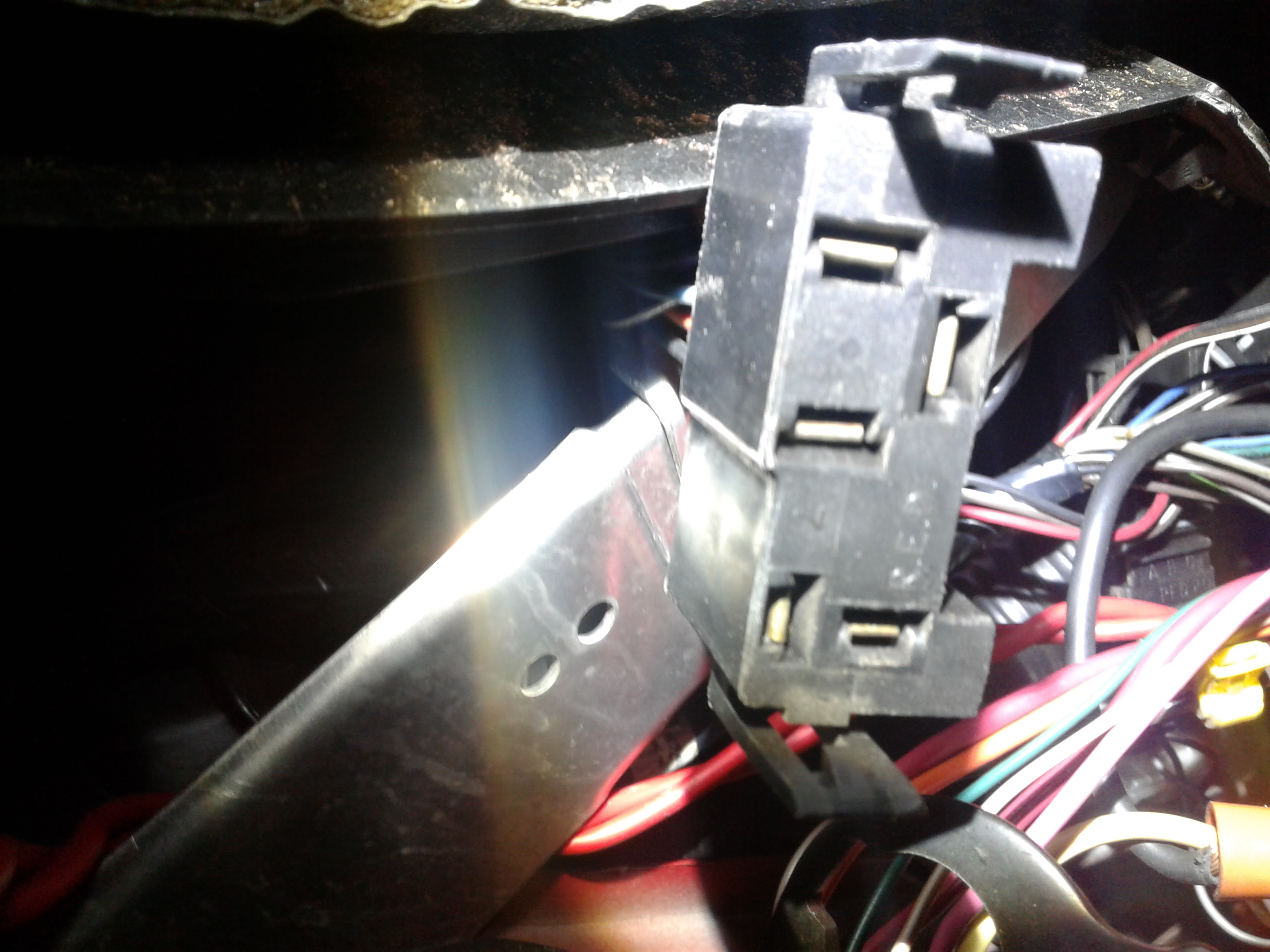

Your fuel pump is energized by either the Normally Open side of the fuel pump relay that I mentioned (orange wire, this gets power from the fuel pump fuse) or the Normally Closed side of the relay (red wire, this gets power from the computer for a few seconds during 'prime' mode, or from the test-lead near the fire-wall if you hook power into it). This power goes out from the relay (grey wire, some cars used tan instead) to the pump and powers it. Also supplying power to the pump on that grey (or tan) wire is the oil-pressure sensor on the front of the engine -basically if there is enough oil pressure, it will activate the pump that way.
If you run a power wire to the red test-lead connector, the pump will run continuously, whether the engine is running or not (not a good idea, old or cheap injectors can leak a little, and you could end up hydraulic-locking the engine or even starting an engine-fire) and if the power isn't shut off or disconnected, it could run until the new pump is fried or your battery is dead. Check the fuse and the relay, that is probably where your problem is, and if it was the fuse, make sure you find out what blew it -probably the old pump, but maybe not.

Relay under steering
