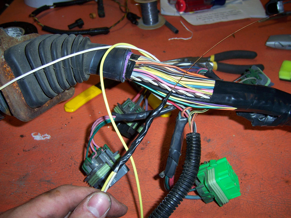

Cut it 2 inches back from the connector just to leave some extra if you ever want to hook up a 0-5v tach setup.
Pull the wire back through the passenger side firewall connector.

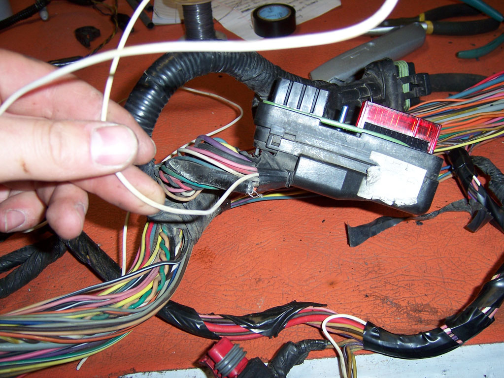

Pull it back to where the wires for the ICM come out of the main harness.

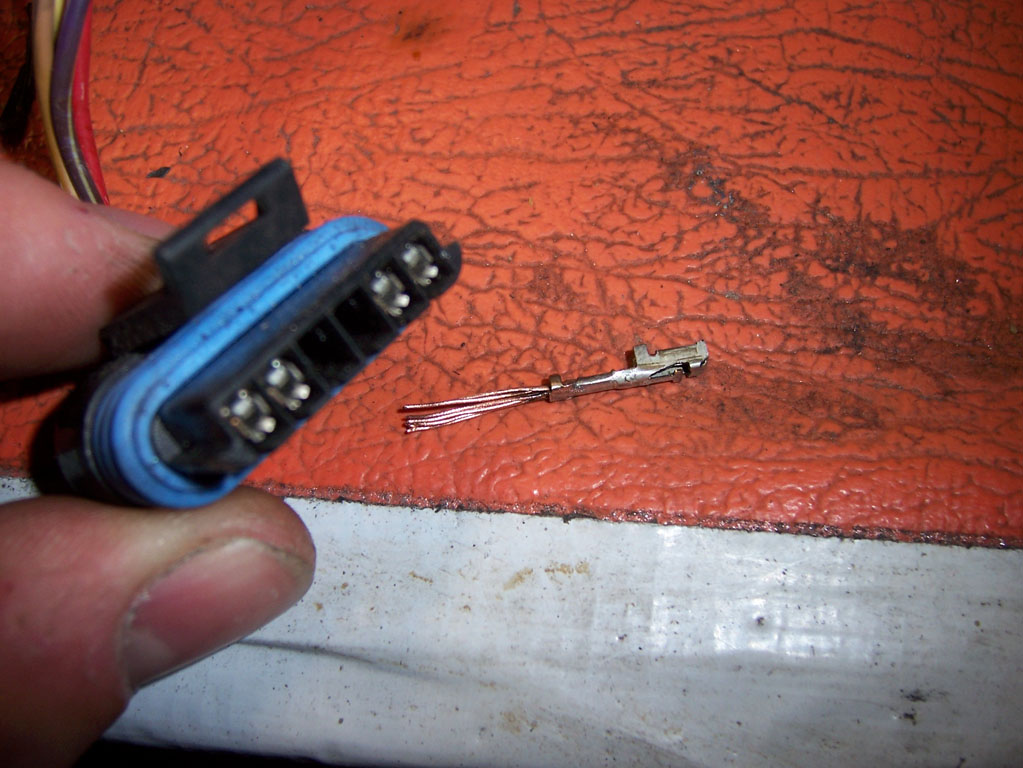

Pull a connector from a un-used connector you have lying around, remember it has to be the same type of pin, TPS, Crank position, IAC, and a few others are all the same, I cut up a old crank position connector to get the pin out of it.

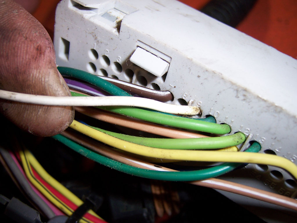

Cut the white wire on the driver's side body harness connector, PIN G5 AKA top row second from left, Looking at the back side of connector, as pictured, (natural wire curve aiming down)
Pull this wire back through the harness to the ABS ECM plug.
Stage this wire there for now.

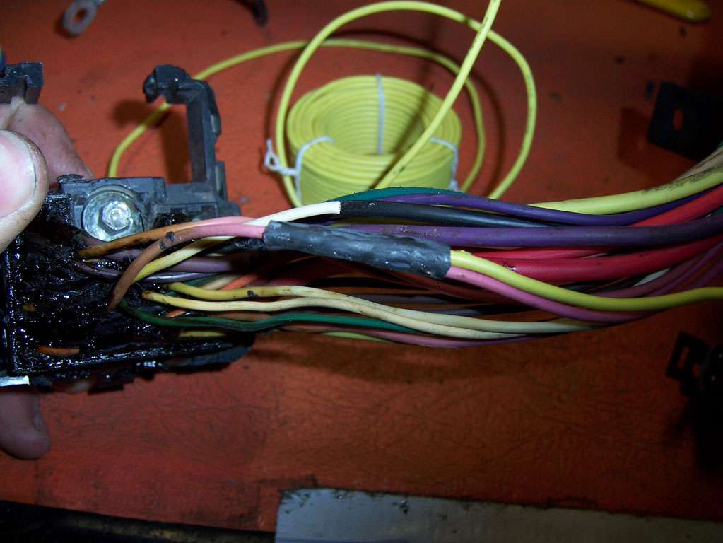

Route them over to the rectangle body harness connector with the blue and red clips on it.
Now cut the wire at PIN P giving you enough wire to work with on either side.
Now solder the corresponding wires to the ends pictured here. White wire is the ABS plug wire, this goes to the connector side, and the yellow wire is the new one that I ran from the driver's side, this one goes to the harness side, going back out to the engine bay.
