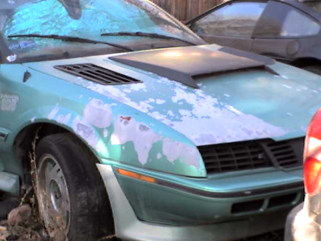

Okay, until I get it back together and back on the road, I really can't say too much. But, as the current owner of the only N* Beretta I've ever seen, I can say a little...
The car is a teal Indy, original 5-speed digital car. When I first saw it, the builder had it put together well enough I thought is was stock at first. I wasn't too into Berettas back then, but it was a decent build-job. Some years later, it has fallen into serious disrepair from lack of use and other issues. I got the car in trade, and it seriously needs some work to be back on the road. Technically, it is not a true N*, because it is the Aurora L47 4.0L, like Weba mentioned (he is my Beretta hero, have I mentioned that yet?), but it is still a 5-speed.

I only have the old pics of this, from when 'GTiIndy' owned it, when it was being taken apart for rebuild. Actually, it looks worse in the pictures than it did in real life, but yeah, the car won't win any beauty contests right now.
The body was straight, and the only rust was minor surface-rust where the paint had been peeled-off for too long. He said he saved this car from the scrapper, it was already in the junkyard ready to have the catalytic converter removed, and fuel-tank punctured when he saw it, and talked them into letting him buy it for like $300 or $400, and that was more than a couple of years ago, too.
Unfortunately, when I got it and towed it off, some bad things happened to it... He had warned me that the car had been partially disassembled, but I didn't realize the front hub-nuts were off, so when I rolled it back from the trailer, the front wheel (driver's side) came off with the outer hub, and crunched the fender. Then, the insane winds we have at my house blew the top ten feet off of a seventy-foot-tall pine and hurled it almost thirty feet to land on the back of the Indy, where it dented the quarter-panel next to the trunk-lid.

Indy, a lump of compressed carbon in the rough
