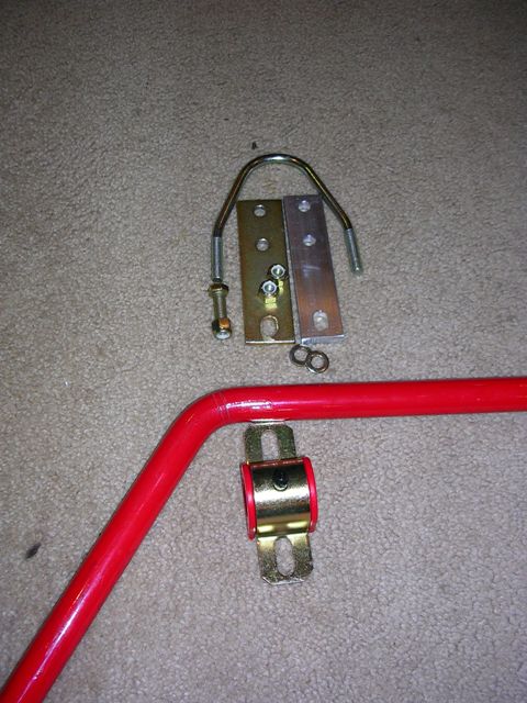

I put the same bar on my 95 without shims. You get a little bit more ground clearance that way too. I just called Addco and they sent me another pair of the inner style brackets & plates for free...
Here's an old photo:
Re: ADDCO REAR SWAY BAR
Looks simple enough, Just have to use some flat stock and a drill press.
I'll just have to precut the length of 3/8" flat stock and wait until I get money to make such modifications
Those would be shims woody, just thinner than mine.
- Posts: 4778
Ok, that was poor wording on my part. What I'm getting at is...Addco will supply you with everything you need and you don't have to fabricate anything. Just give them a call.
