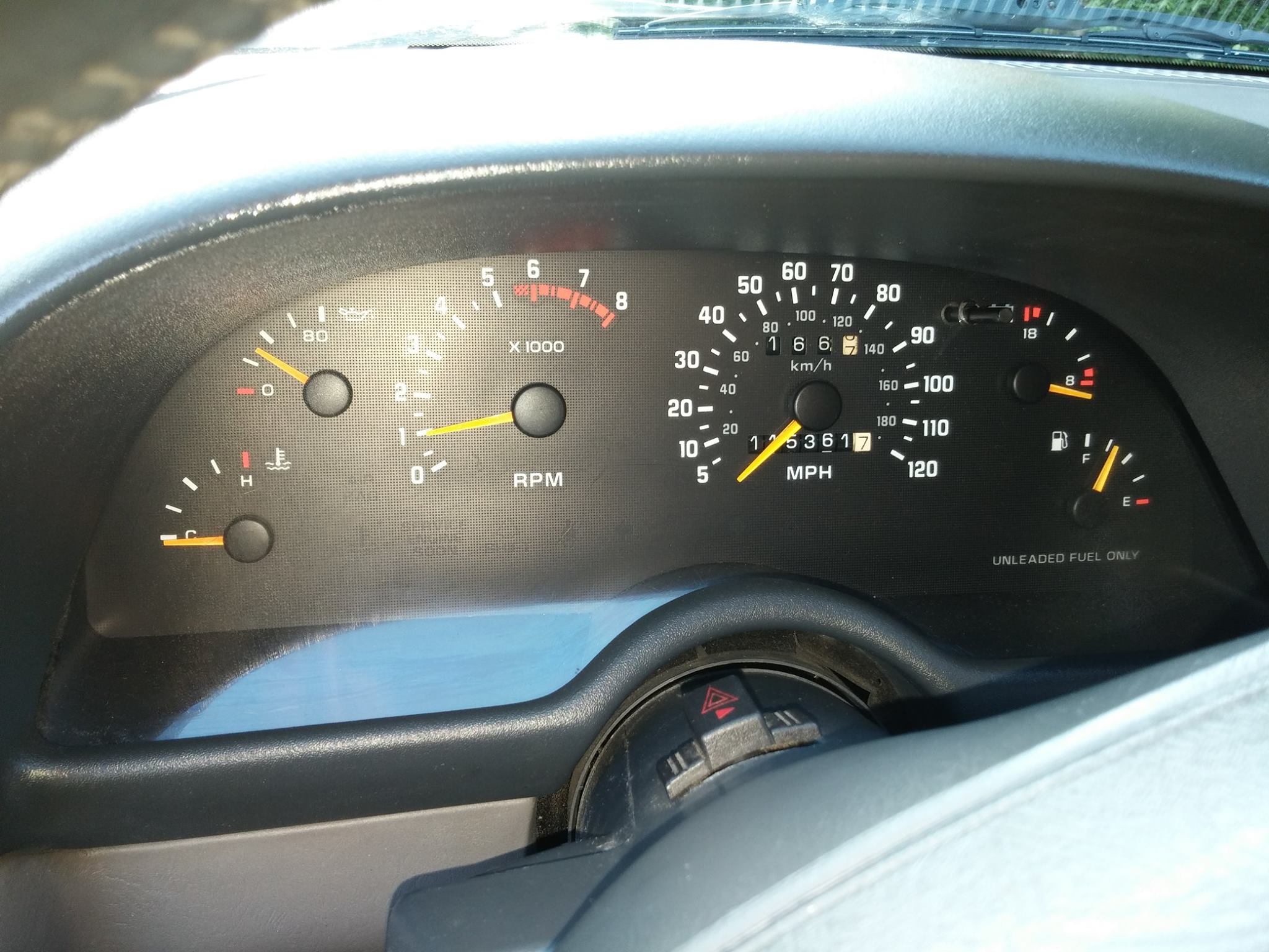

The easiest way would be to buy a 96 Beretta OBD2 factory tach cluster and swap it into your vehicle, then buy the Oil pressure sensor for the gauge (not the light) and swap that in, the odometers are swappable too however the speedometer dial needs to be removed to get the odometer out of the tach cluster. 99% plug and play.
Just make sure it is a 1996 OBD2 3100 v6 auto cluster, if its the 4 cylinder or 95 and older it will not work.
Here is a photo as an example of what a factory cluster looks like:
