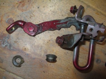

1993 Beretta GT, looking for a door check strap, drivers side. I found a p/n 22576022, not sure if its correct. The website also led me to believe that it fits either door, not sure if this is true or not. If someone has one they would like to part with, I would be happy to purchase it. Thank you.

I bought one of these. I think they have been updated from the one in your post.

The ones you posted are for the older years... What he posted is 93+ style... not sure which is superior tho.

You are right, my 96 does have different link than the 88.

Thank you both. I am going to try the older style because, as you can see, the existing one is basically exploded lol

So both styles fit all year doors?

Not 100% sure Slink. I am just going to order it, AFAIK the doors didn't really change through the years other than the door mounted seat belts.

I was able to successfully install the early style part on my '93 door, I posted details under tech/general questions.
