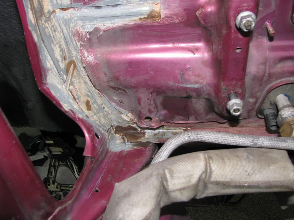

This is what I was trying to show and describe in my tear down on how the leak is not in the cowl as we always thought. The only place the cowl can leak is the fresh air vent if thats not properly sealed. Everything else is at the base of firewall where it mates with the floor pan, the seam in the cowl is an exterior seam and if you seal inside that area all your doing is directing the water toward the drain flappers, Granted yes thats a good thing since the water won't get in between the stamped firewall and the cowl part, but it is not leaking in if that sealant is bad.
I ripped of all the factory firewall sealant and re-sealed it... I'm hoping it fixes any leaks I had and keeps them away.
Right side seam
Left side seam, goes all the way around the booster... I had to re-seal the whole thing and I did have some flakey rust down at the bottom, no holes though.
I also did seal all up in the cowl on the corners and in the middle to direct the water out properly.
