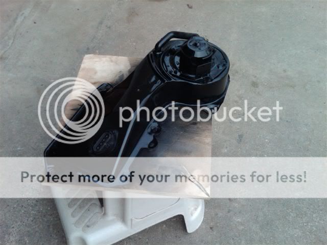

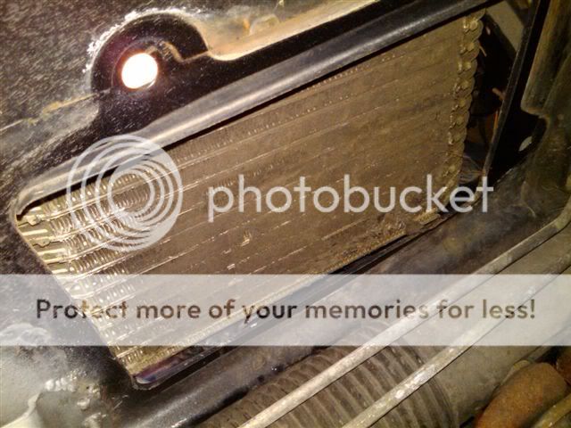

I would put serious money on the intake side of the a/c evap core being plugged. The only way to find out & correct it is to remove the blower motor/fan housing & intake on the engine side. You will find a pic of mine (a 1992) on my photobucket site. Mine was totally plugged with accumulated crap from 20yrs of sucking in debris.
The job is a royal pain the ass, but not impossible. Plus you'll have the chance to finally sand & repaint the housing shiny new black again.
http://i912.photobucket.com/albums/ac32 ... 1-1513.jpg

was it vacuum-able? , or needed a lot of coaxing to come off? probably needs a soaking in some solvent? and would drip all over the inside floor if you washed it in place...
Re: heater blowing weak.
Brush and vac will take it off. Mine wasn't that bad at all... Thank god.
dhenderz
Posts: 128
Joined: Sat Feb 06, 2010 8:11 am
Post by dhenderz »
Soft brush with a shop vac running at the same time so it sucks up what you loosen.

ErichZ26
Posts: 922
Location: Chicago
Post by ErichZ26 »
wow, that one was pretty clogged. Might need to look into a filter of sort
