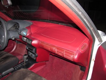

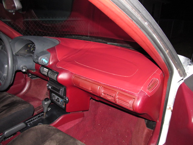

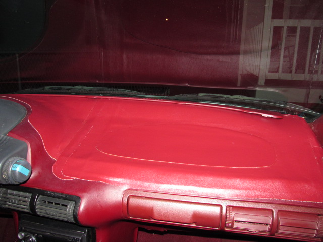

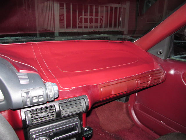

my dash was in horrible shape so i bought a dash cover. while it was ok i thought i would try to recover it myself since none of the upholstery shops would touch it.
30 bux worth of fabric and contact cement later this is what i have.
the flash makes it ALOT more pink than it really is. ALOT. the color is a decently close match but i may try some sort of dye that can be brushed or rubbed on to get it a little closer. i still have rough edges that look white in the pics. i have to find a way to hide those a little better.
what do you guys think? i kind of like it but based on your opinions if it looks retarded i can always throw the velour cover back on.

personally, i'm not a fan, but like you said, the pics make the colour look way different. so maybe with the dye it could be enhanced. in saying that, if you like it, rock it. who cares what anyone else thinks, right? lol

I like the idea and completely understand the reasoning behind it, but i think my issue is that there isn't one continuous edge of the material from where it slopes down from the driver's side (just above the right center vent), all the way along to the passenger side. Not sure if that makes sense.

Well he did ask for our opinions, I don't think just sitting here and saying "it's your car if you like it then its fine" really helps him much... I think he's looking for constructive criticism.
If you want my opinion, the only issue I have with it is the fact that there are multiple overlaying seams and they don't line up with each other or anything really. If you could get the seems to line up with each other and possibly not look so overlapped or stacked then I think it might come together better.

you guys are exactly right. the seams were a pain in the arse. i actually peeled it off and started from scratch 3 times. the dash warp just wouldnt let it lay flat at the slope from driver to passenger side. which of course led to cutting and seaming which then lead to crooked lines etc. anytime i laid the fabric on that slope i ALWAYS got a section that wouldnt lay flat no matter how i cut it. that particular vinyl/faux leather fabric also tended to get air bubbles no matter how carefully i laid it down.
the overlapping i can live with if i can get the color to match a little closer. i may take a couple of day shots just to show the real light. i have roughly a yard left if you add up all the little scraps. i used contact cement but looking at it now i'm not so sure it was the best choice for adhesive. it holds well but is very finicky about sticking until it cures thoroughly.
constructive criticism is always welcome

Cut away the stuff that's warped and cracked, and lay the fabric on the actual dash, so that it doesn't look stupid.
So far all you have done is lay fabric over a turd. It's a fabric covered turd.

i actually did cut away the bad stuff laid down some foam to replace it. it laid just slightly lower than the original dash material. the biggest problem was that there was so much that had to be cut away b/c it was rolling up and away from the dash. the roll started at the windshield and peeled back toward the front.
i probably should have used a spray adhesive instead of contact cement since the fabric was so stretchable. it was super pliable when i put it down and as it dried it sort of shrank and pulled away from the foam underneath. that took away the nice dip on the passenger side. the contact cement is fairly easy to use and comes off without too much work. so i may pull it and try some spray adhesive to see if it has more holding power to prevent air bubbles. the only problem with aerosol is overspray in the car.
