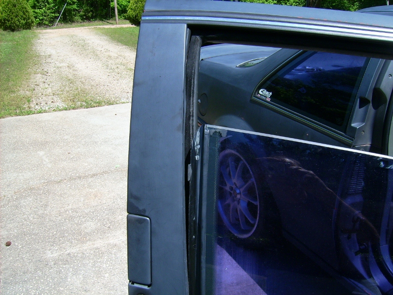

Pic of the window guide

This is what it does when i roll up the window

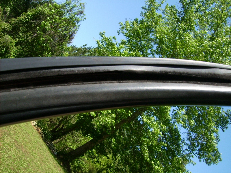

Re: roll-up windows
Post by #1 stunna »
It looks as if the rubber guide piece can just pull out ... kinda hard to see in the pics

SuzukiGhostRider
Posts: 2464
Location: Milan NM
Re: roll-up windows
Post by SuzukiGhostRider »
Like I said..... Did you adjust the channel guides in the door?? It affects how and at what angle the window rolls up and down.

Yes , i adjusted the front guide ...The rear guide is non adjustable from what ive read , their is a pc broken off the rear guide i believe , my main question was how to take the rear channel out ? does it have rivets in it or bolts ? Or does the rubber pc just pull out?

Thanks yall ... I found out today the guide does just pull out ,( pc #5 in diagram) .... but its a pain and hard as hell to get out without tearing up the rubber pcs that are rivieted to the metal guide , I tore up two of em at the j/y :Yahoo!: lol.
Anyone who ever has this problem it May be a good idea just to change the whole door out . It COULD be replaced with alot of time and patience tho.
