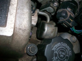

I was wondering if anyone can tell me where the fuel pressure regulator is located on a 1991 3.1? Is it hard to change on your own? Can anyone even point me where

It's near the fuel rail, if I remember right it is made into the line. You should be able to see it from the front of the car. Just look left of the throttle body and to the right of the valve cover.
It's round and has a "+" on it.

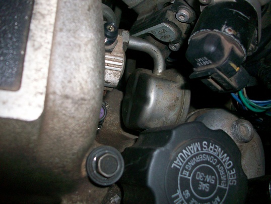

MPB, the fuel pressure regulator is not in the same spot on a 3.1L as it is on a 3100
This is what it looks like
its under the upper intake in the center

Thanks, yeah now I remember that. So what is that thing with the "+" on it? I didn't do any intake work on my old 3.1. Which I now find strange because the engine had 213K on it.

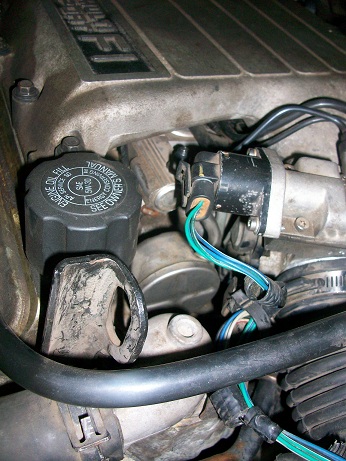

The thing with the + is a round thing just to the right of the FPR and I think both fuel lines run by/to it. It is goldish or silver. I took a pic but i can't upload it. I'll try to make it smaller.

Honestly I have no idea what that thing is called. I thought that's what you meant when you posted about it but I don't have one on my car and I can't find any listing anywhere on what it could possibly be called.
Only thing I could think of is the Pulsator but that's located in the tank just after the pump.

I've only seen those things on 2.8/3.1's. Glad that I never needed to replace what ever it is(LOL).
That FPR is like the TPI ones if I remember right(and it looks like most of the time I don't). So don't quote me on that.
Could it be some sort of check valve?

I looked at the parts/illustration catalog and it doesn't mention it, but you can see it in the drawings. It is built into the fuel feed line they way it looks.
